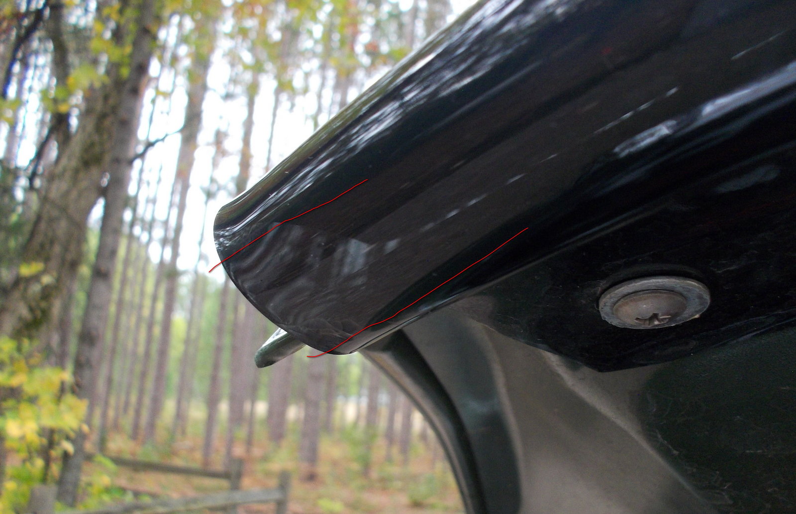

    The AVS one I bought did the same, it sat on the headlights even after adjusting the hood bumpers. So I marked the rub spots and took it off then shaved the plastic off the rub areas with a fresh razor knife.
    That worked! And the areas I shaved off are on the bottom so you can't tell I did it.

    On the fence, mind posting a pic of how much gets ground down?

    Cloudy today so these really didn't turn out very good. In between the red lines I added the bug deflector makes a sharp turn where it curves around the hood. The radius is pretty big and the plastic is thick so you can shave off quite a bit to make clearance. Mine was just hitting the headlights on the very corners of the piece so that is where I carved it off.
    If you use sandpaper or a file you will probably discolor the plastic which will look like crap on the dark tint, but with a razor blade you can't even see where I cut it.
