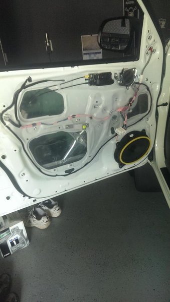

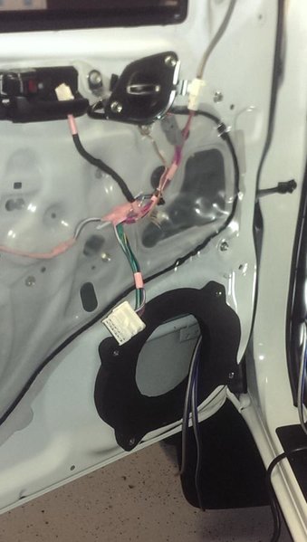

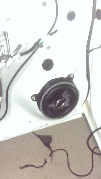

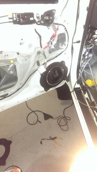

    What's up TacomaWorld I wanted to beef up my stereo system because it blew ball's, but the only thing I didn't want to change was the stock non JBL head unit. I didn't know how I could add an amp or two to the stock head unit, I searched and searched but everything was so incomplete. First you needed to get was a sound processor, good luck with that one, some place's you read people bought some cheap stuff and it worked great for THEM, and when I say cheap I mean cheap like $10-$20 for a processor...:confused: While they where trying to push $200- or more 6 1/2 component sets! Well to keep this short and precise I ended up buying an Audison Bit 10 for the processor front speaker's are Hertz HSK 165xl and Hertz HCX 165 for the rear, I already had an Alpine PDX 4-150 and Alpine MRV-500 mono amps.
    Now I got all my part's in how do I wire them up, what are the OEM speaker color's? Looked around for wiring diagrams and that was a bitch to, finally when I did find something it had the constant +12v wire wrong, or maybe in my 2015 it's a white wire with a blue stripe on the same harness that you'll find some of the speaker wire's. All you have to do is remember that the speakers are on 2 separate plug's or harness's, easy to find, I'll post all needed stuff in the bottom, I also got the stealth box from JL audio the one with the single 10'. As I come to find out it doesn't fit well kind of before I tried installing it I found someone who had the same problem, don't know what he did but what I did was pushed down while putting some of my weight on it and it went in perfect well almost, but it did fit where it was supposed to, don't be afraid to push it down really hard with all your weight to get it to fit in, no cutting needed. All in all I'm really glad I did it, well worth it. I hope some of this info help's you guys out. Now I just finished up everything including putting back all the door panels and many other panel's where they belong its time to adjust the system, unfortunately it's going to have to wait another day because I'm beat, but it still sounded good with no adjustments and I'm not even joking, can't wait to fine tune it.. Oh I also made my own speaker mount's, I used one of the speakers from the front door for the outline, you would need to do some cutting and breaking, and then I got some 3/4 thick MDF board and cut them out, same with the tweeters but I used a 1/2 fiber glass sheet then I painted them with some black spray paint, and for the back doors i just used the old speaker mount it self, I just ripped out the old speaker and then I screwed the speaker to it held pretty well. I also put some weather stripping behind the speaker mount around the speaker hole on the door and the speaker it self.
    Speaker Wire Colors for stock radio non JBL with Navigation.
    12v - white w/ blue stripe
    Ground - Brown
    Ignition - gray skinny wire
    Speakers
    FL Pink + Purple -
    FR Green + Blue -
    RL Black + Yellow -
    RR Red + White -
    Stock
    Speaker mounts
    Completed
    Rear Door
    Jl StealthBox
    Some insulated speaker wire 2 sets each total of 4 speaker in one line
    Radio Harness

    A system made up of components that nice deserves some sound deadening. Also, consider soldering your connections behind the radio. T-taps are pretty ghetto for something this high end.

    I would have soldered it but I was tired of not being able to use my truck, having door panels off and stuff. plus it's easy to go back and do some touch ups like that, Thanks for the tip by the way, when I got to the radio in the end I just wanted to finish so I can drive it:D, and as for the deadening goes, I did it to my last truck, and I swore i would never do it again, it may make a little more solid sound but the way Im looking at it right now is , if I can't remove it then it's not going on, plus all that weight, thought about the thins ones though for the back but the doors I'm not touching. I hope!:eek:
