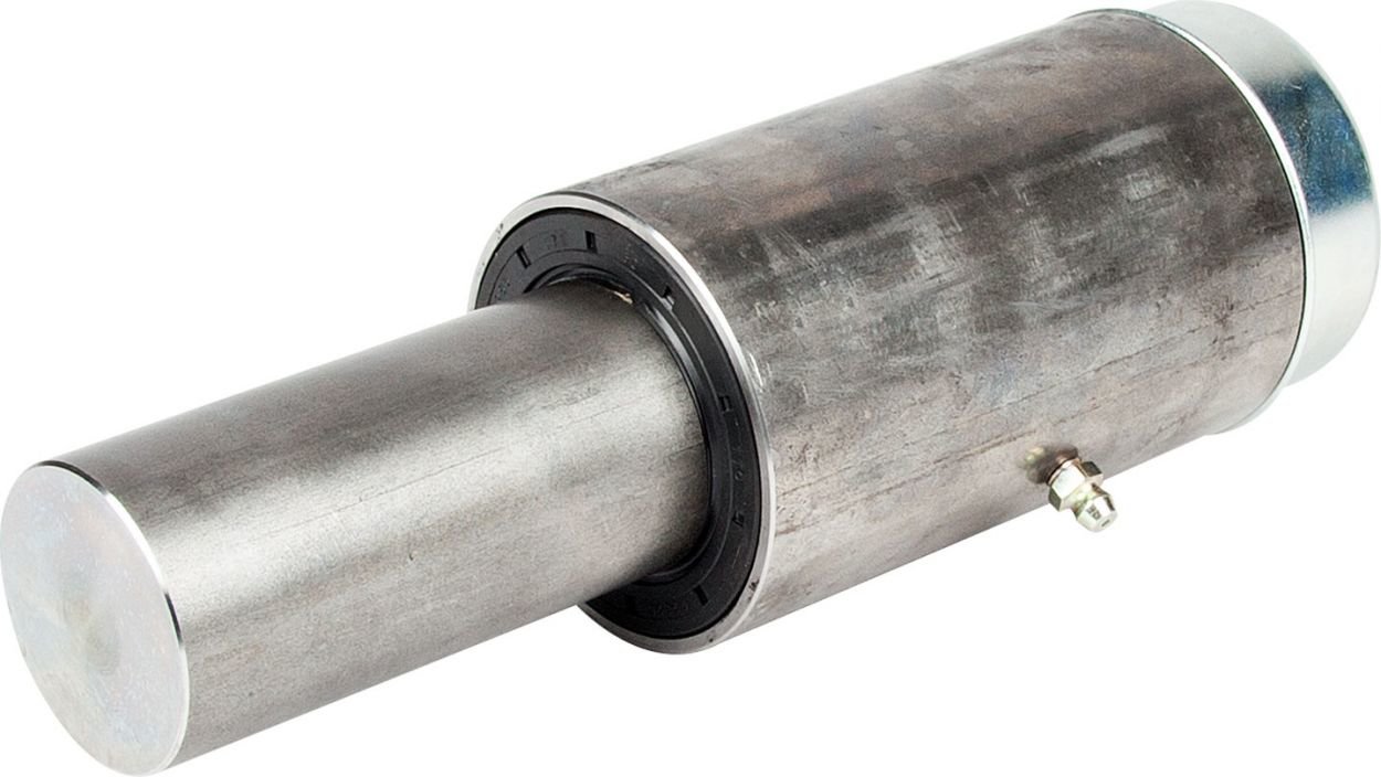

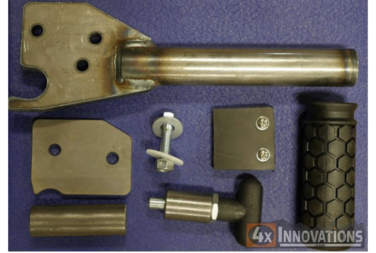

    Hey guys so I’m building a rear swing out bumper with my fabricator friend at work. So far I have...
    the really beefy spindle that trail gear sells
    1 inch clevis for d rings
    4xinnovations latch system
    4xinnovations tire mount plate and gusset
    And the fold down table by front runner will be coming soon
    Im planning on mounting a scepter style gas can on the back, the trasharoo will probably mount to the spare tire, and maybe some other things.
    what would u guys do? I’m a first time rear swing out owner so trying to get opinions, tips, ideas before I start welding shit together lol. Thanks in advance

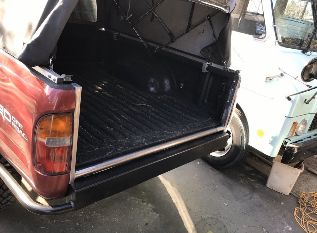

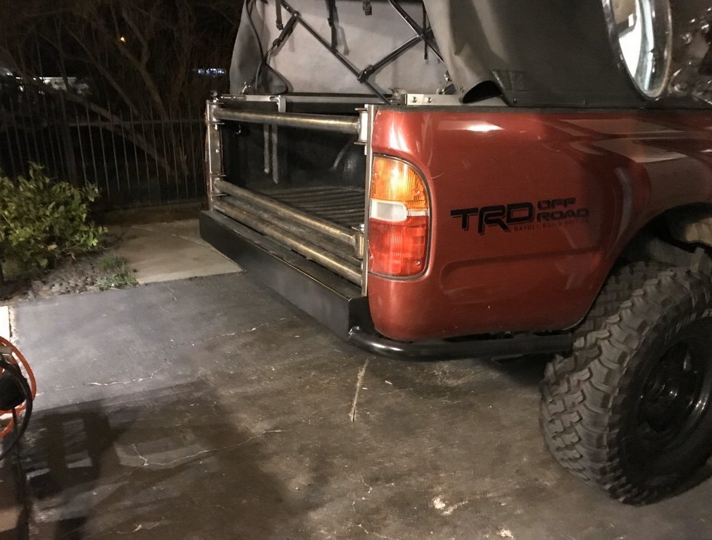

    *Found the post*
    Wilco supplies a bushing for the bottom mount; found out you use your existing tailgate screw for the bottom one hole.
    Where it mounts up in the bed; a bracket is provided to sit against this part of the bed and is sandwiched between the uprights.
    First upright mounted, but loosely. You'll see part of the tube protrude at the bottom. This is the same on both sides, but how do you fit the tube over both uprights and tightening the left side bottom bolt?
    Mount the other bushing against the bed. This way, you can slide the tube over the already installed upright, and slide the other upright through the tube.
    Takes a little bit of manipulation, but the center tube that connects both uprights needs to be centered over the mounting holes. Once you get that lined up, the rest is easy.

    I'd avoid doing a spindle and do a double sheer bracket with a brass bushing instead.
    Spindle setups have been known to break with weight and repeated bouncing off road

    yeah having some engineering background I do understand the issues with a spindle set up. Hopefully I can minimize the stress if I build it right and using the biggest spindle I could find lol. I could still change styles however a friend of mind has a swing out on a first gen and he wheels his truck pretty hard. Had the same spindle I bought for quite some time and has no issues yet.
    Thanks for the tip though I may use it. :thumbsup:

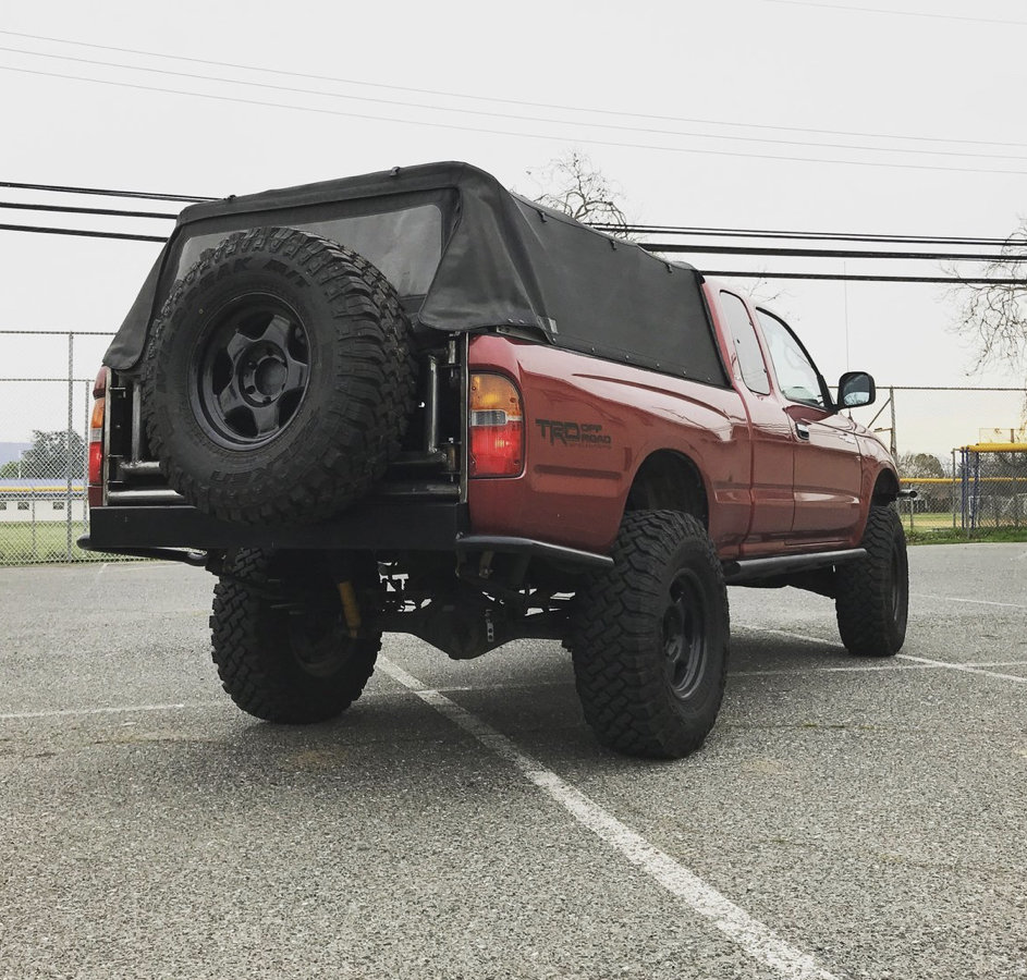

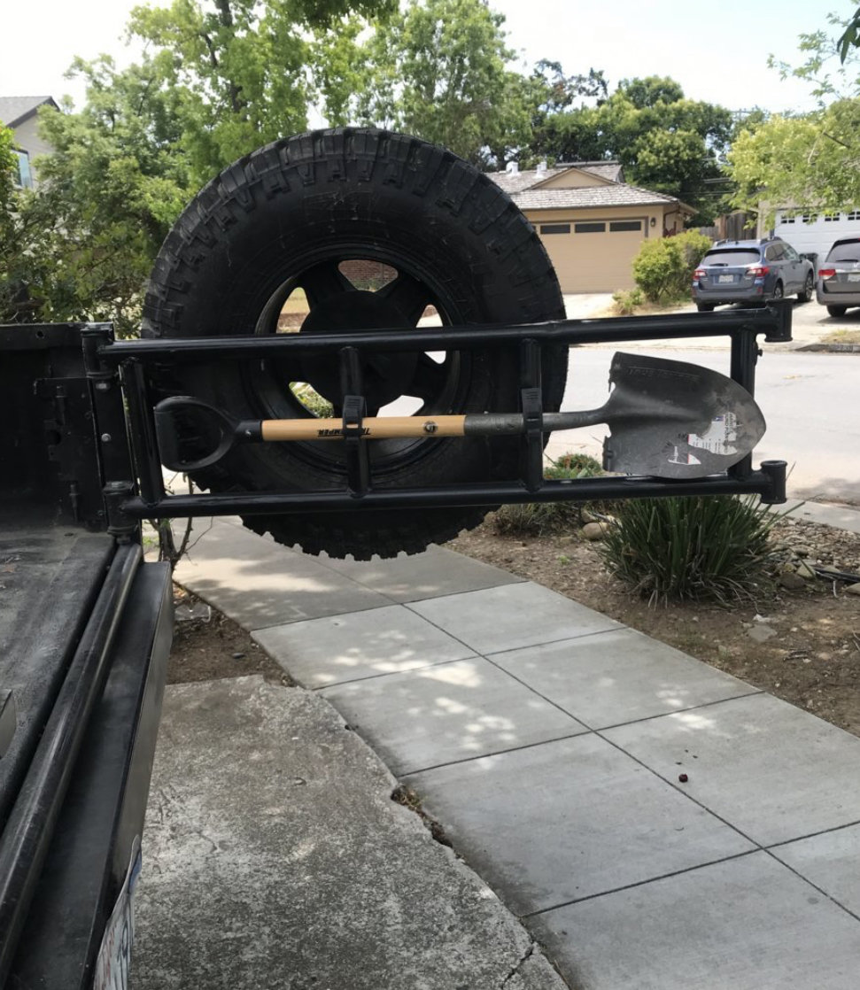

    Don’t have any good detailed pics but rectangular and circular tubing. There’s that bolting location (where stock tail gates pivot) I was able to leave the bottom of the tubing open ended and slotted to accept hardware. So each side have 4 factory bolt locations. Gate is mounted at 4 points with polyurethane Bushings with a slight interference fit.

    Nice, I follow you as well. So the deflection when you open is due to the 3/16 plate for sure. The gate itself along with the tire, creates a large moment on the pivot side. You need a strong frame to withstand the stresses.
    To help reduce the moment move the tire as close as you can to the pivoting side. You could try large gusseting the 3/16. But I would recommend going with tube.
    Edit: you could look at inter-grating it with your bumper.
