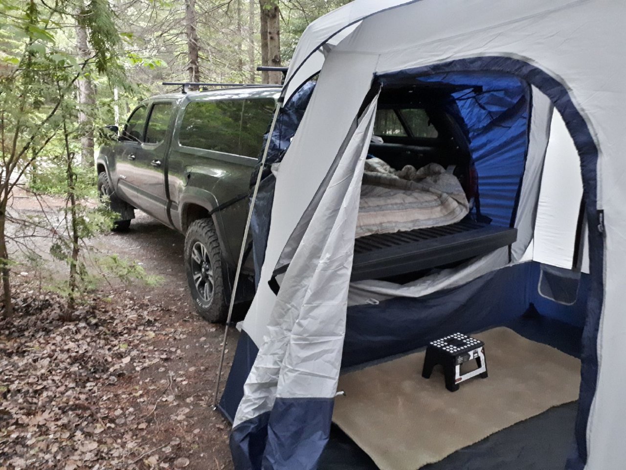

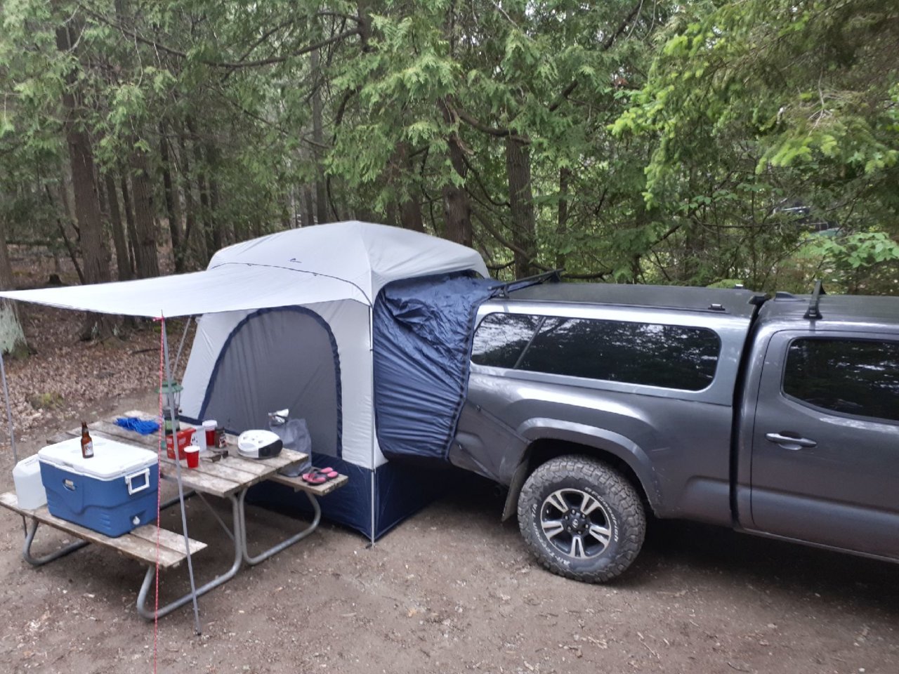

    The napier suv/van tents work perfectly with our trucks btwResized_20170604_200847001_6555.jpg Resized_20170604_203402001_8559.jpg

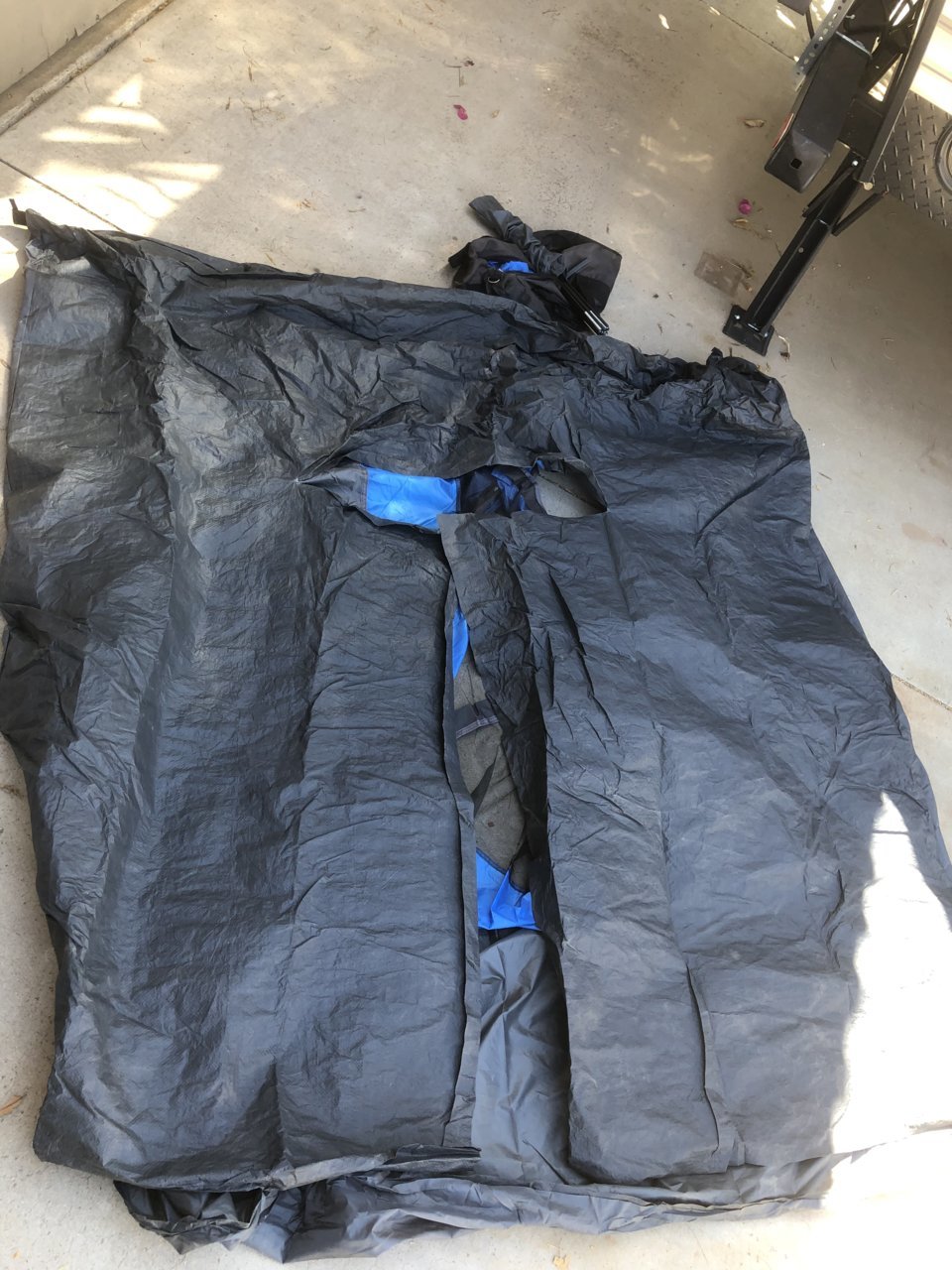

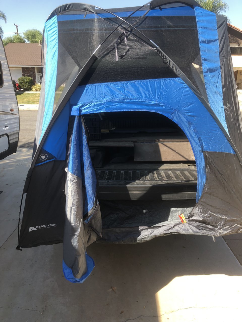

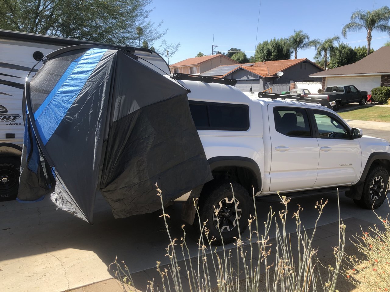

    Here’s our cheapo $30 modified one complete with zippered door and mosquito netted vents for the rear of the cab by modifying a 3-person $30 Walmart dome tent- just by cutting a big T on the floor:

    Hey all, sorry its so late in responding. I just updated with tent pics- see Post #23
    I am using the RTT a lot and the
    Platform gets used for gear mostly. We keep our expensive stuff out of sight in the roller boxes underneath. Had a couple weekends where we slept below due to high winds and lightning (no way Im sleeping in a RTT during a lightning storm, being surrounded by metal is much safer!
    The modified add on tent looks bad, as if I backed into the next campsite and drove away with their tent stuck on me, but it works great for its mosquito netting, water resistance and for better privacy. And it was $30 new!

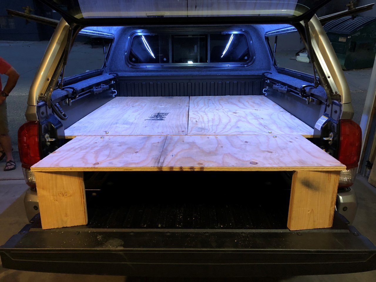

    I made a similar extension setup for my DCSB

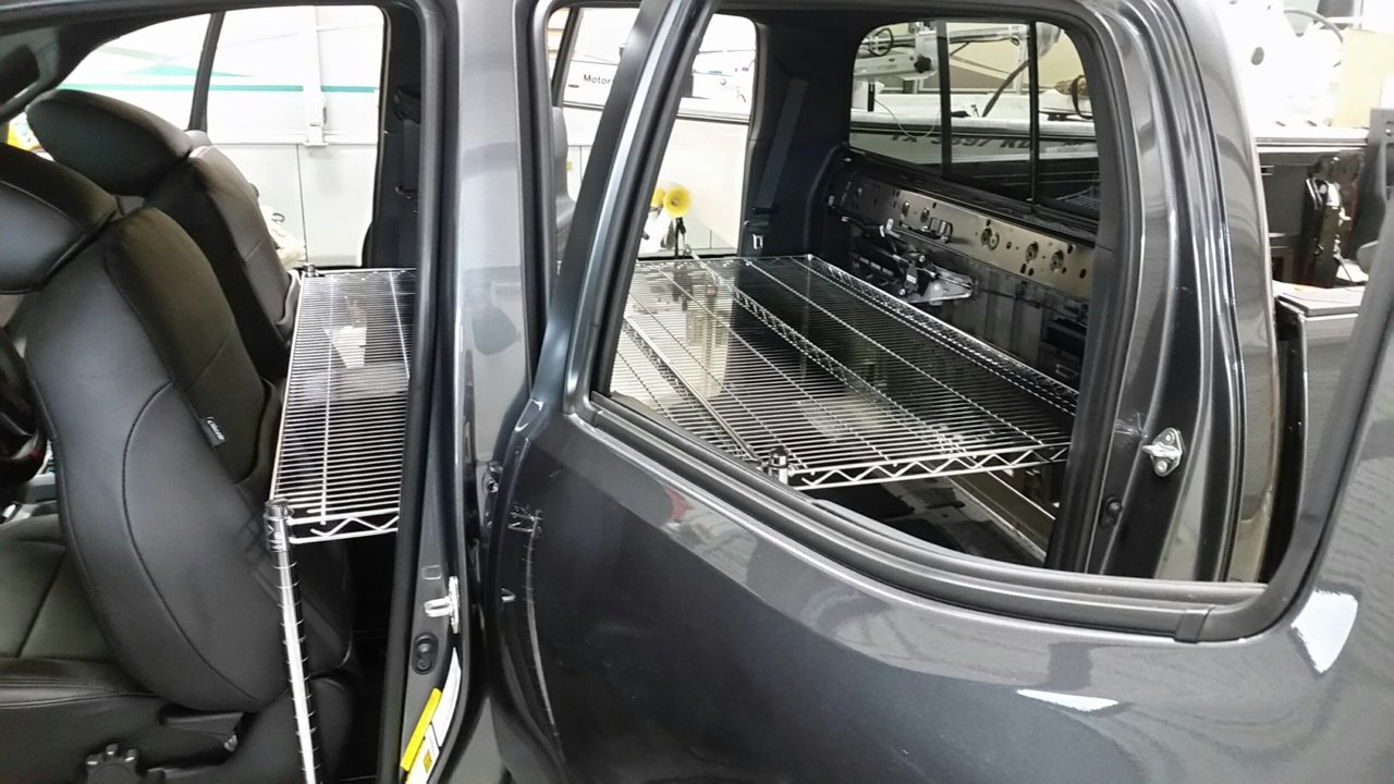

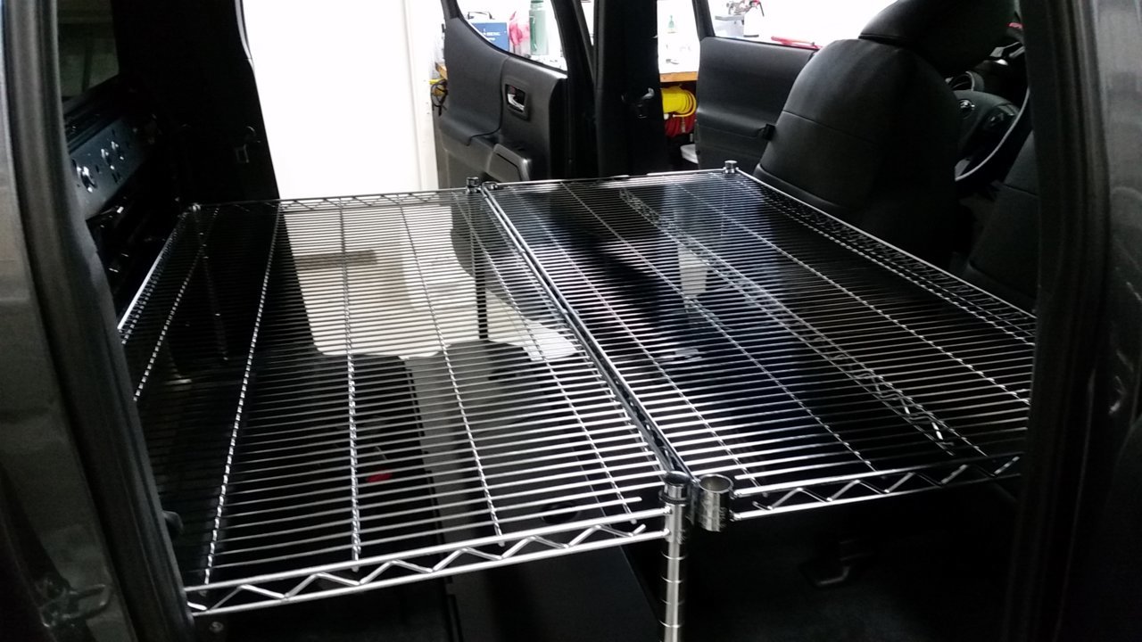

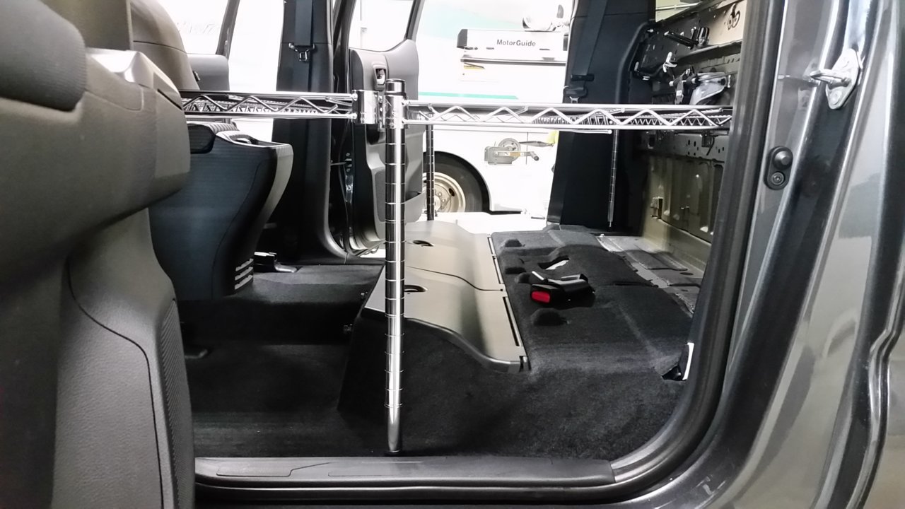

    Guys you can do this with wire shelving and then it is adjustable. I bought the shelves to do my SB rear platform, but decided to move mine up front into the cab in a rear seat delete configuration. Reason in doing so was that way I could put a window A/C on an elevated 24x48 wire shelf in the back, blow it through the rear window and sleep under A/C up front. If I remember right you'll need two 24x36 shelves longitudinally beside each other in the front of the bed and a 24x48 across the back of the bed to make a platform in a SB, or three 24x48 shelves to do it in a LB.
    Best part, use them at home to put stuff on when you are not camping! Get 4 72" posts and you have a shelving system, or just use them on the short 18" posts and have three separate shelves.
    20181221 - Cab sleeping platform, 48W x 54L, (two 24x54 Metro Wire shelves), driver's side.jpg
    20181221 - Cab sleeping platform, 48W x 54L, (two 24x54 Metro Wire shelves).jpg
    20181221 - Cab sleeping platform, 18 inch floorboard storage, 13 inch storage behind floorboard.jpg
