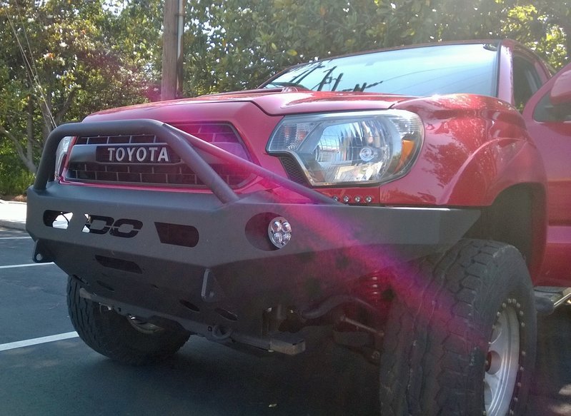

    As the pile of parts grow I realize i have a problem..
    It all started with an 1988 Ford Ranger lifted 4" and cut up the fenders, then moved to a 1991 Toyota xtra cab, got hit by snow plow, so of course I needed Fiberglass bedsides and fenders, a long-travel suspension and more motor mods than I could count, headed to a 2000 Dodge Dakota lifted with a hemi swap.. blew the motor so back to Toyota..
    2013 TRD sport DC 4WD.. WP_20160527_001.jpg ranger.jpg toy in snow.jpg all 002.jpg WP_20131022_003.jpg

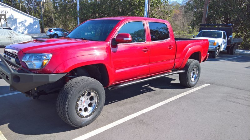

    got the wheels, now for the fine tuning, maybe some cutting and coil adjustments, small cuts now, I did big cuts in the past.. and maybe in the future but right now its a new truck.. so i should slow down.

    I told them was looking for more castor, and I got it.
    it seems to drive great, so we will see

    It looks like I will have to trim alittle.

    285 70 r17
    just a hair of rubbing on the body mount at full lock

    How much Lift did you end up with ....Cuz you got real lucky with hardly any rubbing with the 2.5"s, and those shoes..!!..

    Its a good 3" and a hair up from stock, I put a 3/4" spacer on top of the coilovers to keep the spring rate where I wanted. I did already cut the inner fender and some of the flare, beat back the pinch weld, by hardly any rubbing I mean on the body mount... the part I was not wanting to cut, but the more I read on the reason for the mount and its location I feel if i just dont get too out of hand it sould turn out great. I'll post a pic of the rub area later.
