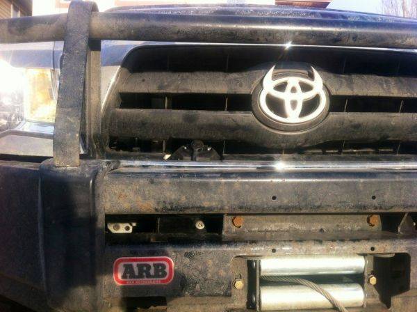

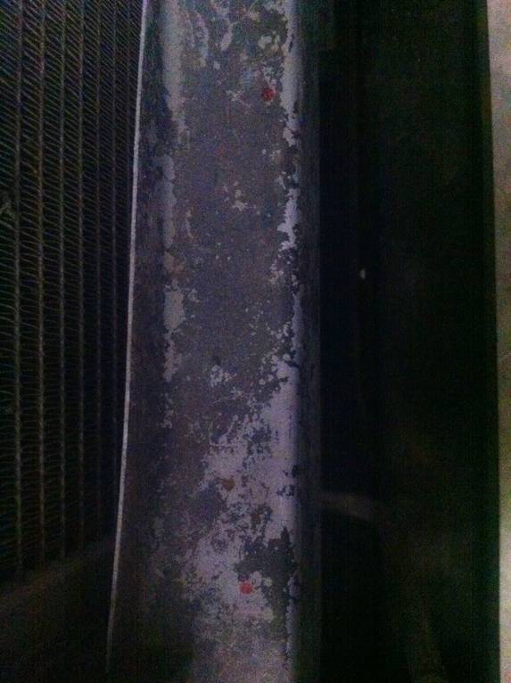

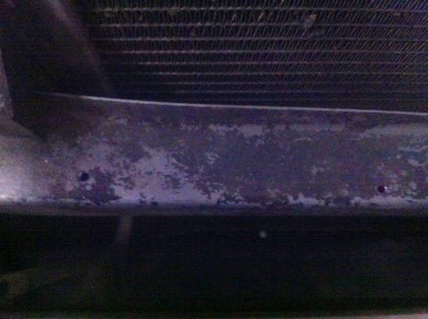

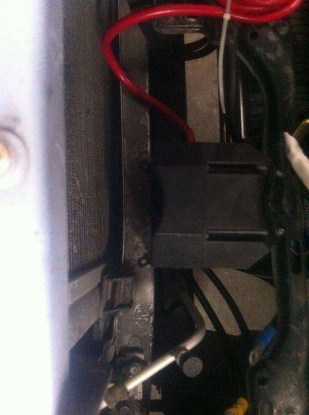

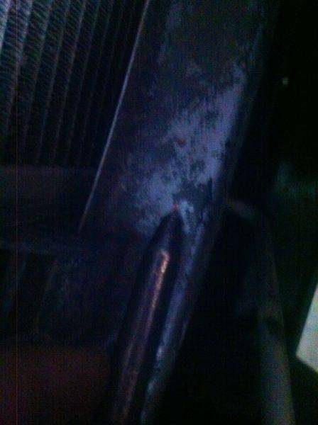

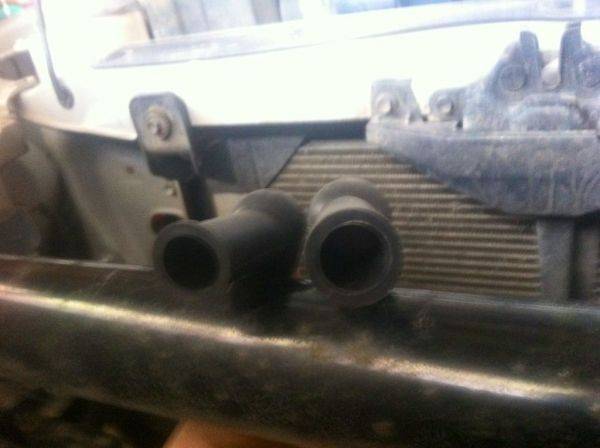

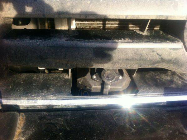

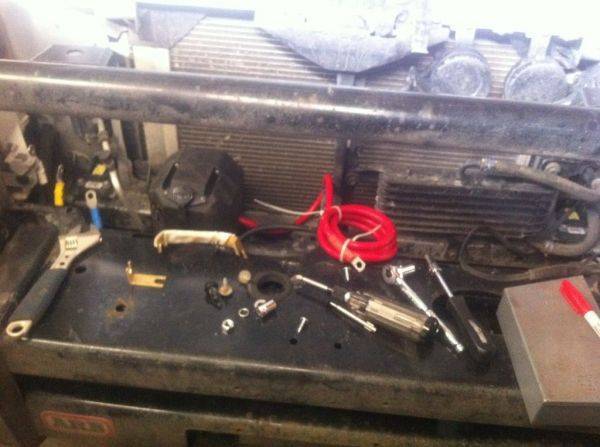

    Installing a Superwinch control box with an ARB on a 2007 Tacoma.
    I don't believe anyone has done this before, cause after many hours of searching the internet I found sweet fuck all.
    First, remove the grill cause it won't fit other wise.
    Place control box where you want it. I used the Superwinch Relocation kit ($50) for this. I placed it near the right headlight on the cross beam.
    Dear All Pro, Relentless etc Owners...sorry...you'll have to find a bench or table to put your tools on. :p
    Mark where the holes are. I used a red Sharpie for this.
    Centre punch the middle of the marks so you won't have the drill go squirrely on you when you go to make the holes.
    Make it so.
    Place and secure box. I'm thinking I might do something extra to hold the box because I don't want it vibrating every which way when I drive.
    Hack a hole in your grill. If you're putting a winch on your truck chances are you've either A) banged the shit out of it already or B) you plan to, ergo this shouldn't be a problem. I used a hack saw and just broke the piece off and filed it down.
    Reasonably sheltered from the elements while still being accessible in a pinch. Damn near looks factory if I do say so myself.
    Don't forget to top up your transmission...
    ...and mount your mini cannons for deer season.
    Enjoy your favourite 80 proof adult beverage of choice for a job well done.
    PS - Yes the winch works; yes I know the vertical rollers aren't on yet; no the truck didn't explode.
    PPS - You just went back to check about the vertical rollers...sucker.

    Cheers Mang. It was a real bitch to find a suitable place to mount the control box.
    It was on a whim that I was like "Hey...you can go there you little fucker."
    The only thing left to do is drill the vertical rollers, cause if I put them on and secure them with the snap ring, I'm going to have to destroy them if I want to replace them. So instead I want to drill them through the center of the top and put a cotter pin in them.
    Took me 3 hours including taking apart the control box, rewiring it, putting it back together, dropping a screw down in the engine bay, taking off the skid plate to retrieve it, putting the skid plate back on, putting the boots on the incorrect wires, taking them off, putting the on the correct wires...
