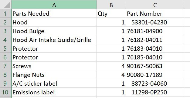

    So, I like the look of the hood scoop, and would trade if someone in the SE Michigan area had a magnetic gray hood w/ scoop they would be willing to trade for a non hooded version, however that seems unlikely.
    So I started poking around and the closest thing I found was Revemoto selling one painted for almost $1950 o_O : https://www.revemoto.com/products/2...h-scoop-conversion-kit?variant=39735369891922 That seems a bit, choke, on the "high" side in my opinion.
    If I was to try and just buy the pieces and have my local shop paint the hood, does this look like I got about everything I need?
    With twice as many bits as I would need, just in case I lose something or mess it up, I'm coming up with about $625 for the parts + the paint job from my local shop. Does this about cover it if I want to do it myself?

    Looks about right to me. I did that very thing and it ended up costing me around $1500 which included installation

    Regardless, msgs350 should be able to confirm your parts list. I think he had a spreadsheet for it.

    Awesome!! I will have to compare a few as the ending numbers between a few of the trim bits on the lists are different.
    This was his final list of what worked for him?

    Yes, I believe so.

    The factory hood comes primered and ready to paint.

    I don’t think it’s “ready to paint”. Your body shop should advise you on any additional prep work that may be needed.
    yup, that’s all I ordered.
    I think I was around $600 for parts and $900 for paint and install. I could have saved that $60 install cost but didn’t want to put a perfectly painted hood in the bed, then need an extra pair (or two) of hands to fuss with it. I pulled up to the shop, got the hood swapped and was headed home in 45 minutes.
