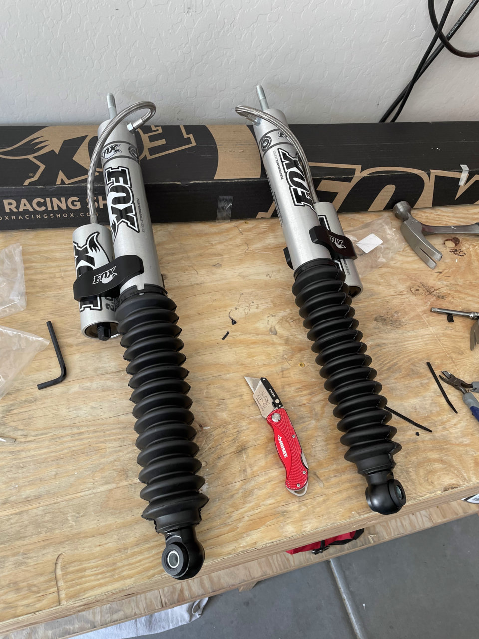

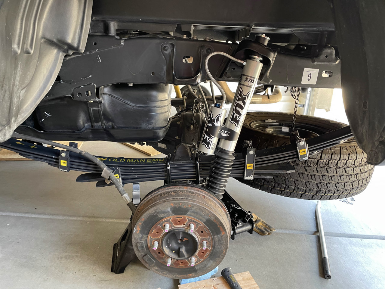

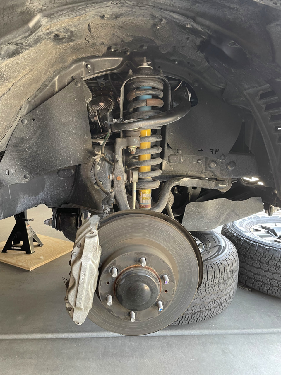

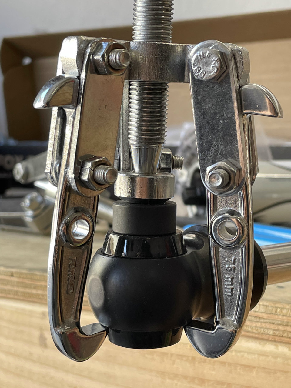

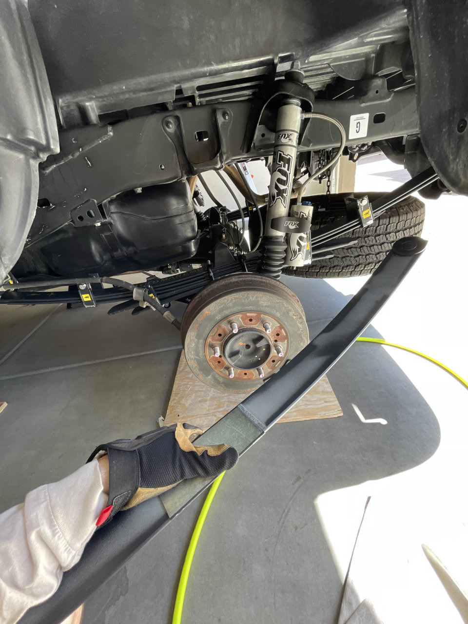

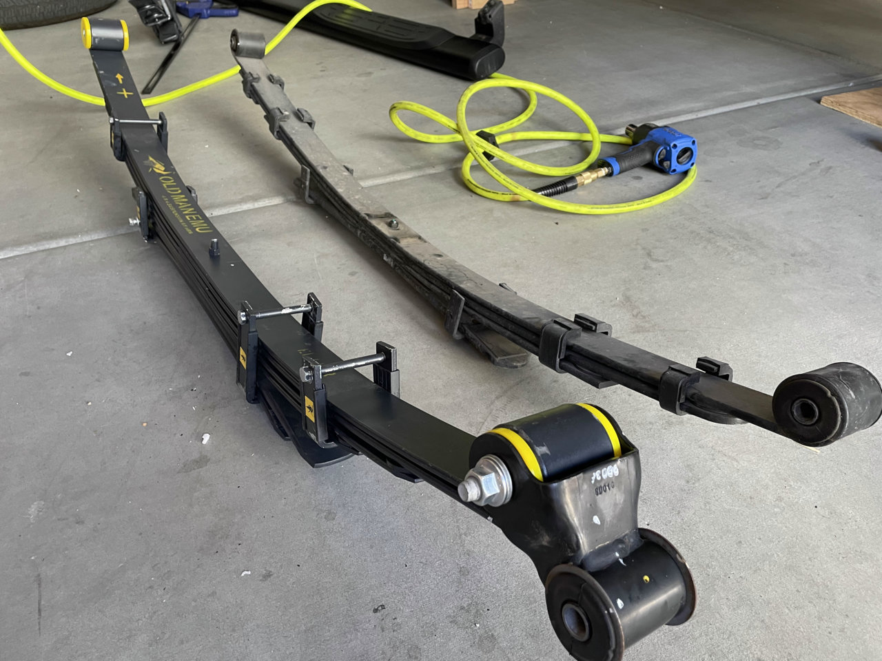

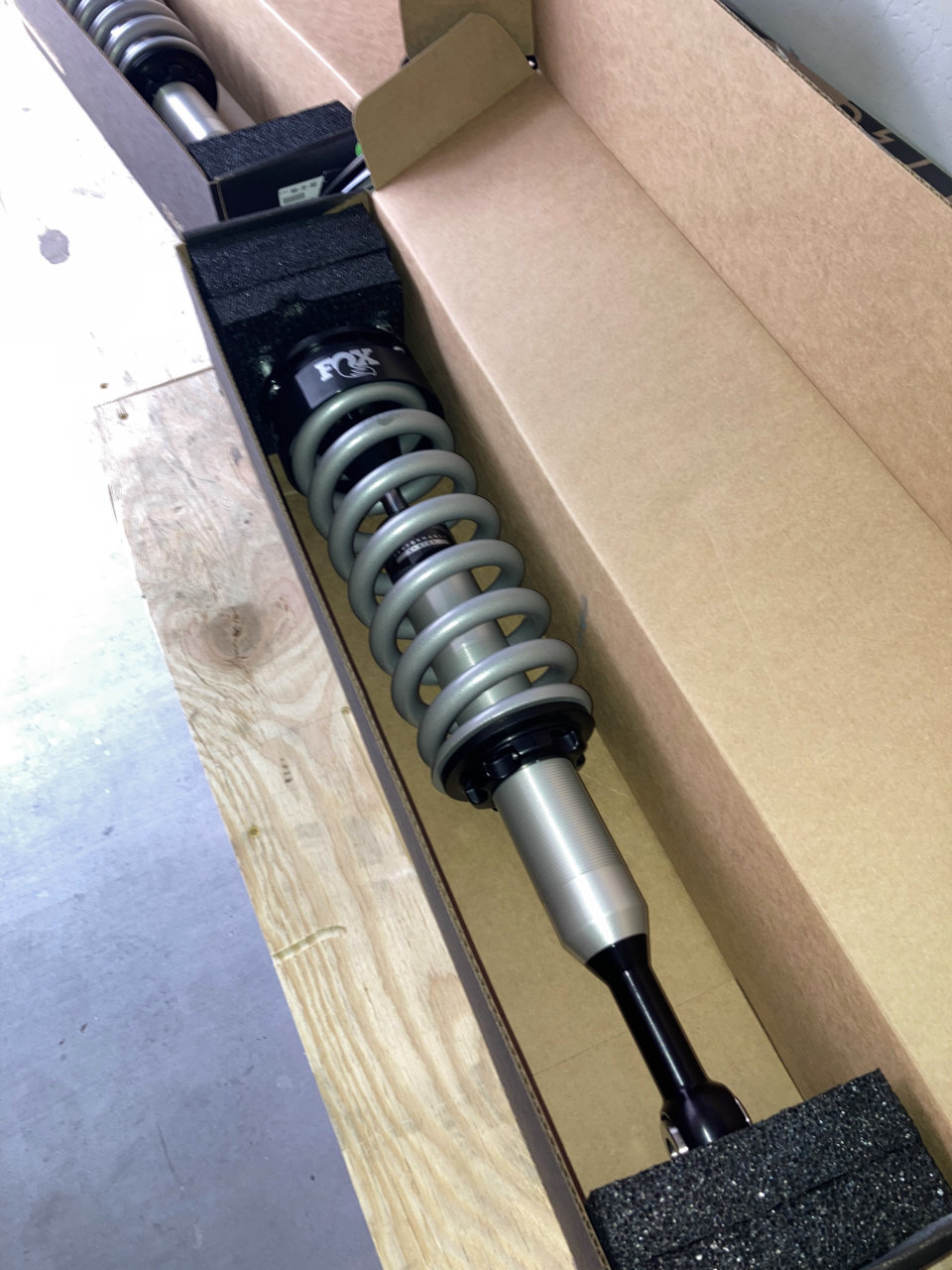

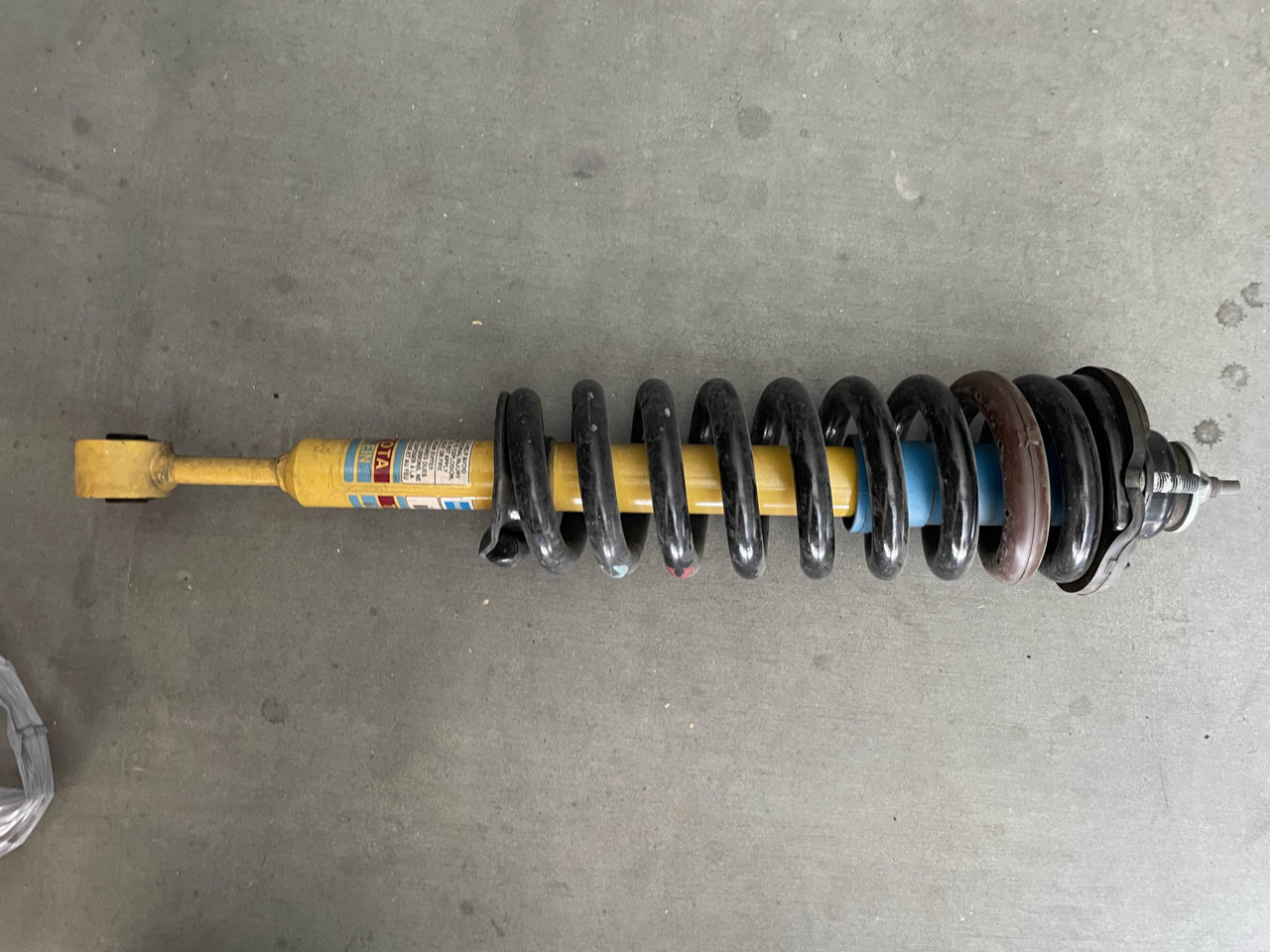

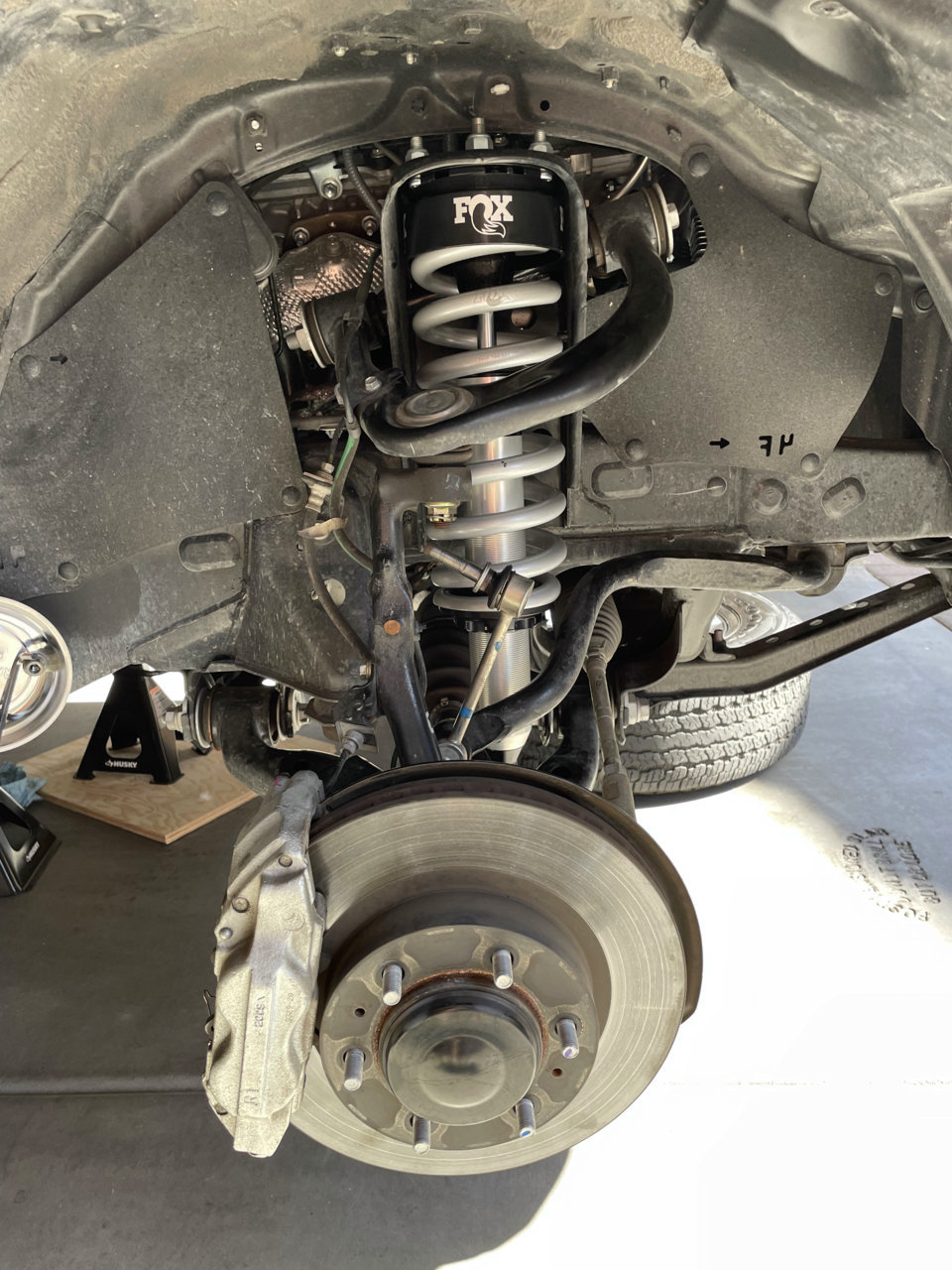

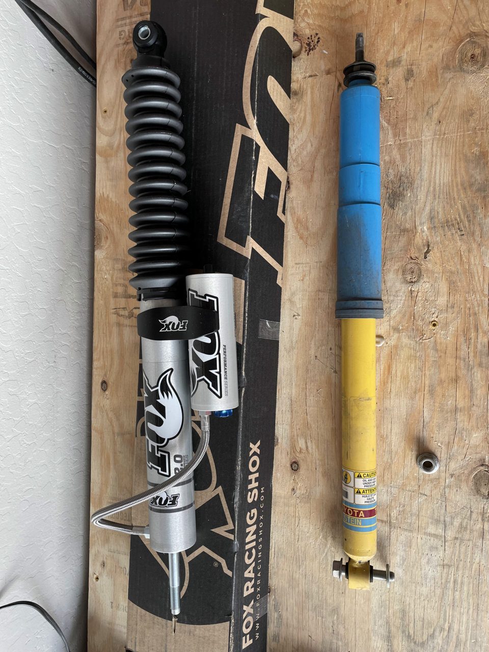

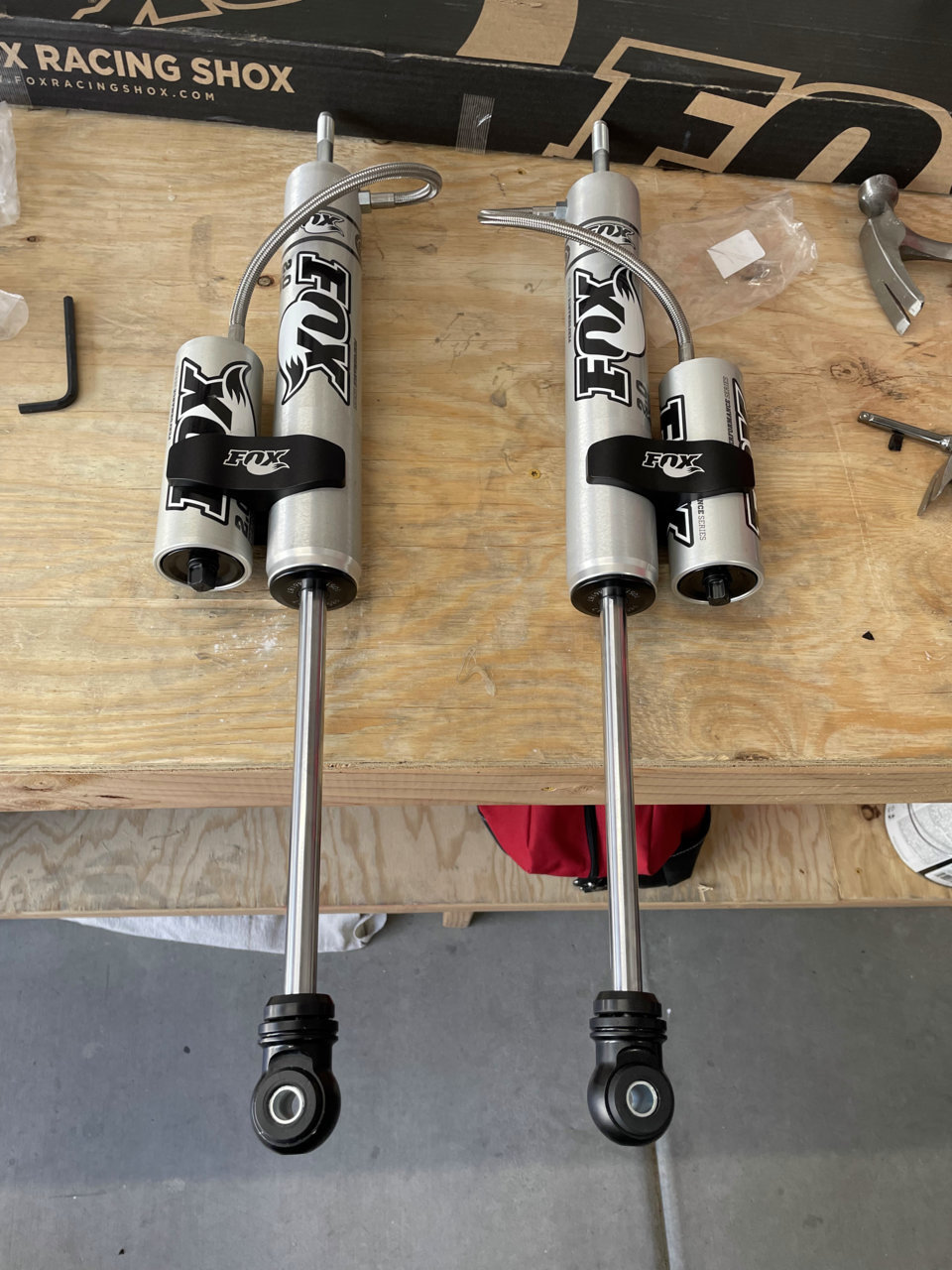

    I got Fox 2.0s Front and Rear and OME Dakar Mediums (i think i kinda regret those but I will talk about that more)
    The installation was fun and was a great excuse to drop hundreds on new tools and a new tool box. I love Lowes needless to say its my toy store. I struggled getting the bushings swapped out with the rear shocks as they come with a larger bushing installed but the proper ones come with the box. I used these clamps from Harbor Freight and some part of a random tool rented from auto zone to pop the wrong bushing out.
    That came out in multiple pieces haha but the new one went in easy with some grease. I prepped them with some boots as well.
    I started the removal of the old parts and put in the new. I have no experience and learned it all on youtube. And it was not that hard. All together I think I spent around $1500 ish on all the suspension parts. I cant remember its been a while and I dont like to think about how much money I would have saved if i kept it stock.
    Out with the old and in with the new.
    Ok, so it went on well and nothing broke. And it looked sweet.
    However there was a shudder when driving slow. And it felt STIFF in the rear. Like alot. I thought this was the ECGS Bushing thing and was not ready to try that fix. But I read on here that the driveshaft geometry was messed up now. Made sense and saw that i should add a shim. So I added a shim. Problem was i needed a way to keep the centering pin from being too short to fit through the shim opening and into the axel. So i took a nut and shaved it down to fit on the centering pin and keep the shim in place while sticking into the axel. It acted like a spacer basically. Wish I had a better pic but it worked.
    I later got a new centering pin with a threaded nut to act as the spacer from a suspension shop. But I wanted this done now and was gonna make it work to prove I did not need the ECGS Bushing.
    It worked. No more shudder. Now the problem is that the shims added like another inch of lift. I had 2" in the rear before but now i had 3 in the rear and 1.5 in the front. So I removed a leaf to lower it. This was also supposed to take out the stiffness and make it a light spring vs the medium rating it had from OME.
    After putting on some new U bolts and that better center pin (And painted the shims black to protect em from rust that was appearing on em) I put the truck back under its own weight. Now the rear was lower than the front. The rear dropped to just under 1.5" of lift from stock. With the shims still on as well. The stiffness was kinda gone but it just left worse. And the rear shocks are rated for 1.5 to 3" of lift so I felt kinda nervous this was bad for them being compressed all the time. Probably not that bad but I put the leaf back on. (with new U bolts for the final time)
    It was what it was. Later I tossed in a hundreds of pounds of weight for a dump run and it felt so good in the rear. (thats what she said) Maybe I will get a Leer shell some day for the rear. So maybe I regret this leaf pack but I did not want to do an AAL to mess up the OEM leafs (I kept all the old suspension parts in the event I sold it and needed to put it back to stock. Or if i just hated the new stuff). Some day also I will get new upper control arms to just get better alignment but its not needed.

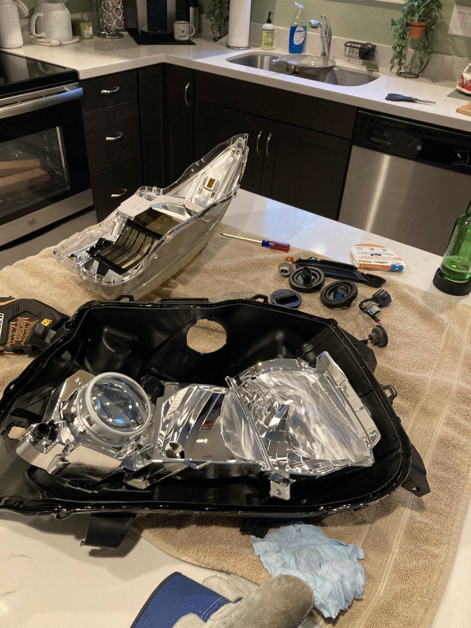

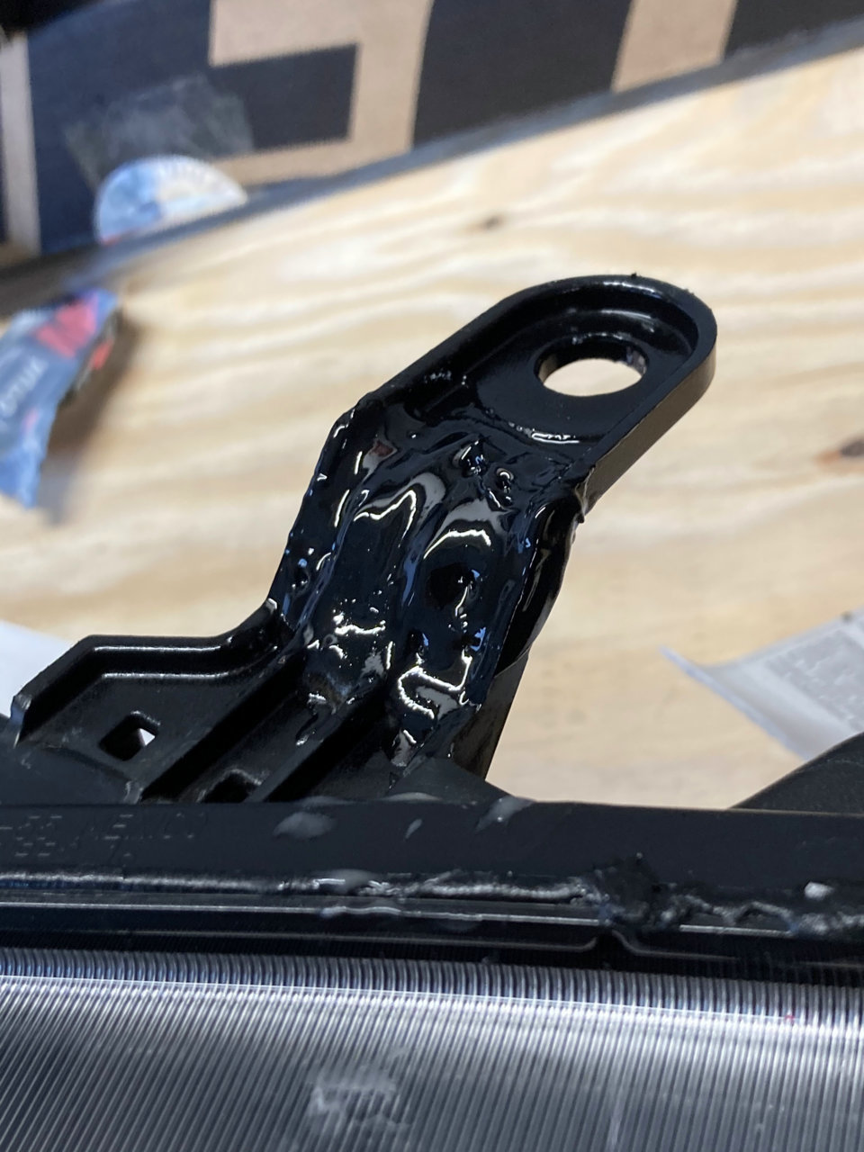

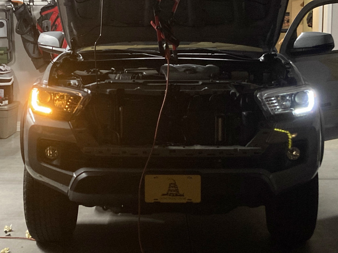

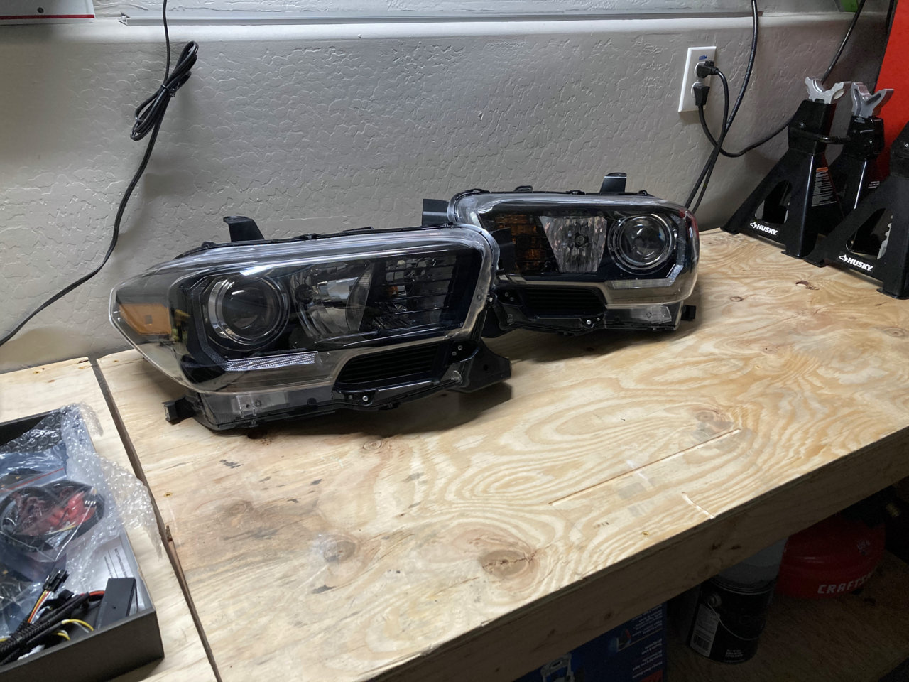

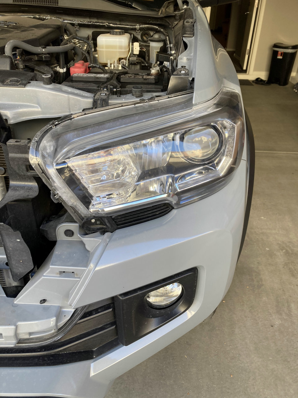

    Next up was the front headlights. That chrome had to go. But I like OEM. So i found a pair of like new TRD Pro lights on ebay for $600 or $900, honestly cant remember. Im gonna say $600 to feel better about myself.

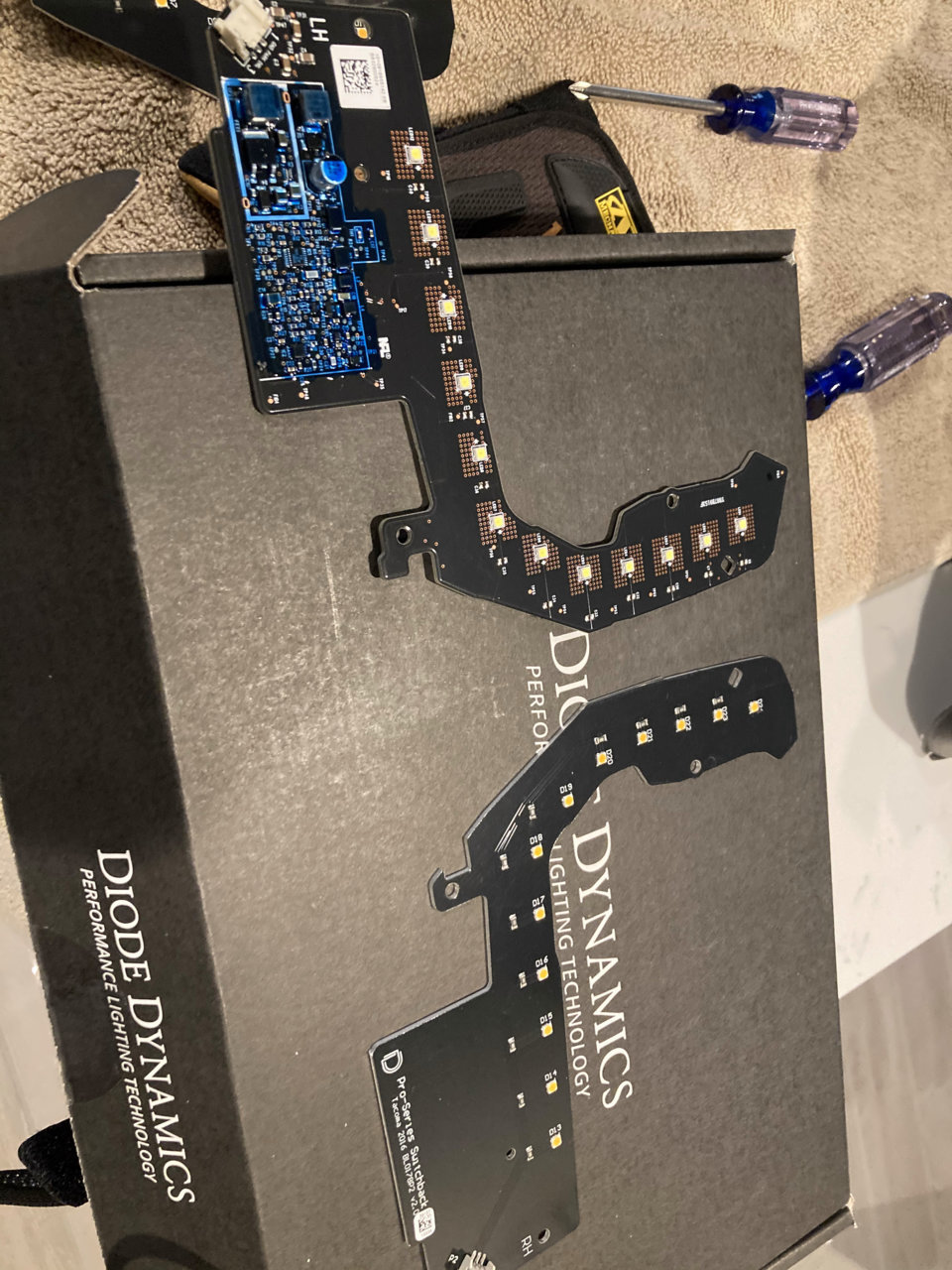

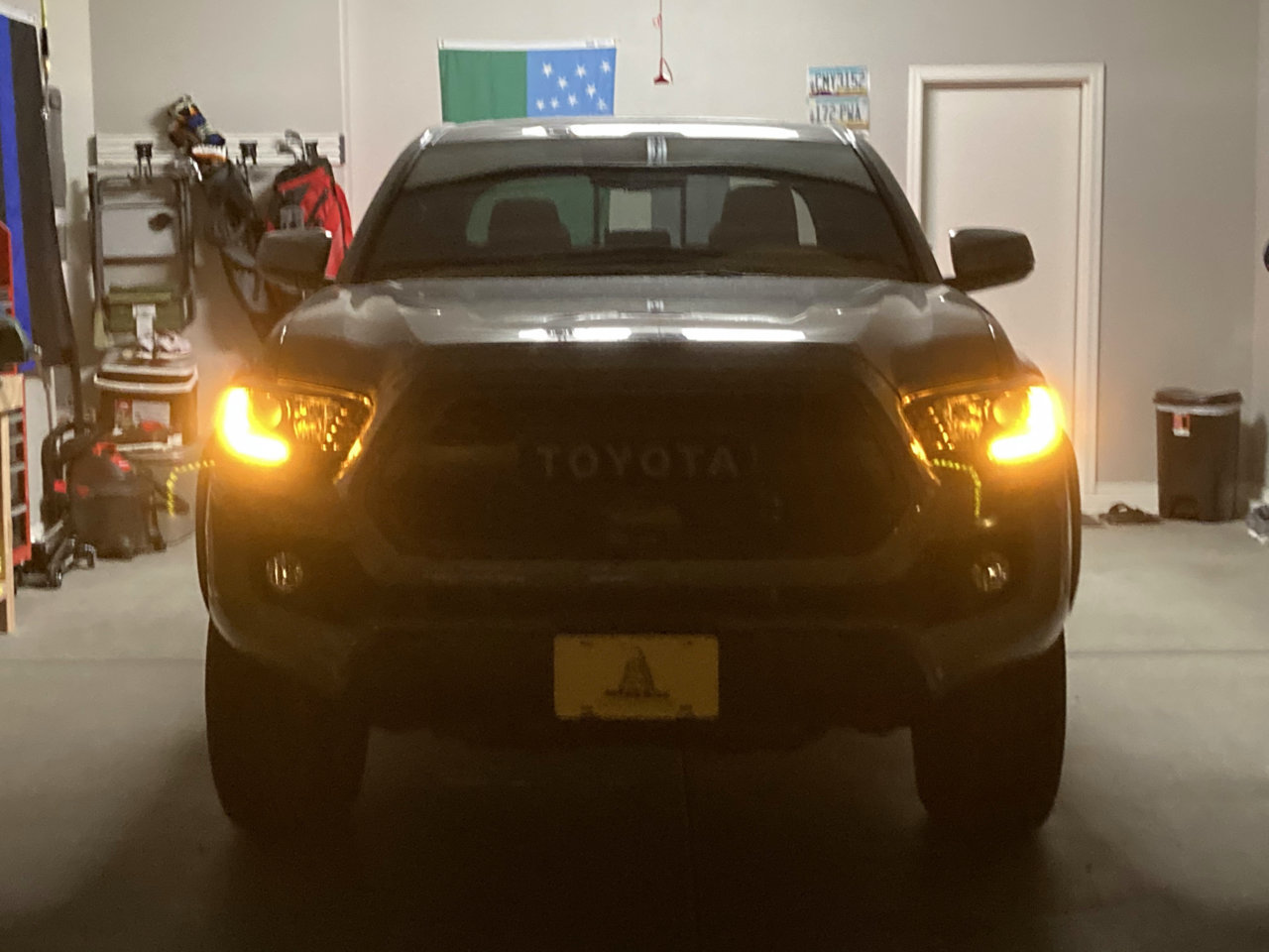

    But I am not gonna just be a TRD Pro wanna be. The white DRL was trash. I have seen maybe one other member on here do the Diode Dynamics led swap. So I went for it with some help from youtube.
    63365909864__514446F2-A7F6-425F-9409-4AF720D6418F.HEIC.jpg 63365873085__231DE95A-D361-40A1-AA74-581B83750C24.HEIC.jpg

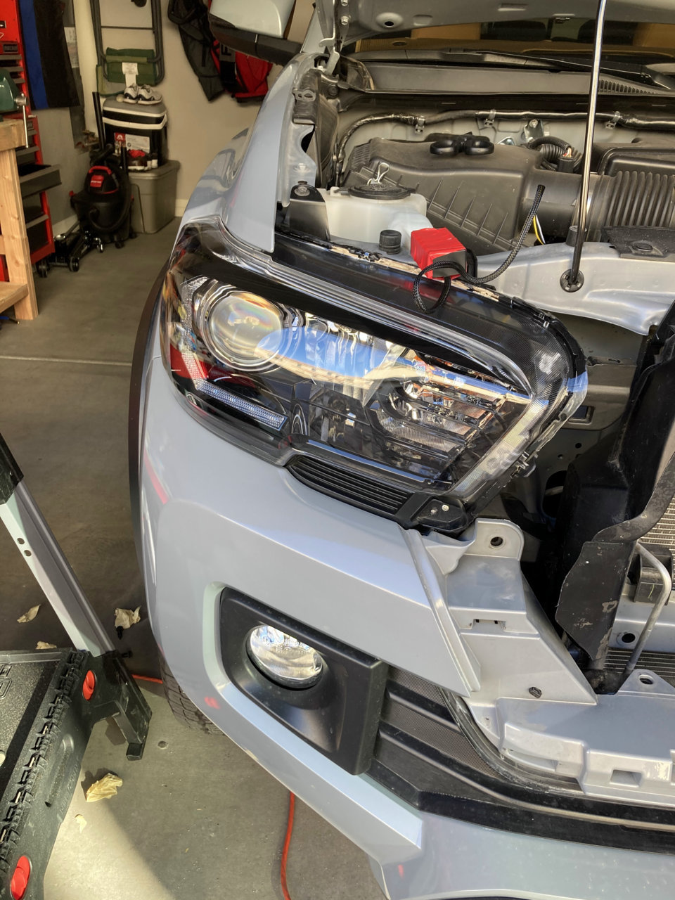

    I had to stick these in the oven to pop em open which made my wife (girl friend at the time) very confused but i didn't break anything. One of the tabs for mounting broke in shipping but JB Weld and some thin strips of metal I made for supports. I painted it black also. It's held for over a year in the AZ heat.

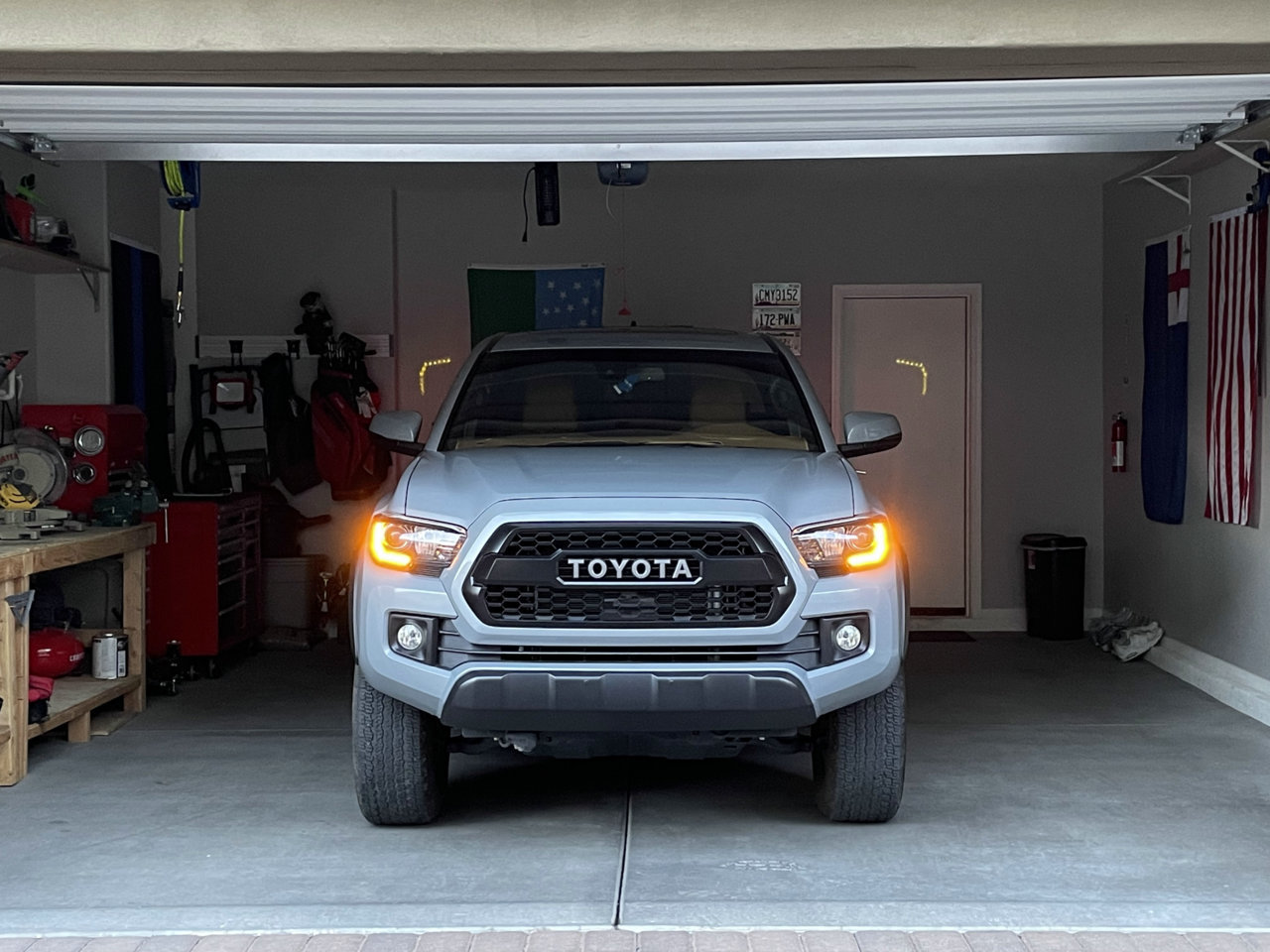

    I put it all together and installed it. What a pain that was. But the payoff!
    OLD:
    New:
    And the comparison!

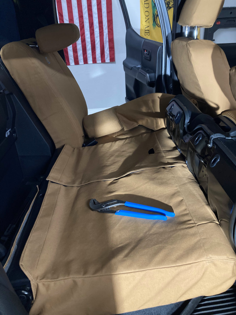

    Ok now its looking good. But now i got the urge to cover up the softex seats with seat covers. Mostly to preserve them as my dads (a 2018) are wearing out and getting glossy and dirty with all the AZ dust. So I went with Carhartts.
    Looks good and my buds roasted me for them haha but It will pay off when I have kids and they get the seats filthy. Also the original seats will stay crisp for years.

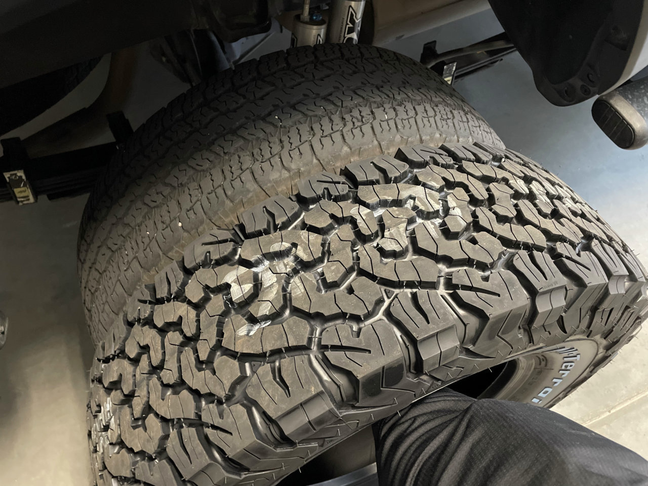

    But ok TIRES
    KO2s I think they are 33" but zoom in and check the tire size or whatever they are bigger than stock tires. God did they look good in the bed and they smelled great.
    And loved that tread pattern.
    Lets take a look. Yeah I love this truck.

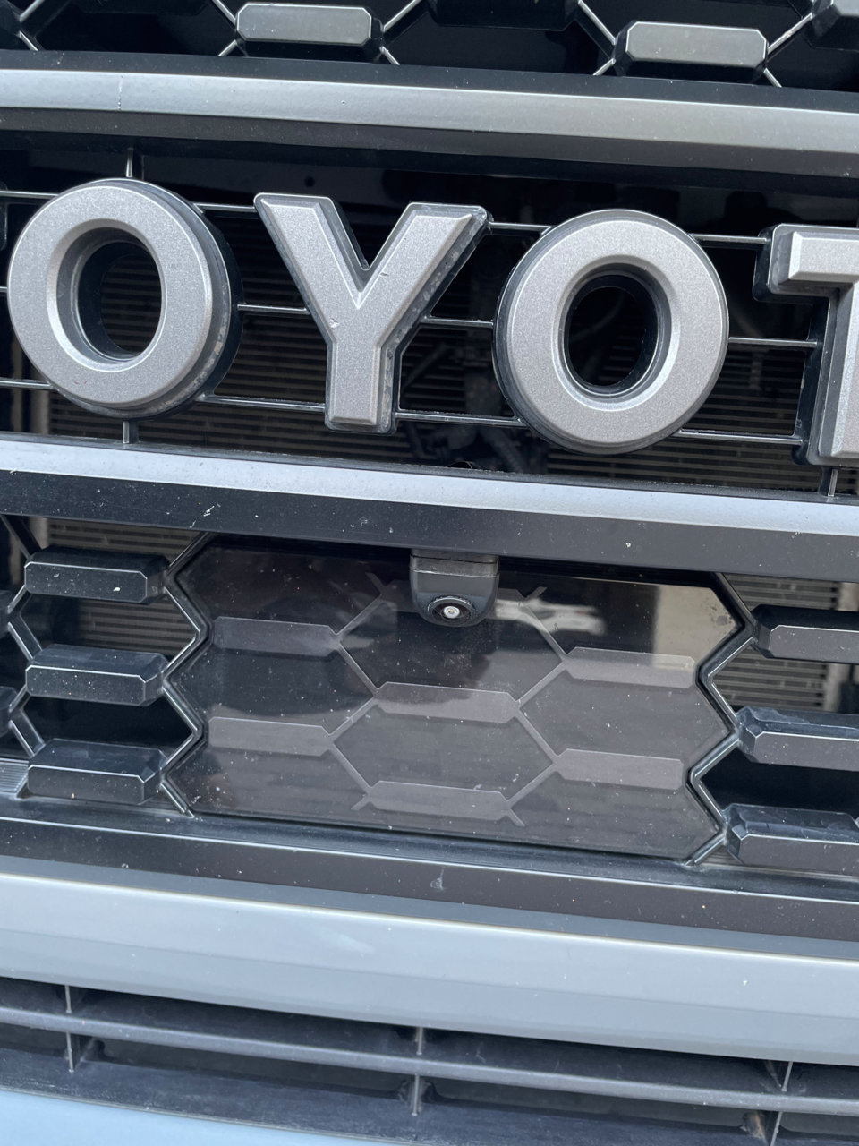

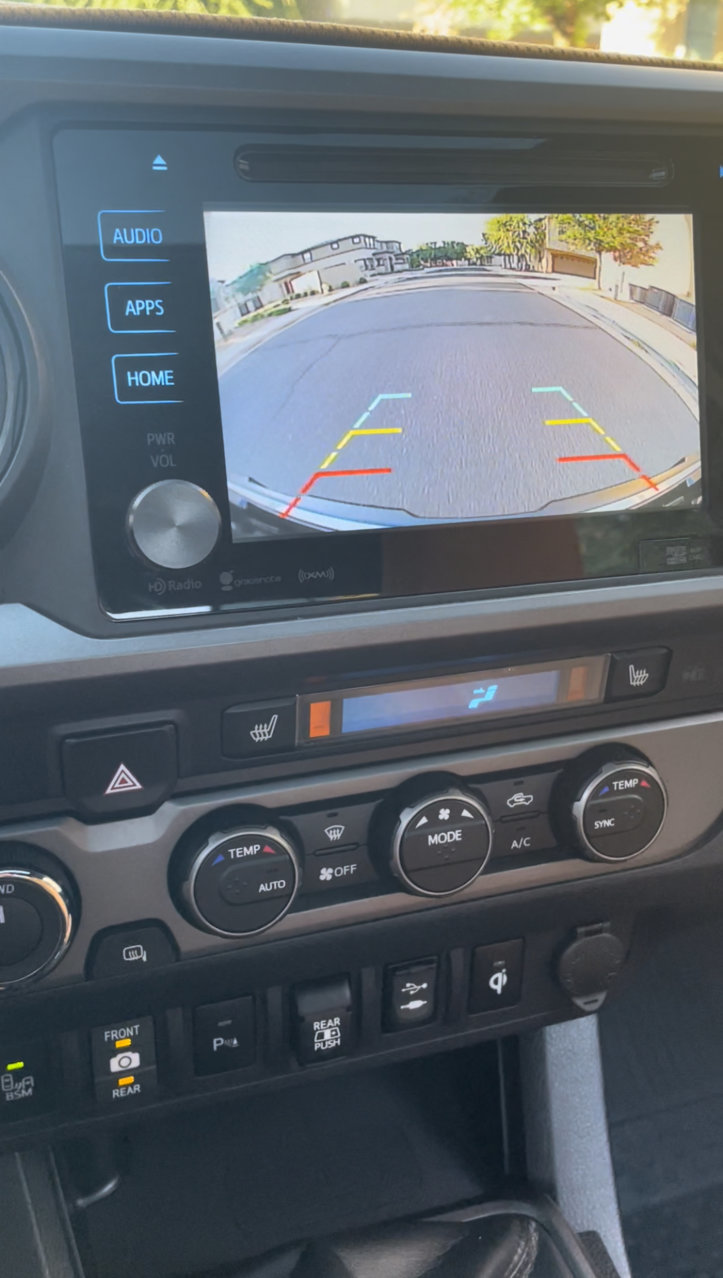

    But visibility sucked. I needed a front camera. So i got the Anytime Backup camera and Installed that. I snapped the wire going through the firewall grommet. I had to reorder a wire for like 40 bucks but thats not too bad. I then got plastic tubing to feed the wire through. That was a much better idea. I managed to stick the camera dead center by the radar and have had no issues with it messing with cruise control at all. None! Just took some trimming of plastic on the grille.
    10/10
