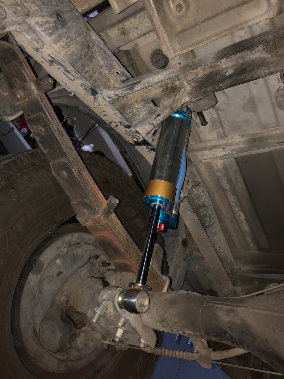

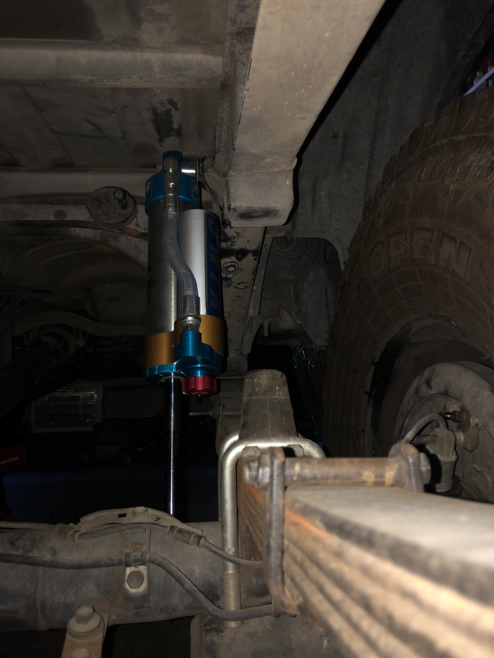

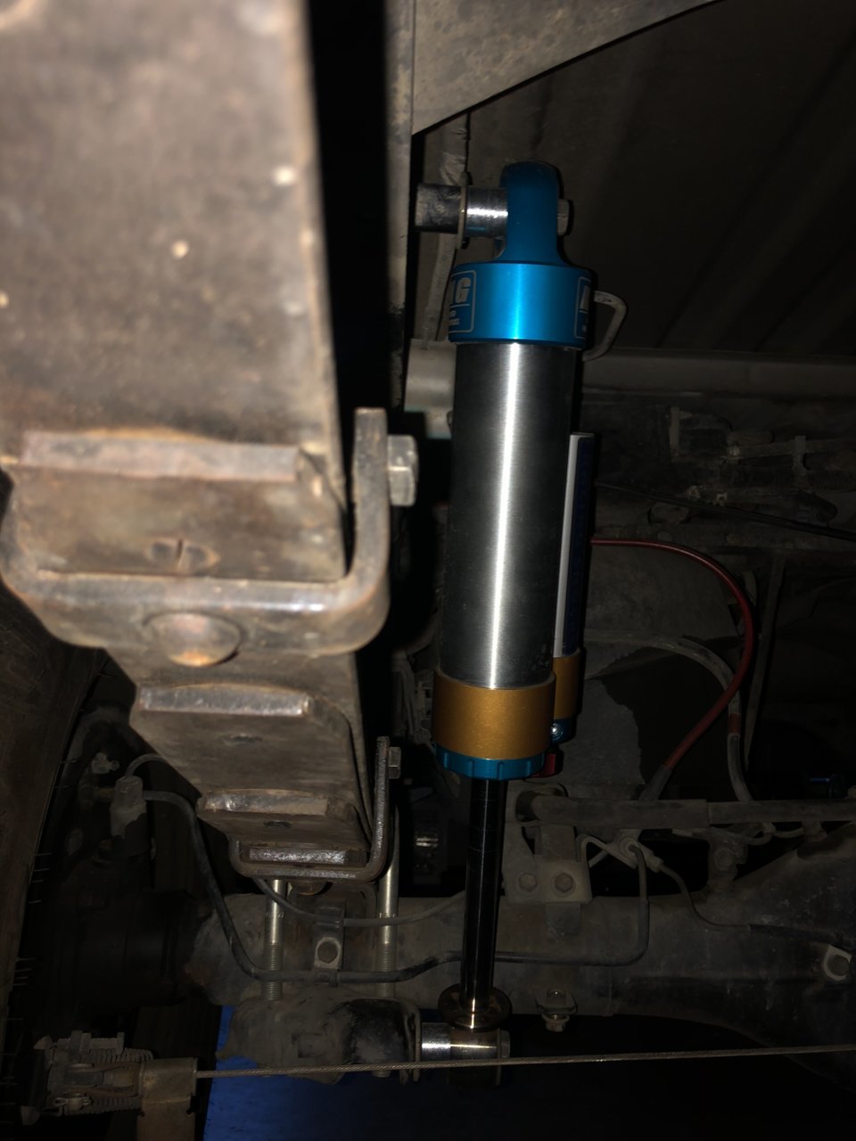

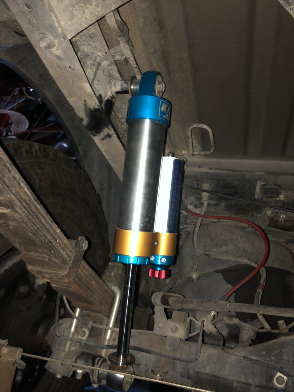

    So first I had to loosen the bracket that mounts the reservoir to the shock body. Then I had to spin the reservoir all the way over as much as possible to clear the Deavers.
    Now what really helped out is I switched the driver side shock to the passenger and vice versa. It may not look like it in the pictures but there is just enough clearance to bottom out and have the resi not get crushed.
    I did however have to raise the axel a bit to get them on the mounts.
    Excuse the dark pictures and bad angles:
    3C05BFB0-96C6-4508-B275-2F1EC7270A88.jpg 08334945-7127-42E5-A3B7-58F25A945A51.jpg 3C05BFB0-96C6-4508-B275-2F1EC7270A88.jpg 08334945-7127-42E5-A3B7-58F25A945A51.jpg 3C05BFB0-96C6-4508-B275-2F1EC7270A88.jpg 08334945-7127-42E5-A3B7-58F25A945A51.jpg D6F25814-8EE9-4217-A699-3DFB721842E1.jpg E19C50D5-0F40-4F87-B35D-877CD7A66395.jpg
    Probably going to be getting rid of them soon

    That last pic looks like you might have a leaky axle seal going on, unless its from something else

    It’s just a little brake fluid from bleeding them a week ago lol

    That's too bad... you have extra good ones with an adjuster...
    I expect they have different extended lengths, and being forced to
    swap sides like that I guess has the long one on the short side
    and vice-versa...
    I wonder how many people who have Kings on 1st gens have to
    fight with the reservoir bottle on the passenger side? On my "good" pair (the custom length set)
    that's on my truck now we discharged the passenger side shock to enable us to spin-the-bottle
    around enough (a whole bunch) to where it needs to be and recharged it with nitrogen. It would seem
    that King would have sold a bunch of these shocks to people with 1st gens
    and know where to place the bottle themselves... did you have to put
    the reservoir lines in a bind to get the bottles moved enough? Once charged
    the stiffened reservoir lines offer very little wiggle room...

    Unfortunately yes but it’s okay it’s a learning experience in my book. Probably will toss out my steelies and pick up some Walker Evans when I sell the Kings.
    As for the lengths they seemed pretty much the same length to me when I got them and compared them so I wouldnt be too sure about the lengths. And YES it was a bitch to move the resis around, they were fully charged so yeah those hoses were stiff as can be lol they didnt bind per se, just kind of bent over a bit but aren’t being over exerted. How much did you pay for your custom length Kings if you dont mind me asking? And what specs did you have them built to?
