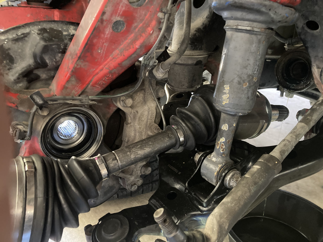

    Half way there, my plan leaving cv to hub didn’t work.

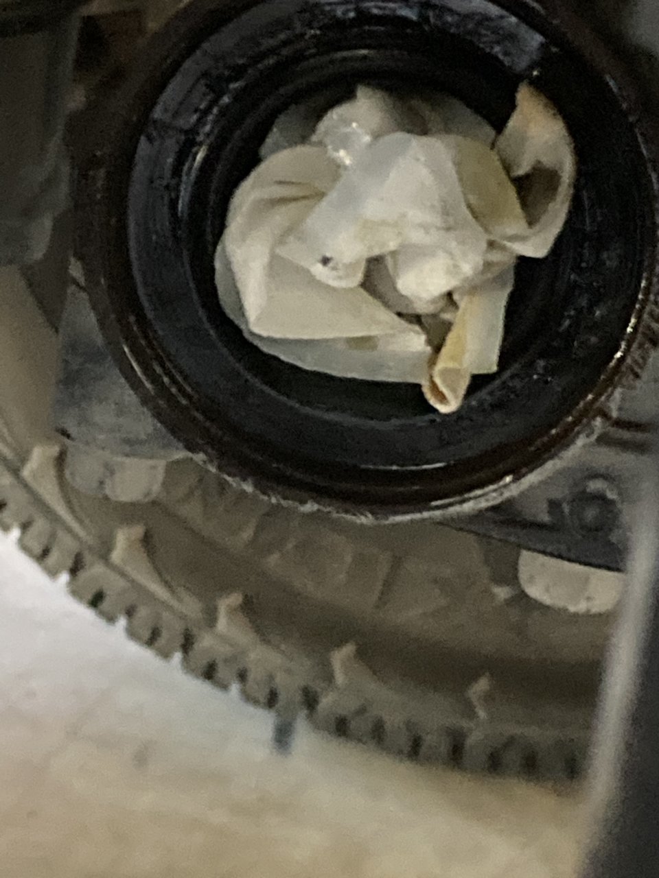

    Came to a stopping point wife brought me some food and new seal is in. Got a rag in it to check for seepage out the bottom of it.

    Hi Matt, hope that cv is good to go now

    Hey Mark it’s back together just gotta torque everything down and put wheel on.

    I was going to ask if it was Miller's. Don't you eat there like twice a week? :rofl:
    What part of the seal was messed up?

    We eat there about 3x a month, it was torn on the right side.

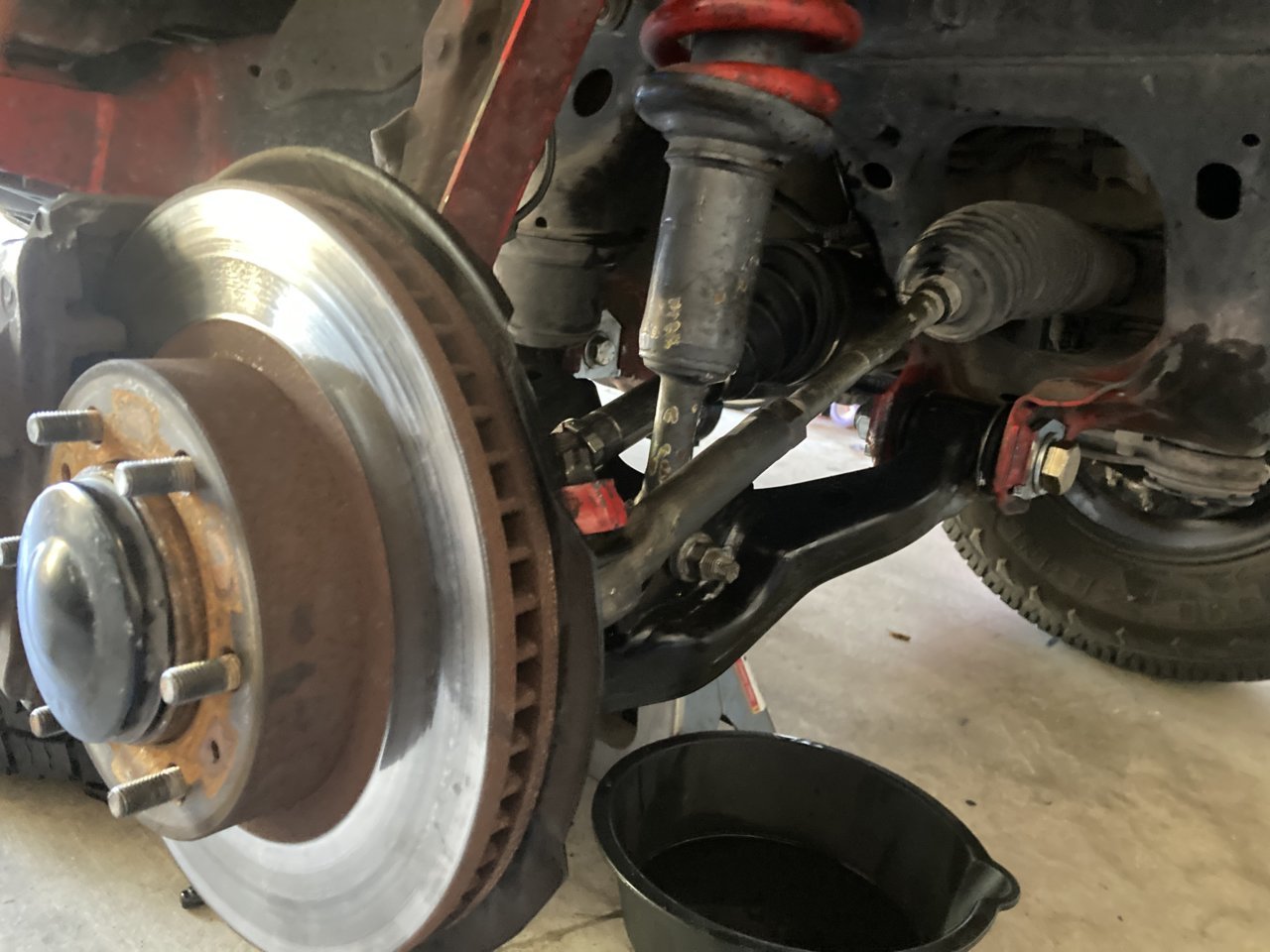

    Done I used a oil filter wrench with the old seal in front to tap it in.
    Thanks Mark just got back from test drive it’s running good just bout to rinse and head to tire shop.
