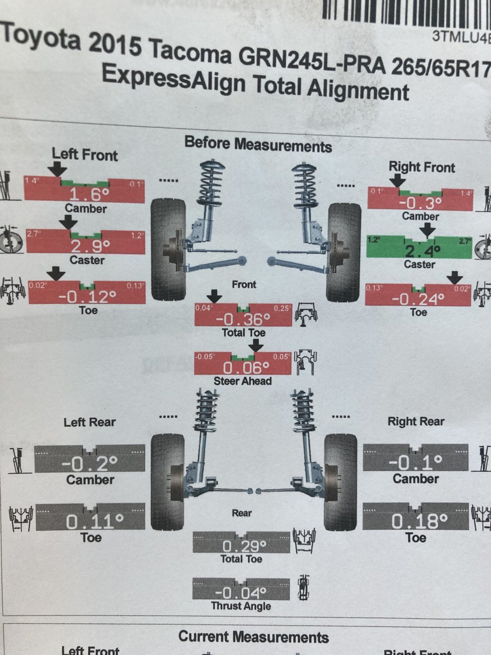

    Can you show a pic of your alignment printout?
  2. Feb 1, 2021 at 2:49 PM
    MattCowsmasher
    MattCowsmasher [OP] ( -_・)ᡕᠵ᠊ᡃ່࡚ࠢ࠘⸝່ࠡࠣ᠊߯᠆ࠣ࠘ᡁࠣ࠘᠊᠊ࠢ࠘
    Apr 7, 2017
    #215629
    48,698
    Temple, Tx
    O3 Rubicon wrangler
    Will do

    Before alignment

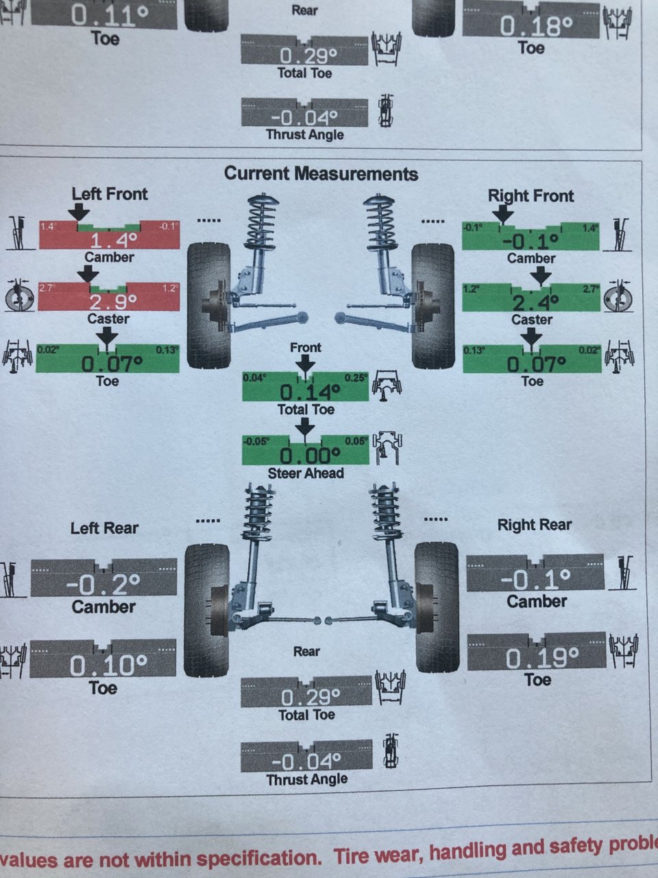

    Post, truck drives great I’m a little disappointed with castor but no rubs.
  5. Feb 1, 2021 at 3:26 PM
    Beretta4x4
    Beretta4x4 What makes the green grass grow? TTC#0114
    Jan 20, 2016
    #175568
    30,285
    Josh
    Temple, TX
    6-speed death mobile
    I'm intrigued by that left front camber.
  6. Feb 1, 2021 at 3:26 PM
    MattCowsmasher
    Apr 7, 2017
    #215629
    48,698
    Temple, Tx
    O3 Rubicon wrangler
    Me to maybe frames bent

    Was that the side we kinda had to force the shims in the cam tabs? :anonymous:

    Yea but oem specs are supposed to be off by .5 I believe.

    Tweaked frame or tabs?

    I’m thinking frame

    I could see that if it was pushed up and back.

    I’ve taken a few hard hits in that area wheeling.
