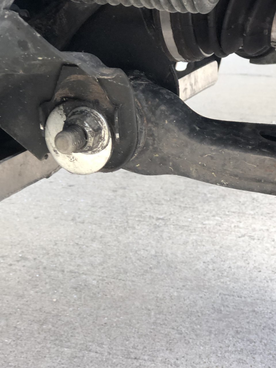

    That’s fine if I’d use a paint pen to mark cam bolts to get the alignment as close to before lift so it’s driveable.
    Put 2 marks one on the horizontal and one on vertical axis on each bolt. So mark the bolt/washer and tab part of lca you should be in the ball park.

    I’ll take a pic of what I’m taking bout reading that is confusing.

    I think I know what you’re talking about, but a pic would be much appreciated. I’m sure Maner probably knows a lot more than I do

    Here we go, keep in mind I have crappy cam bolts and flat tabs. I was mistaken all you need is 2 marks on each side.

    :thumbsup:
    Gotcha. Thank you sir
