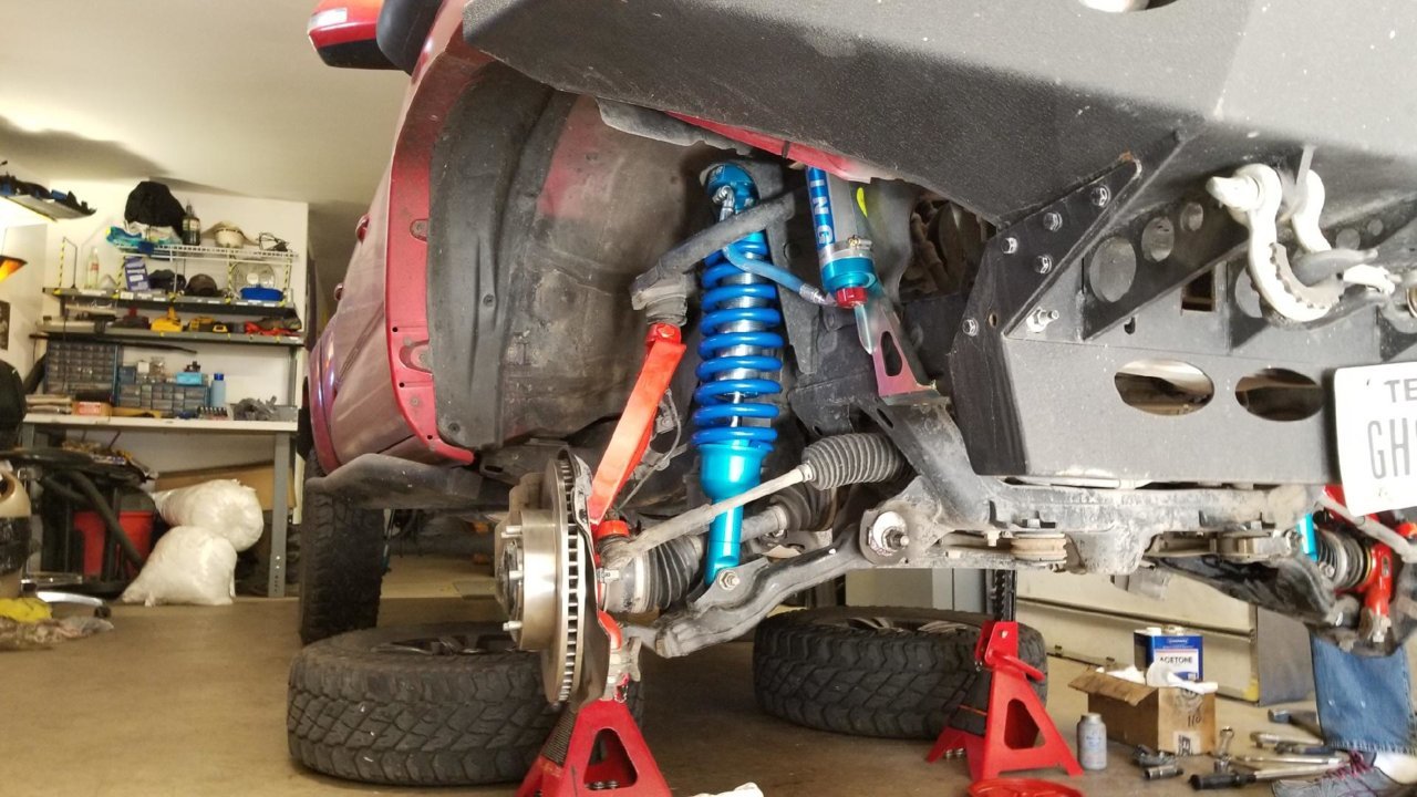

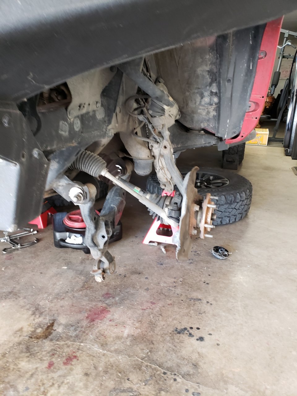

    Well it is done an I couldn't be happier. @Texoma did a great job an hella quick with what was all involved.
    Got spindles with guessets, new hubs, ecgs bushing, new pads an rotor, swapped 600 to 700lbs springs an installed the coilovers.
    During the entire teardown an install, we found 2 issues one was easily resolved. First one uca balljoint needs replacing it had a good amount of water pour put of it. 2nd with the added metal to the spindles the stock rims have about 1/4- 1/8 of clearence an hitting the wheel weights on one rim. Chris was nice enough to allow me to have a pair of 1in front spacers an issue fixed.
    Super happy an love the new ride super plush went for a test ride in the dirt an buttery smooth.

    A bunch a cool stickers, a bada ass MetalMiller Tx Longhorns grill emblem painted Hemi Orange, JBA long tube headers with o2 sims, Diff breather mod, Red LED interior lights, Fancy head unit that plays ipod n movies, Also DIY install factory stuff like, factory cruise control, factory intermittent wipers, OME nitro struts with 886x springs and toy tec top plate, JBA high caster UCA's for better alignmnet and dey beefier too, Old Man Emu Dakar leaf springs in da rear with the gear, U bolt flipper, Ivan Stewart TRD rims with 33" K Bro 2's, some bad ass weather tech floor liners so I don't muck up my interior, an ATO shackle flipper for mo travel in da rear wit the gear, also super shiny Fox 2.0 shocks back there too, all sorts of steal armor for bouncing off of the rocks like demello sliders, AP front skid, trans skid, n transfer skid, demello gas tank skid, and a tough as nails ARB bumper with warn 8k winch, I'm sure there's more
    I put enough grease in the ball joint to flush the water out and keep it out. Hopefully it holds up long enough to get you new BJ's.
