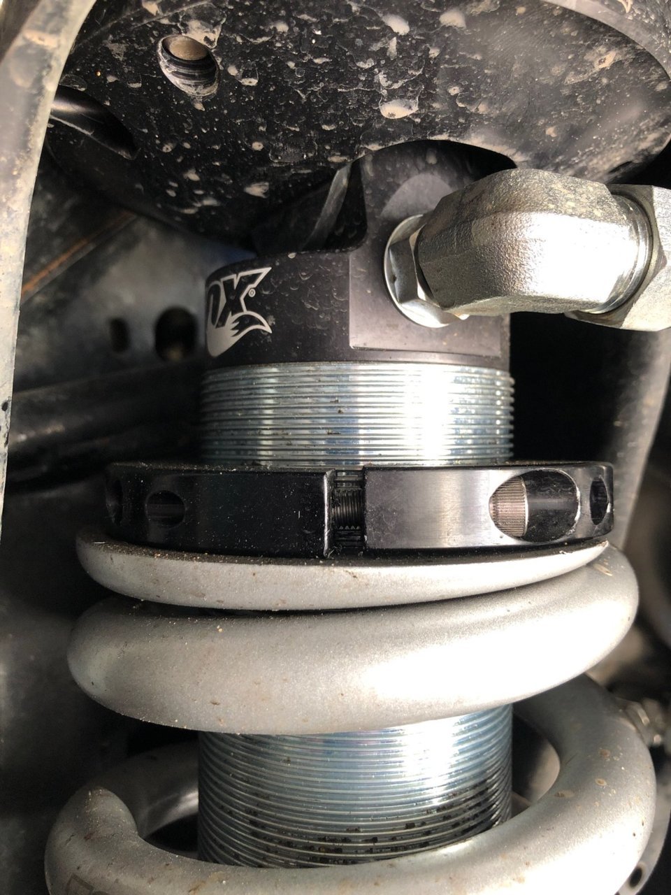

    Make sure you lube the threads on the collar and shock body, top of spring, bottom of spring, and don't take the tension bolt out completely. Just back it off enough to loosen the collar. Pic shows what happens when you don't do any of that. If you look closely, the collar jumped threads on the body.

    Noted, I just loosened one full turn when I attempted the other day an lubed the shaft real sweet like:D. The new T-handle meat hook looking tool just got delivered about an hour ago so its literally going down tonight.

    So just finished taking 3 turns out of the kings to soften the ride some an OMG it rides like Aladdins magic carpet now. Lost maybe 1/2in up front up dont care.:bikewhoops:
    @Texoma your a mad genius thanks for the tips:fistbump:

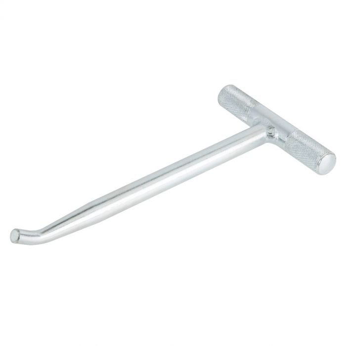

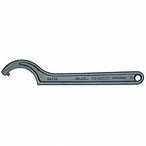

    What tool is used for adjusting?

    For most coilovers use a spanner wrench, I went with the T-handle tool from King allowed me to reach behind the resi hose without having to remove the shock.

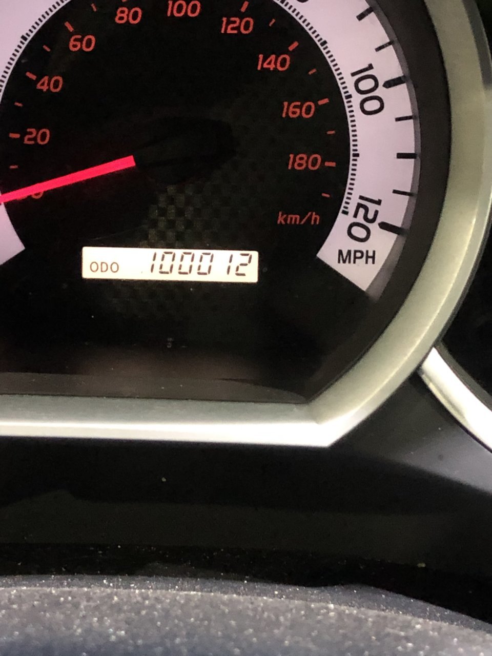

    No mod stuff today but a milestone to me at least. On the way to the store I passed 100k didn’t get to film the change cause It was 6am an not paying attention.

    Bummer

    I know was disappointed coffee hadn’t kicked in yet.

    I also missed my opportunity to take a picture when I hit 50k. I noticed I surpassed 50k at as round 51k. :oops:

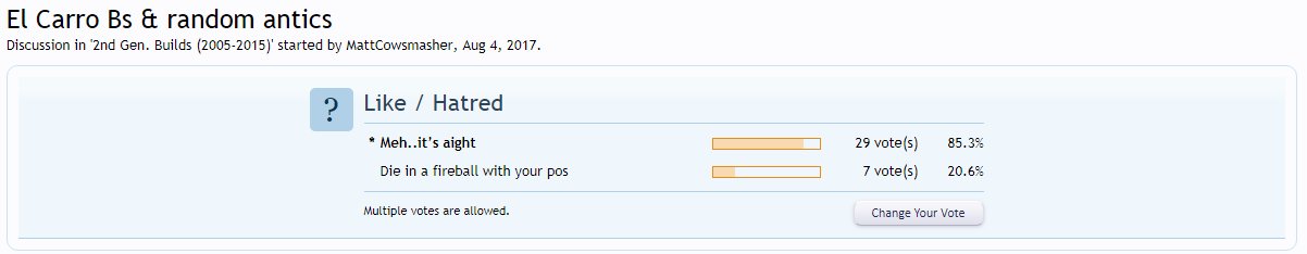

    I have been reading through all 37 pages of posts and am shocked that no one has said something about the vote not adding up. Stuffing the ballot box maybe? :)
  14. Feb 5, 2019 at 2:22 PM
    #734
    MattCowsmasher
    MattCowsmasher [OP] ( -_・)ᡕᠵ᠊ᡃ່࡚ࠢ࠘⸝່ࠡࠣ᠊߯᠆ࠣ࠘ᡁࠣ࠘᠊᠊ࠢ࠘
    Apr 7, 2017
    #215629
    48,698
    Temple, Tx
    O3 Rubicon wrangler
    Thanks for taking the time to read this madness. I’m confused what do ya mean not adding up. The weird .xx %?

    Yeah... 85.3 + 20.6 = 105.9 (not 100%)
  16. Feb 5, 2019 at 2:30 PM
    #736
    MattCowsmasher
    Apr 7, 2017
    #215629
    48,698
    Temple, Tx
    O3 Rubicon wrangler
    Yea just noticed that perhaps something with people changing votes perhaps:notsure: but those 7.5 people have it out for me.:quickdraw:
