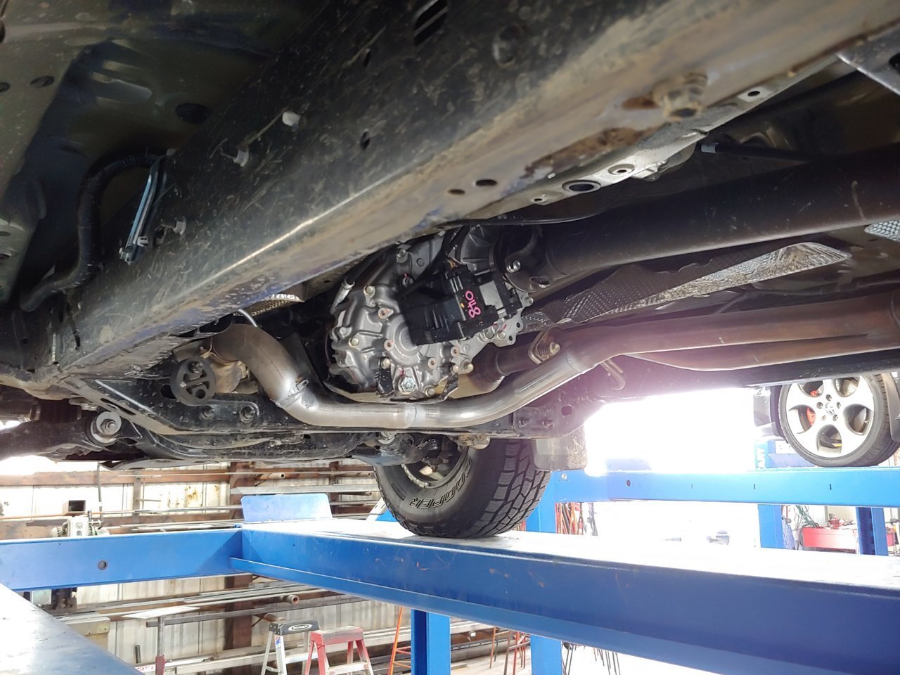

    :thumbsup:That’s what I’m worried about but I’ll get some today for sure. I may try to have it tucked closer to the heat shield in front of the transfercase we’ll see how it goes, kinda like this.

    There is a ton of space to the rear of the actuator and before the drive shaft to work with. If you route it behind the xfer case, you can have them, use 3" all the way back. The OEM one is a double walled 1.5" or so... so more air!

    Word! I didn't either until they cut it off and showed me. Double walled to help with insulation apparently
