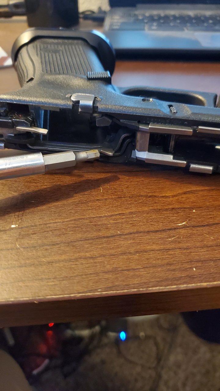

    You mean where the trigger breaks and were the rear wall is?
    1911s are super short in the trigger break and wall.
    I can take a look, but I've been drinking so I can't look at it mechanically acting weird today.
    The only reason that I can see for the short reset and break is the angle of the rear sear and sear cage.

    Ya it’s bout like a 1911 I’m gonna put the oem trigger spring and bar back on an see what happens.

    Good call, but I think it's a geometry issue.

    I do as well

    I'm thinking maybe the rear end of the seat cage, or what keeps it straight, is going the front end down. That'll reduce sear engagement, but I'm not too familiar with Glock triggers. I'm going to pull out the G19 and take a look.
    What Gen internals are you using?
    Looking at my Gen5, straight lines. Use the rails to align the blocks. Also check this part:
    To see if it properly resets the trigger.
  6. Aug 7, 2020 at 4:46 PM

    Ahh this is gen 4

    Gen 4 and 5 are only slightly different, mainly in the slide.
    Double check the disconnected I pointed at. Use the factory Glock slide you have right now.

    Will do

    Let me knew. I think diagnosing reliability and performance issues is the best part of vehicles and firearms.

    Found the issue it was the light trigger spring and the trigger bar is set to far back to work with this setup.
