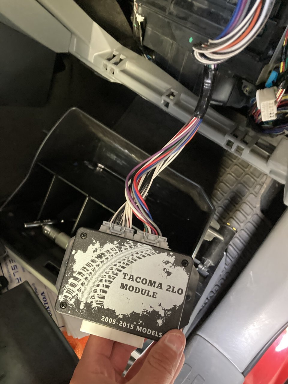

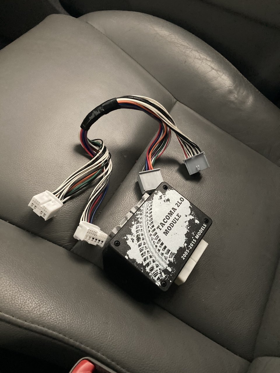

    Honestly bought it on a whim I don’t back up with a trailer or go on hard switch back trails where turning would be an issue in 4lo.
    It’d be great if I had a MT.

    It was fun cruising in 2lo on the trials seeing what a 2wd can do though.
    I’ll get back that nonsense eventually.

    It’s not but with that ecu it let my drive in 2lo.

    Still confused?? Let me dumb it down like it had to be done for me.
    My truck is 4wd, 4H is 4wd with normal gearing like in 2wd, 4low the transfer case makes gearing way low for slow speed crawling but binds up when turning.
    That module allowed me to have the 4lo crawl ratio but in 2wd so no binding along with the mechanical lsd it was really fun.

    Mark you’re not at all it had to be explained to me 3x before I comprehended it. Just the voodoo of eletrontics made me think it was impossible I knew of the old skool trucks dropping in 4lo without locking the hubs did the same thing.
