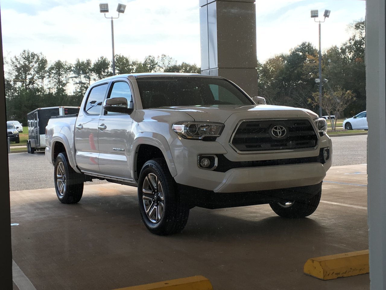

    Purchased November 2015 in Enterprise Alabama

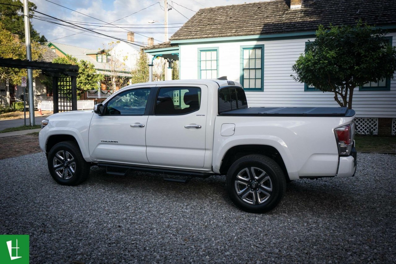

    Tinted Windows and Predator steps:

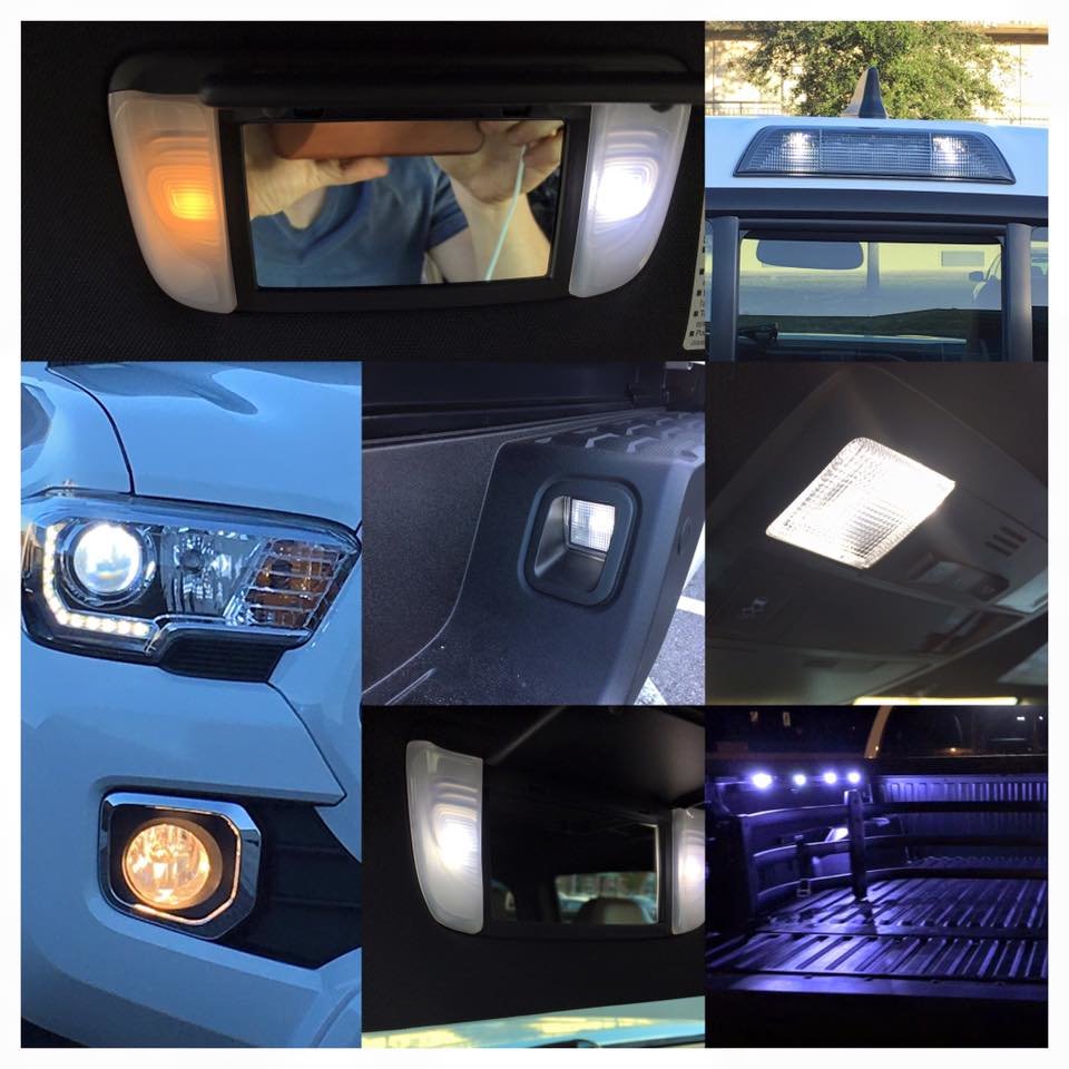

    LED 6k Running lights, Fog Lights, Bed Lights, Interior Lights

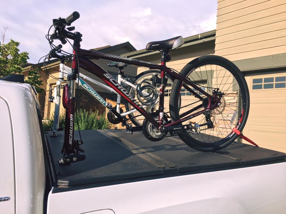

    Thule Bike Rack Carrier:

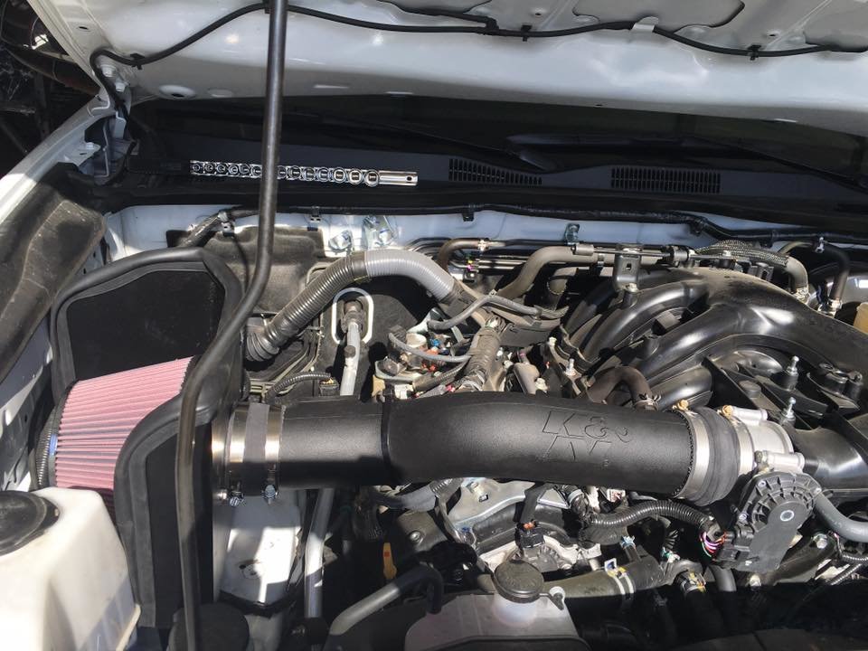

    K&N Air Intake (which I ripped off within one month because I hated the way it sounded)

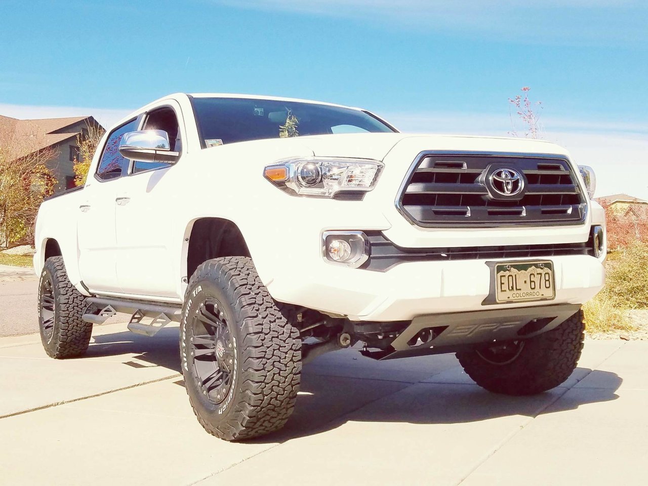

    3/1 Leveling Kit (Don't worry, I replace it soon)
    275/70/17 BFG KO2's
    17 X 9 XD Wheels with -12 offset
    Skirt Delete
    Emblem delete (Except Limited) (Don't worry, that comes off soon)
    BPF Skid Plate

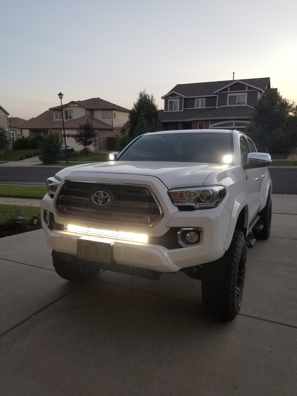

    Cali Raised 32 Bumper bar light and Ditch Pods @CaliRaisedLed

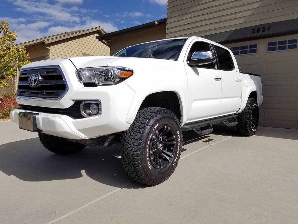

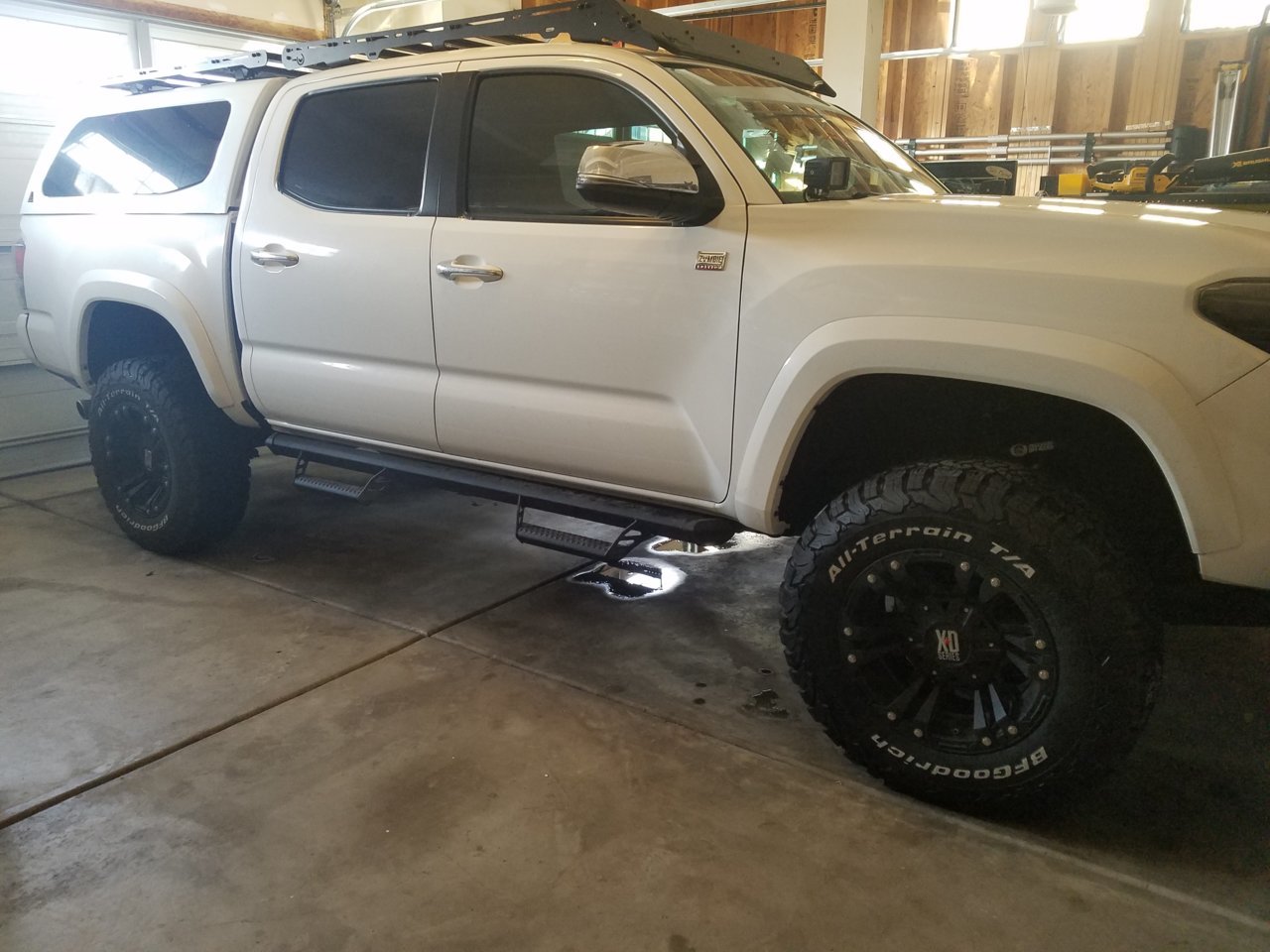

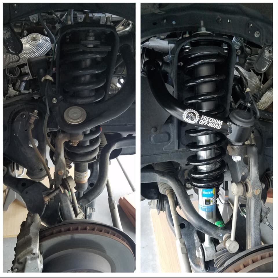

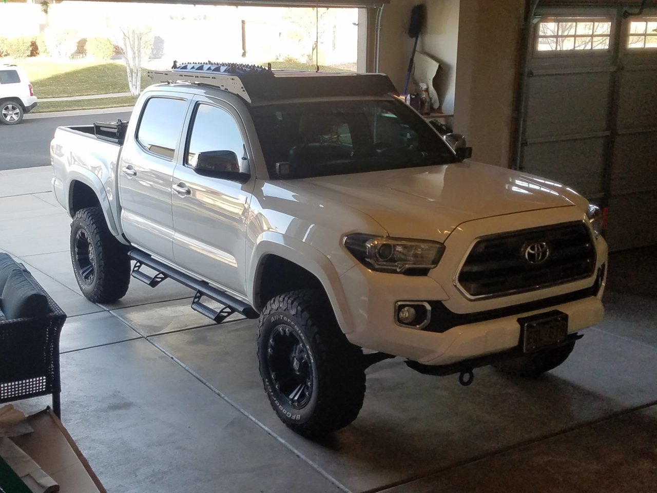

    Front OME 888's w/ Bilstein 5100's @HeadStrong Off-Road

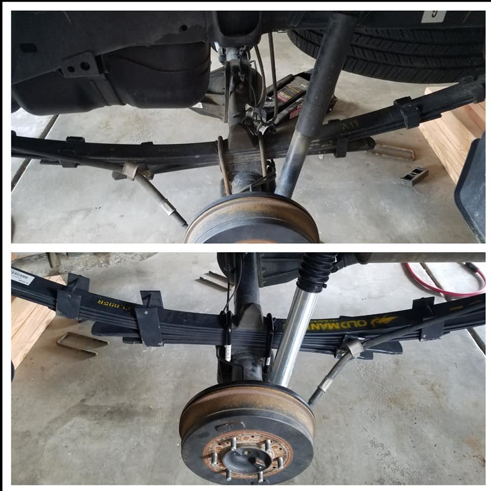

    Rear Full Dakar Medium Leaf Pack w/ Bilstein 5100's @HeadStrong Off-Road

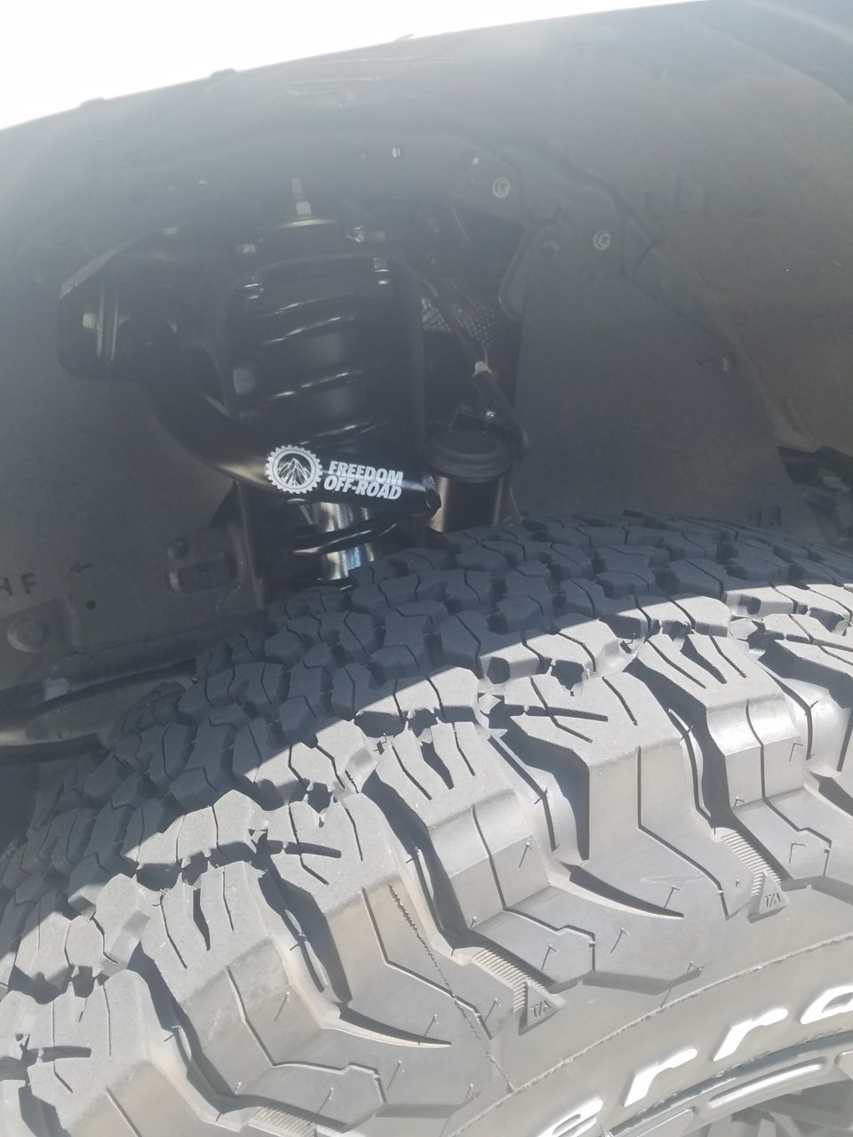

    Freedom Off-Road Aftermarket UCA's
    20180806_172910.jpg 20180806_172825.jpg 38650383_1359241200877313_4490020104716681216_n[1].jpg 38672551_1359241237543976_4599572312277123072_n[2].jpg 20180808_114951.jpg

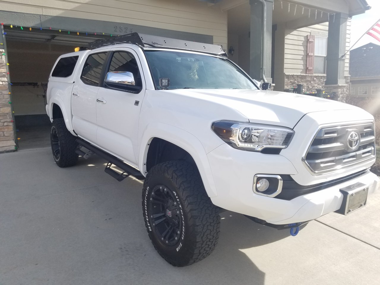

    CABRAC Prinsu Rack and MAXTRAX

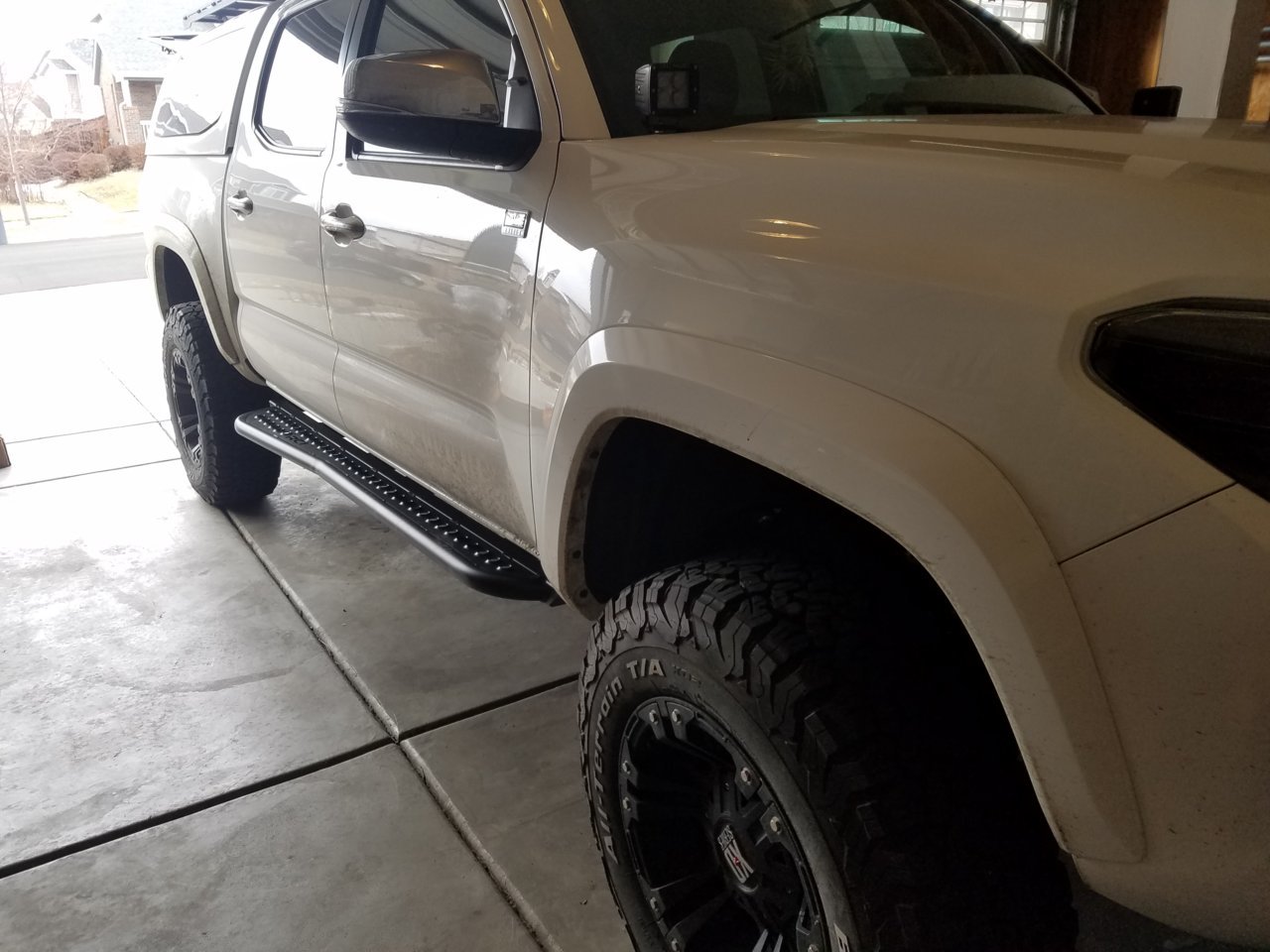

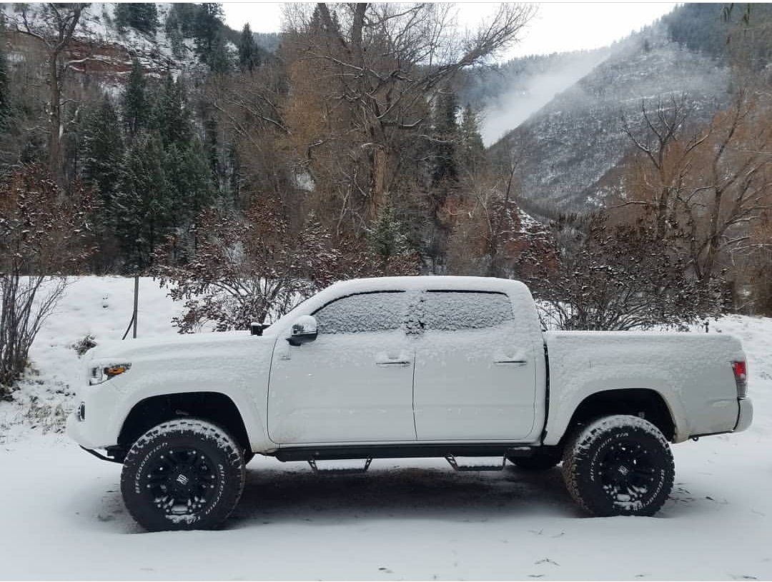

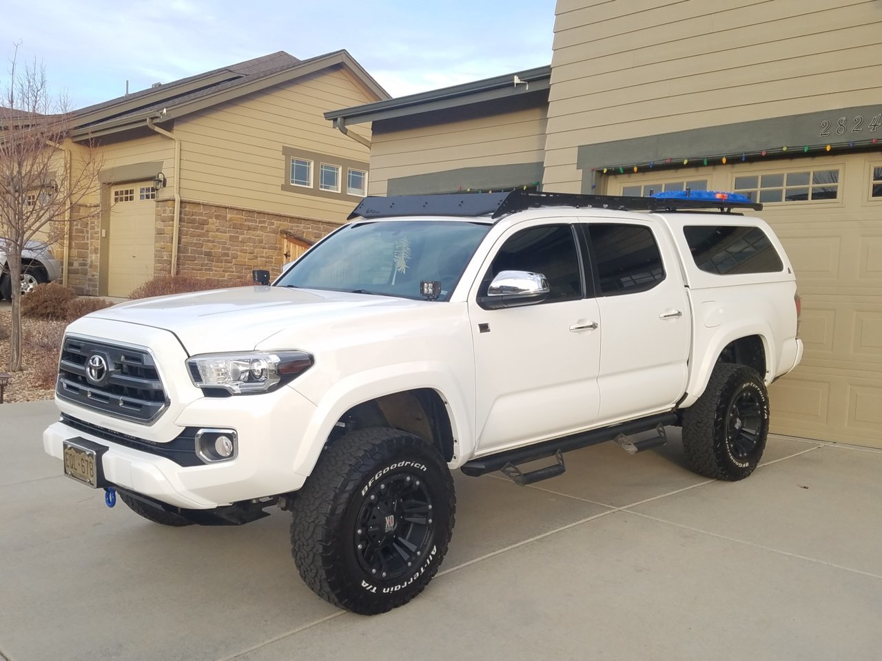

    You may notice it looks a little taller here... The previous suspension setup drooped a little more than expected. The tires started rubbing, so I had to lift it a smidge more. I put the front OME's and 5100's on the 2nd notch vice the 1st notch which is +1".
    Then to match it, I threw a 1" block under the Dakar leaf pack in the rear. Only reason I did this was to get the wheels to stop rubbing. But I've had zero regrets so far. No weird noises. No vibrations. Drives great despite being lifted more than like everyone recommends. I'm 24.5" from hub to fender.
    Also, you can see I got rid of the Limited Emblems finally. I did however put a Zombie Edition emblem under the mirrors -_-

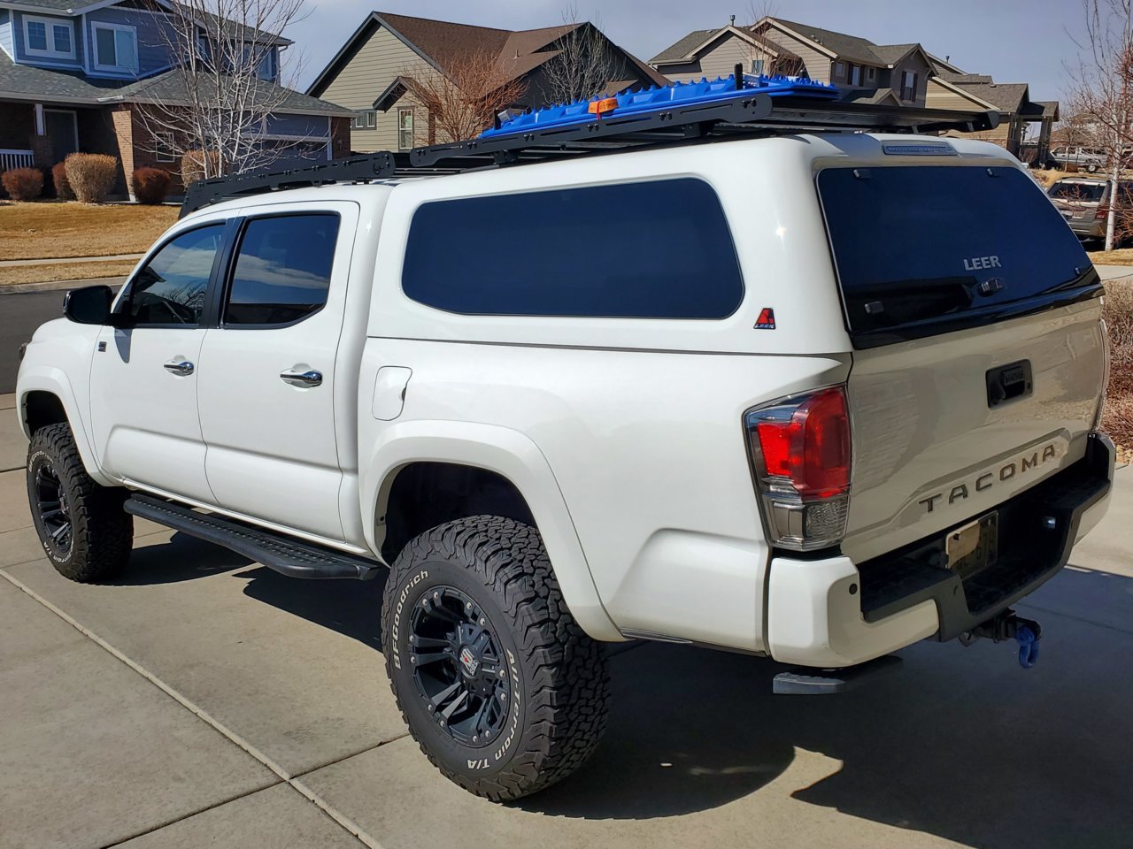

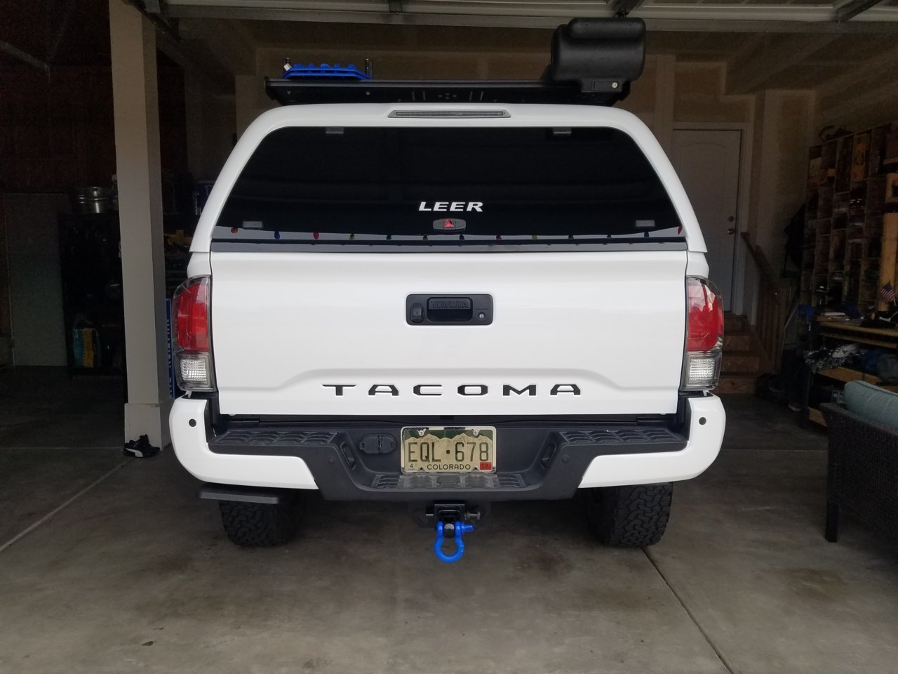

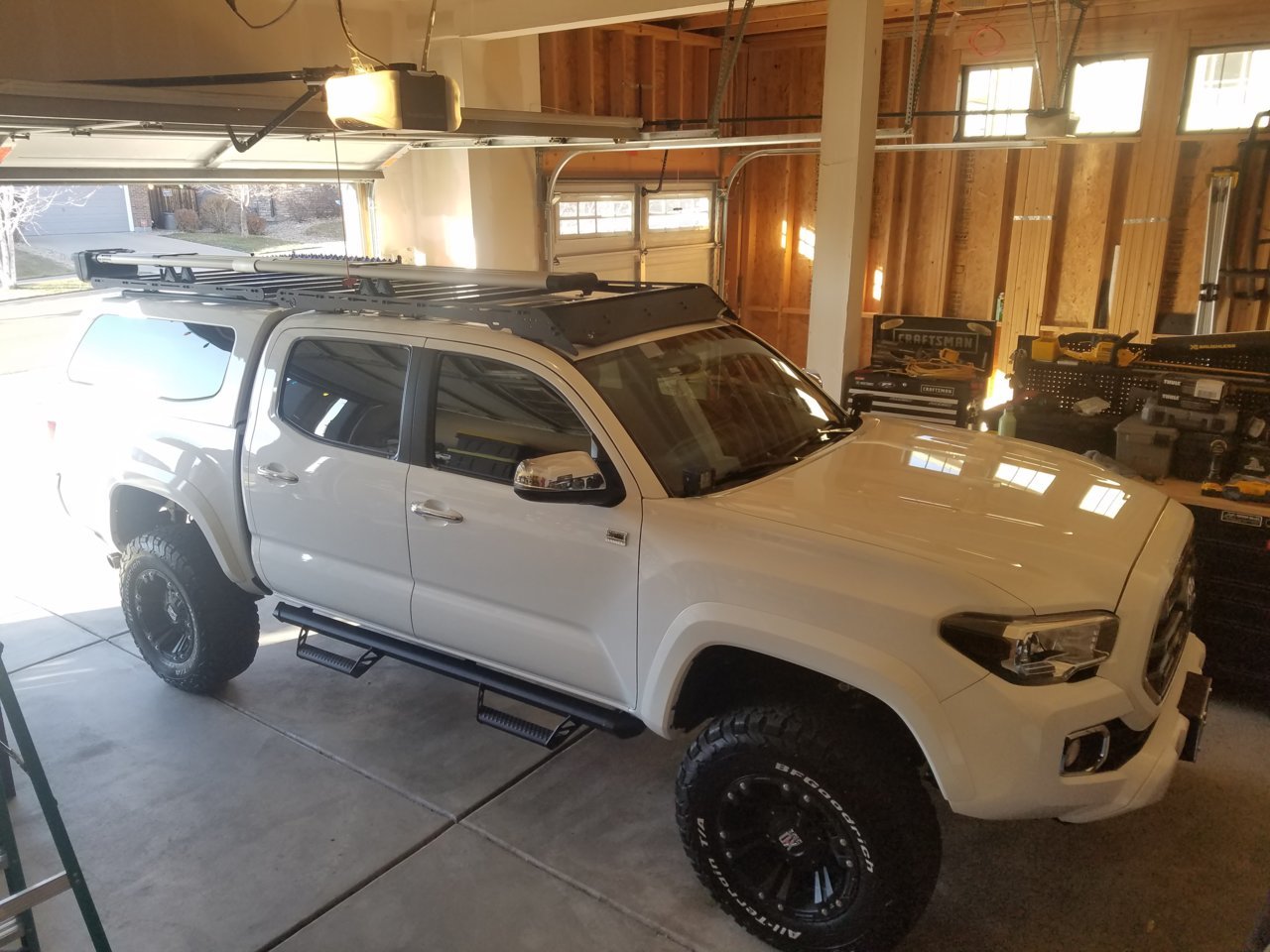

    Leer 100XQ. This really helped settle the rear level, road better from extra weight, and cut way down on road/wind noise.
    Top Rack from Prinsu to match the front Cab Rack
    AMP step to easily step up on the tailgate to get on to the roof and reach my rod vault.

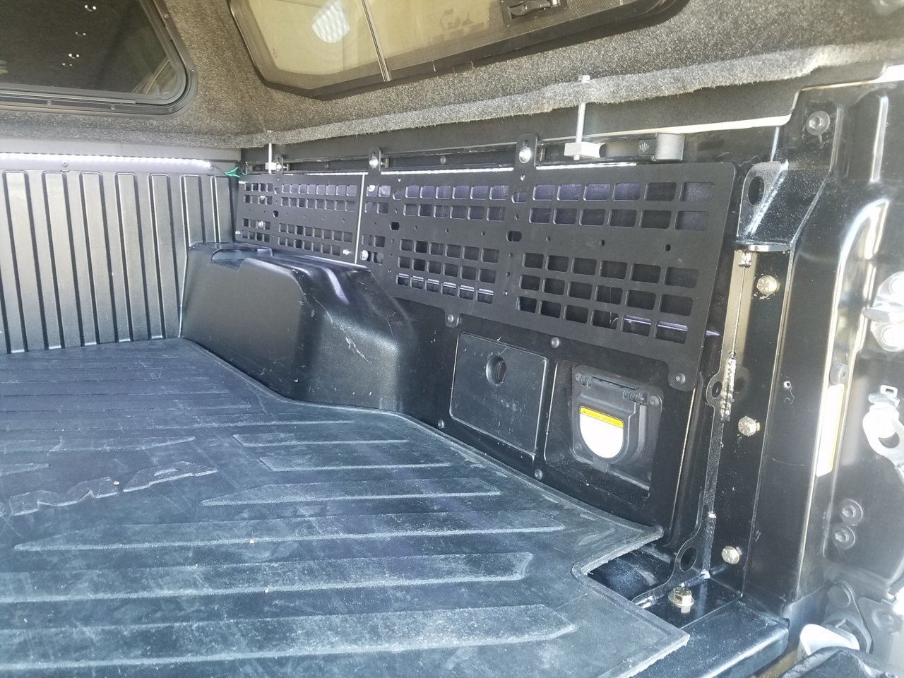

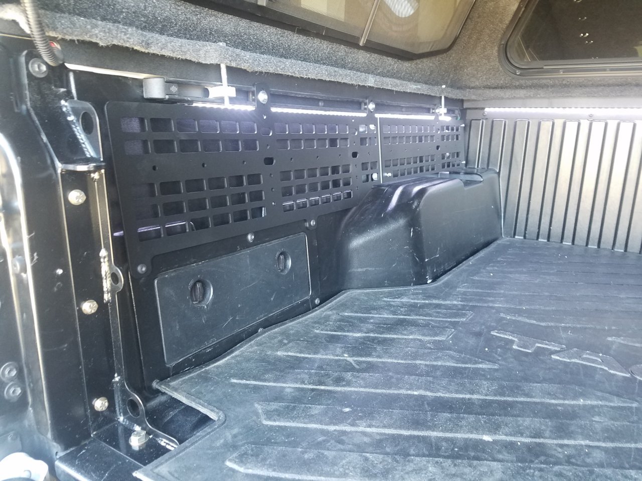

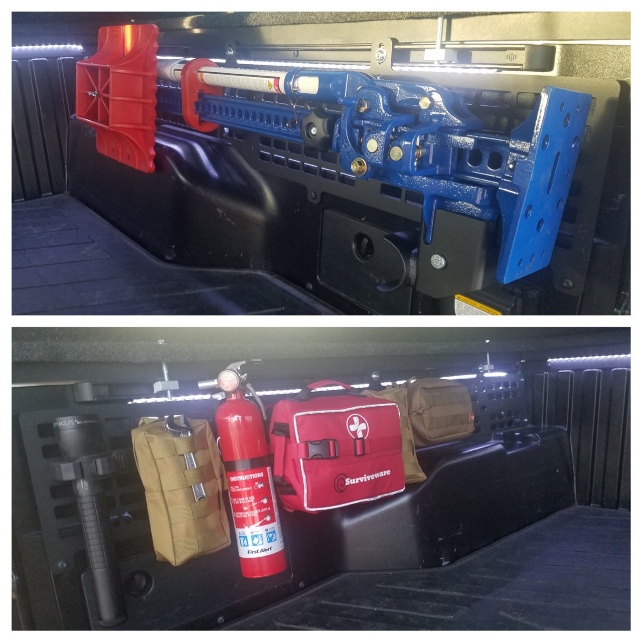

    Cali Raised Molle Bed system

    Looks dope. Was the front/back level before the leer cap or rear slightly higher? When I do my lift I want it level. :thumbsup:
  7. Jan 29, 2019 at 1:40 PM
    tjpratt
    tjpratt [OP] Well-Known Member
    Oct 27, 2015
    #167820
    782
    Travis
    Aurora, Colorado
    2016 Limited 4X4 Tacoma
    3.75" Lift / OME OVTuned
    The shell dropped the rear maybe 1/2".
    I'm still 1/4" tall in the rear, which IMO is perfect for aerodynamics, mpg, hauling, towing, etc.

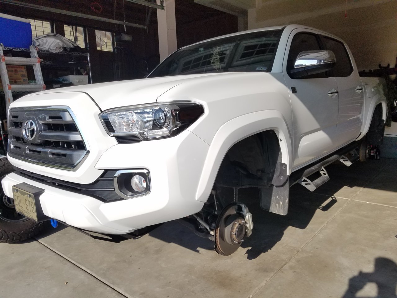

    You put the 5100s on the first notch with OME 888s? I believe you are not supposed to preload those. You should lower those back to the bottom perch and add in a small spacer
  12. Jan 29, 2019 at 3:38 PM
    tjpratt
    Oct 27, 2015
    #167820
    782
    Travis
    Aurora, Colorado
    Tell me why i'm not supposed to..
    Cause they ride fine like this. (5k miles)

    So, I emailed @HeadStrong Off-Road today to see if there's a better way to set up the suspension.
    But if i'm correct, i'll have to add a .5" top plate spacer to each side to get the clearance I have now (after putting the 5100's back to the first setting). If the 2nd setting is indeed +1". I mean, I guess I could do their 10mm spacers on each side and take out the 1" block in the rear.
    HeadStrong Off-Road likes this.
  16. Jan 30, 2019 at 3:26 PM
    #16
    tjpratt
    Oct 27, 2015
    #167820
    782
    Travis
    Aurora, Colorado
    So, after talking to a couple people yesterday :frusty: I called Headstrong and decided to alter my suspension.
    I ordered (1) 1/2 inch top plate spacer with extended bolts from it.
    I also ordered a pair of 1/2 inch blocks to go under the rear suspension from toytec.
    I'm going to remove the pre load from the front suspension by putting them back on the first notch (no lift) and move the current 1/4 inch lean spacer to the passenger side. And install the new 1/2 spacer to the driver side.
    So i'll be adding 1/2 inch lift and removing 1" pre load. So I should actually be lowering the front end 1/2 inch, but getting better ride, better angles.
    To match the front, i'll take out the 1" blocks and replace them with the new .5" blocks.

    What exactly was wrong with the k&n intake? Did you.go back to stock?

    I did go back to stock.
    It screamed ALL the time. Of course that was before my ovtune. I'm sure it would be a lot better now.

    I've read adding intake is more for the sound and not really gains in hp. So the sound wasn't pleasant? I was hoping that it was a good sound.

    It wasn't.
