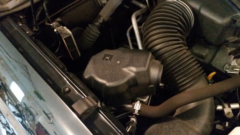

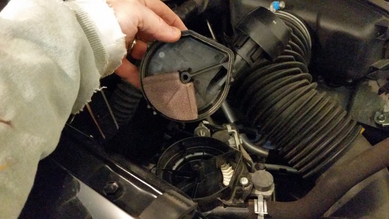

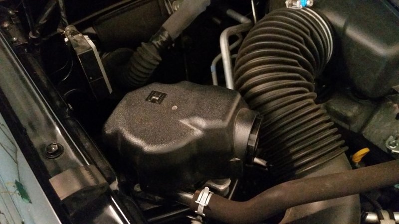

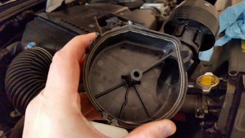

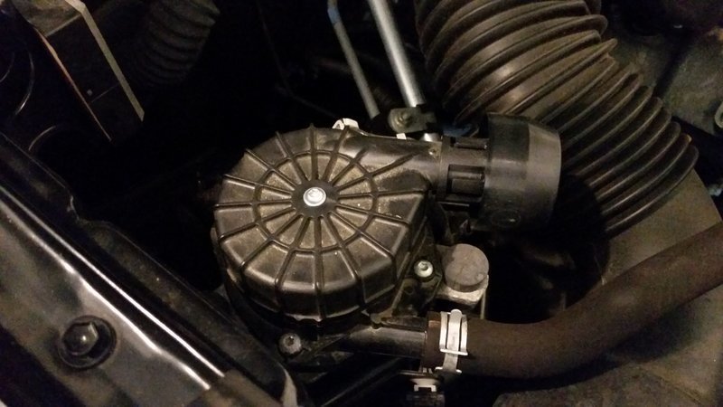

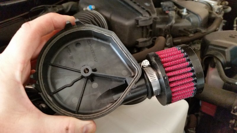

    So I did this breather modification. Thanks to TW it was super easy and awesome. It breaths a little louder now on start up and shit down but I think it actually sounds cool and it is better than a $2000 valve job because that foam filter breaks.

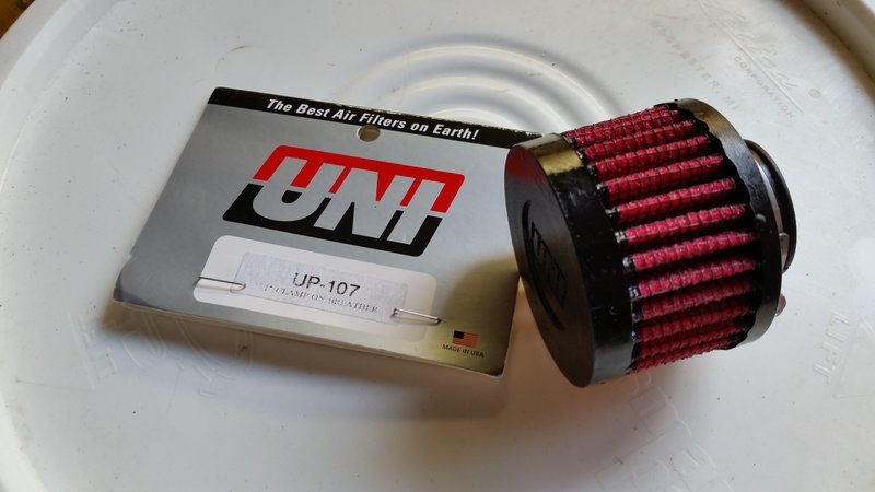

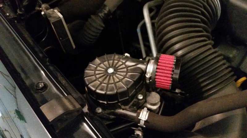

    Did the Secondary Air Pump Mod. The secondary air pump on 2012-2015 4.0L Tacomas pushes fresh air into the exhaust system through valves during cold starts to get the converters to heat up to operating temperature faster. On '13-and-up trucks it also blows for a few seconds at shutdown to avoid exhaust gas condensation on the valves, which can kill them. The 2012's (and V8 Tundras, but I don't know what years) have lots of issues with the valves failing due to condensation. This is bad as it puts the truck in limp mode and costs big bucks to replace the valves and get things back to normal. The only way to avoid it in the long run is to bypass the system completely, but that's a topic for another post. In 2013-and-up trucks like mine the main problem is the crappy foam air filter inside the pump housing, although this can also be a second problem in 2012s. When foam gets old, it crumbles, and pieces can fall into the impeller causing the motor to burn out. That also means limp mode when you least expect it, and well over a grand for a new pump. The fix is to remove the internal foam filter, and add an external filter to protect the pump instead.
    UNI UP-107 filter from Amazon (about $13):
    [​IMG]https://smile.amazon.com/gp/product/B003CJOTSA/ref=oh_aui_detailpage_o01_s00?ie=UTF8&psc=1
    Here's the pump with it's snap-on shroud still in place. Pops right off - no screws or anything.

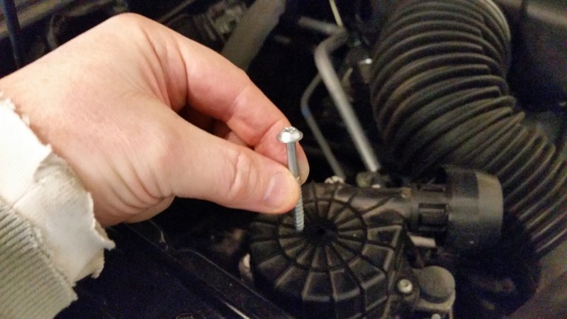

    Here's the pump with the shroud removed. The center fastener is all that needs to come out in order to open up the pump. The mushroom-shaped air inlet "muffler" is going away, and will be replaced with the UNI filter.
    The screw takes a T20 Torx bit.

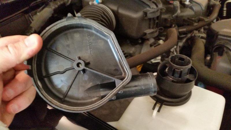

    Removing the top of the pump reveals the worlds cheapest piece of foam. This filter drys out then falls into the impeller. If that happens on the trail, you're fucked.
    Remove the foam filter and mail it back to Toyota with a "thank you" letter.
    Next you need to remove the factory inlet muffler. It has four tabs and probably could be removed without breaking it, but I busted two of the tabs in the process. It felt good.
    Put the UNI filter on the inlet in place of the muffler.
    Put the pump back together.
    With the shroud back in place everything looks stock. A little dust and grime and nobody will ever notice.
    (stole the write up from someone on here)
    https://www.tacomaworld.com/threads...you-own-a-tacoma-you-should-read-this.449563/

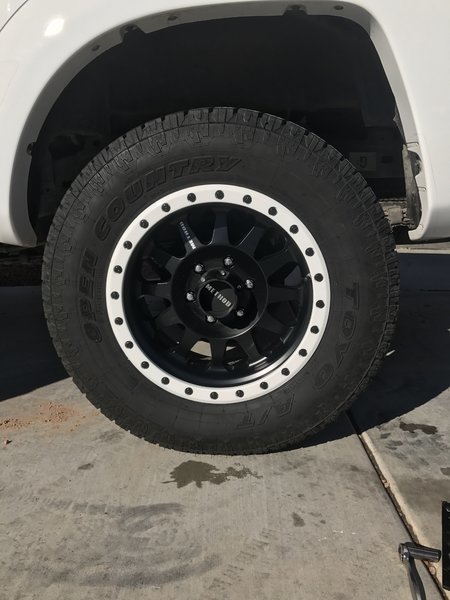

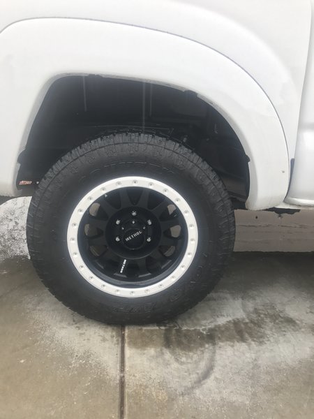

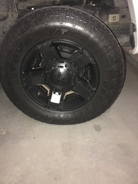

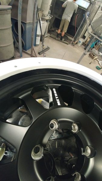

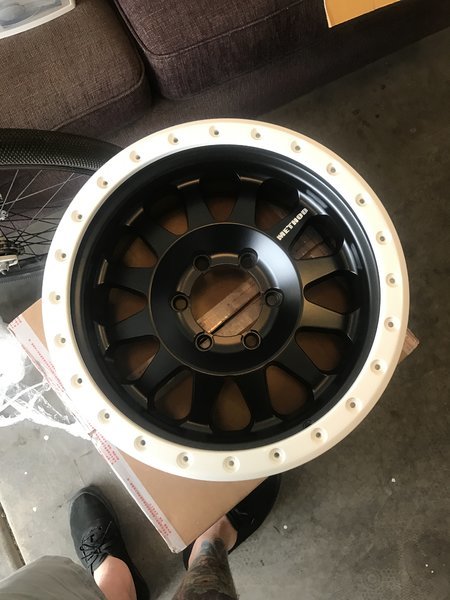

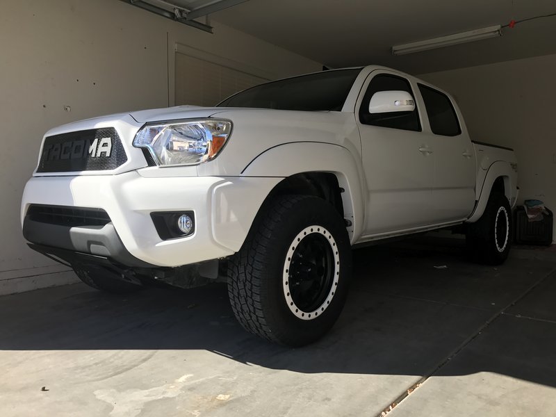

    So these are the wheels that came on my truck. KMC ROCKSTAR 2. I hated these wheels I make fun of people that have them and of course the truck I buy came with them. Also I was on the hunt for a second gen super white double cab short bed sport 4x4 for a long long time. When I finally found it I was stoked I drove 100 miles just to buy it so the wheels could always be changed.
    So I bought some method double standards because they are more my style and they look great. Also tough as hell but I wanted to look a little different than every ding dong with methods.
    So I took these wheels to ALL Valley Powder coating in Phoenix. Surprisingly one of the only places in the valley that will two tone wheels because it's a pain in the ass. Anyways it came out pretty sick.
    So I painted the bolts and washers to save some cash because a can of good paint was $6 bucks and it would have been 100 bucks just to powder coat the bolts. So cut a corner there.
    Got them mounted but the bolts weren't dry so I had to wait 2 more days.
    I love the way they turned out. I am super stoked one of a kind for sure. So if you see my cruising around let me know! Even tho I never really drive me truck because wife and I both have other cars I typically use this for truck stuff camping, off reading, hunting, hauling (nothing heavy) etc.
