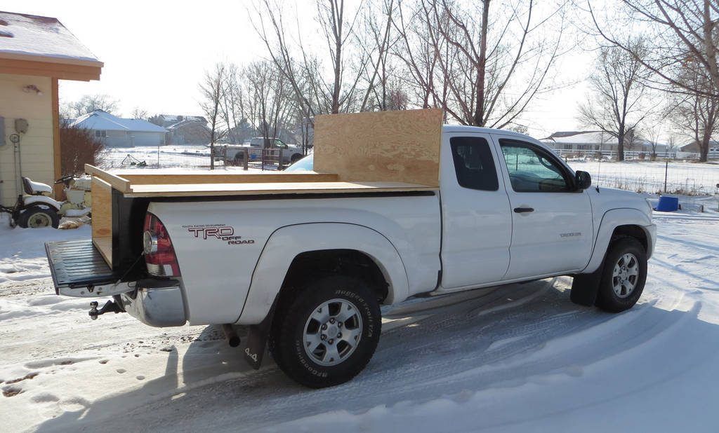

    The Importer version would probably fit, I'd have go measure the bed rail height and cab height to be sure. I was thinking of doing a modified version of the cab over. Haven't decided yet. Apparently the plans are full size to layout the walls right on top of, so I would have to modify that.

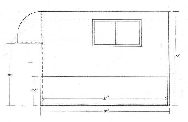

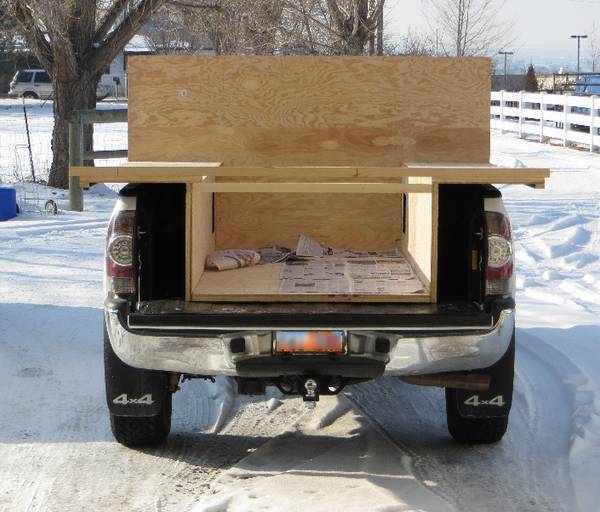

    My plan is to build a modified version of the importer. Shorter height wise, 5' tall instead of the 6' the plans call for. This would be tall enough to sit in.
    A small cabover section for extra storage space and 83" long cabin so I don't have to sleep corner to corner (which I do now with just the shell arrangement). A fully finished Importer dry weight is 700lbs. So by cutting down the size and not putting in all the interior cabinetry and equipment, I'm hoping to keep it under 500lbs.

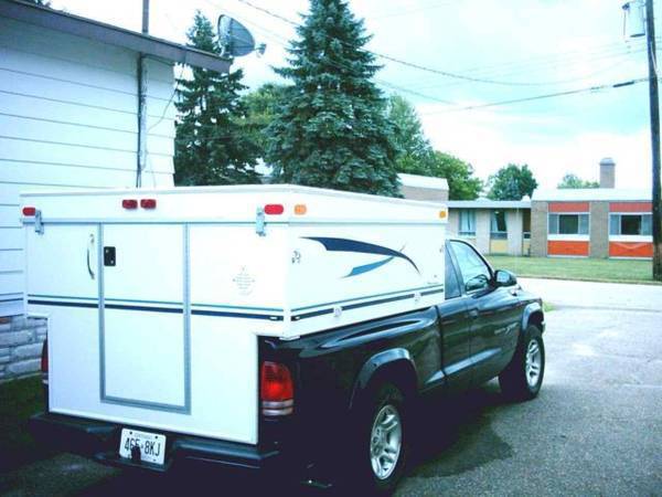

    I'm going for something that looks like this shell only a foot longer from the inside dimension of the bed.
    http://belairshells.com/camping_shells

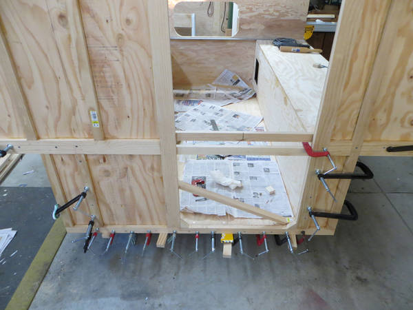

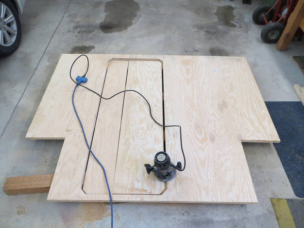

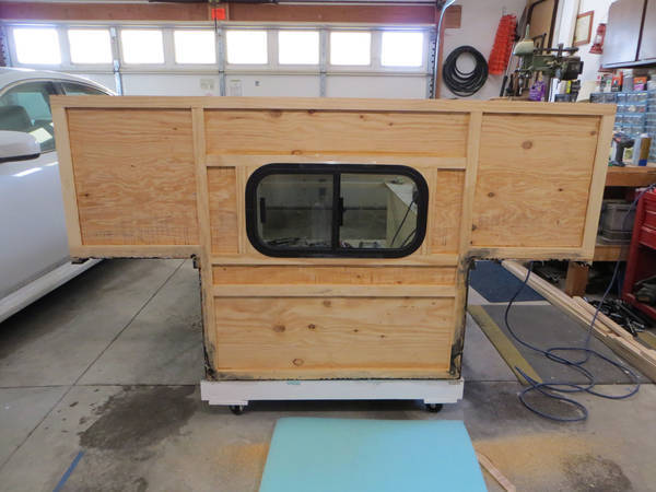

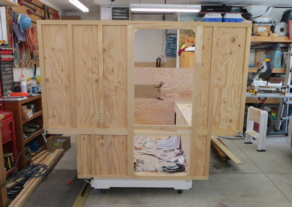

    I've started building a scaled down version of the Glen-L Importer. I've adjusted the dimensions to fit the Tacoma.

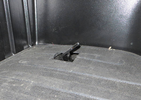

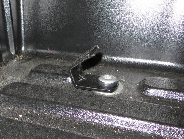

    On the front I've installed these brackets, I added extra nuts on the bolts under the frame to keep these from twisting the bolts loose. I'll use turnbuckles with eye bolts on the camper. On the rear I'm going to use the bed bolts through the floor of the camper. I'll need to get some longer bolts to replace the stock bolts.
    $13 CargoBuckle F16777 Tie-Down Floor Mounting Brackets, 2-Packhttp://www.amazon.com/CargoBuckle-F16777-Tie-Down-Mounting-Brackets/dp/B004HHU4TE
