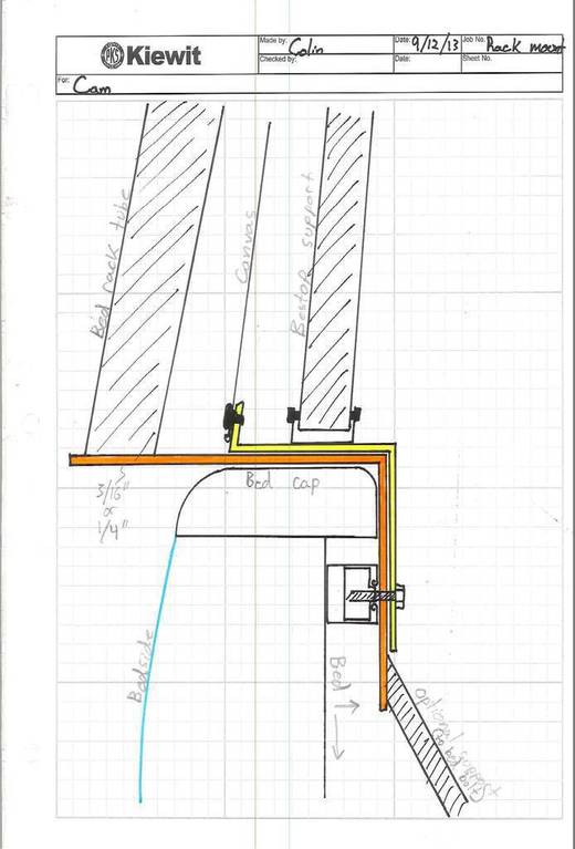

    Cam, mounting the bed rack shouldn''t be too hard. while i'm familiar with Alex's rack, I've never dug into the details of how exactly he mounted it.
    the general concept though is not far from how you mount one without a topper of some sort. you will still utilize angle iron of some sort, but the portion that sits on top of the bed rails will just have to go out beyond the edges of the bed a few more inches. it may be easiest to actually make your own "angle" steel by welding some 4''ish flat bar at a 90 to some 2''. the 4'' will get the bed rack wide enough to clear the topper, while the 2'' will give you the depth to bolt into the bed rails. if you jsut got off the shelf 4'' angle iron, it would be a lot heavier, and have unneeded steel hanging on the inside of the bed.
    the parts that are overhanging the bed caps will probably need to be 3/16 or 1/4 ich though, because of the extra leverage from the overhang. you should also still be able to brace it to the bed bolts in a similar fassion as i did. with a RTT, it's almost a must. I only breaced mine in the rear becasue that's where the spare tire and most of the weight is. if i had heavier loads on the mid and forward mounts on a regular basis, i would brace those to the bed bolts as well.
    looking forward to seeing what you come up with :popcorn:

    since i don't have a topper of any sort, i can't take photos, but i can draw something up for you.

    that would be great! I'd appreciate that.

    Here ya go Cam. not exactly sure how the bestop mounts, but i figured it was somewhere along these lines. everything is pretty decently labeled. let me know if there is any concusion. no tan markers, so you got a speedway blue bedside :D
    if you take this route, the only alteration you would have to make is that the hole in the mount for the bestop will have to be elongated a hair, to acount for the 3/16''-1/4'' that it is raised up as a result of sitting on the extra steel. you'd also want to put some sort of water sealer (foam or silicone) between all of the layers on top of the bed cap to keep things watertight.
    ChamYota[OP] likes this.

    Bestop's mount like this Colin if you were curious or it changes any concept you were thinking about. (Sorry if the picture shows up weird, I'm on my Mac and sometimes image/codes don't work)

    nice, that clamp design makes it even easier. no need to drill out any holes, just make sure you have gaps in the angle steel wherever you need to place those clamps.

    will do, i sure appreciate you taking the time to do the drawing for me Colin.

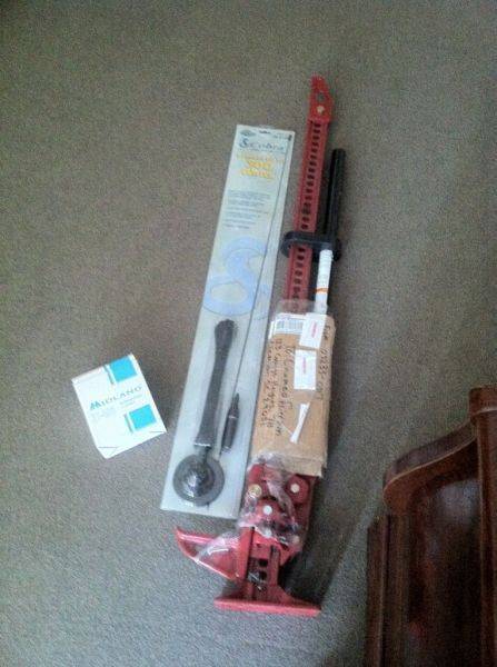

    Sold the UWS toolbox today, got my bed back haha :D
    got some toys starting to build up.
    Going to pick up my cb from walmart later today
    Stay tuned for more. :D
