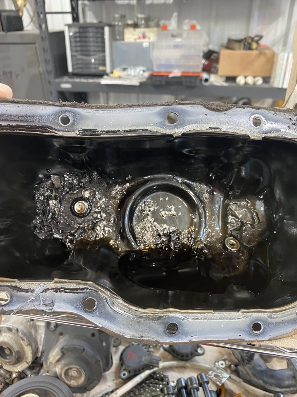

    That dealer owes you a salvage engine with equal or less mileage, plus a loaner truck, all on their dime.
    They admit to overfilling, with an obvious consequence being bearing failure. The crank beats on the oil entraining air to the point the oil film can't handle high load (rpm). Main and rod bearings make metal to metal contact, wipe, spin potentially, sending bearing glitter into the pan. By the time it's towed and the level checked all the air is gone again. Anyone that passed highschool auto tech knows that, let alone a certified tech.
    Ask them to prove it wrong, overfill a new Tacoma coming off the delivery trailer, then rev it to 5k for 30 seconds.

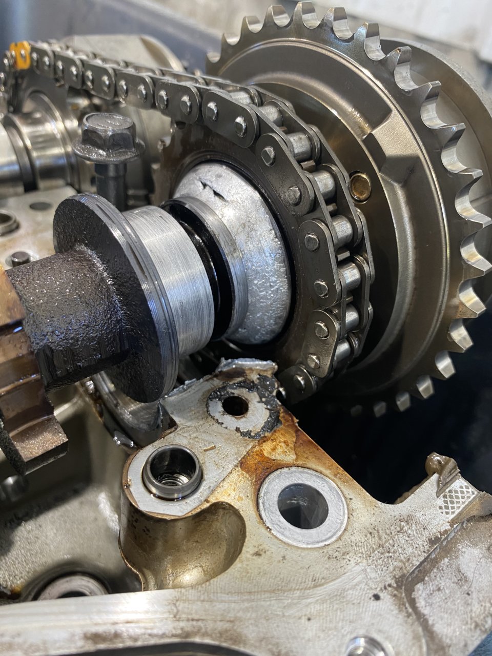

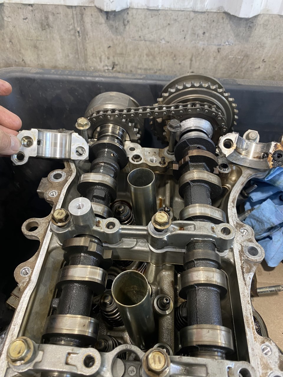

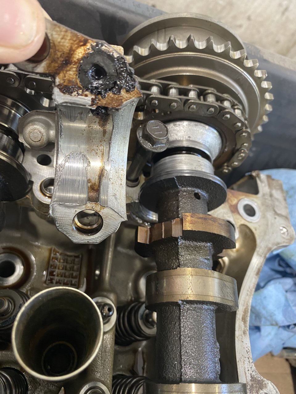

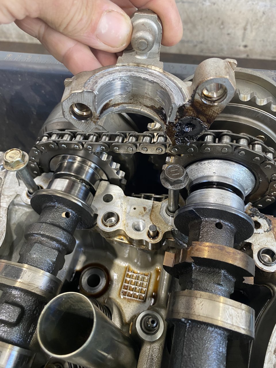

    So my mechanic got back to me today looks like a failure on #6 cylinder rod bearing..…. And spun a cam to top it all off. So it looks like, not only am I going to be rebuilding the motor….. but also the heads!!! Feel free to post links to badass shit….. I want to make this motor as good as it can be

    Cam failure pics

    :ohsnap:
    So uh....
    How's the 2GR max reliability build working out for you?
    :bananadead:
    In all seriousness, cause of failure known yet?
    Seems like the 2GR have seriously oil delivery issues.
