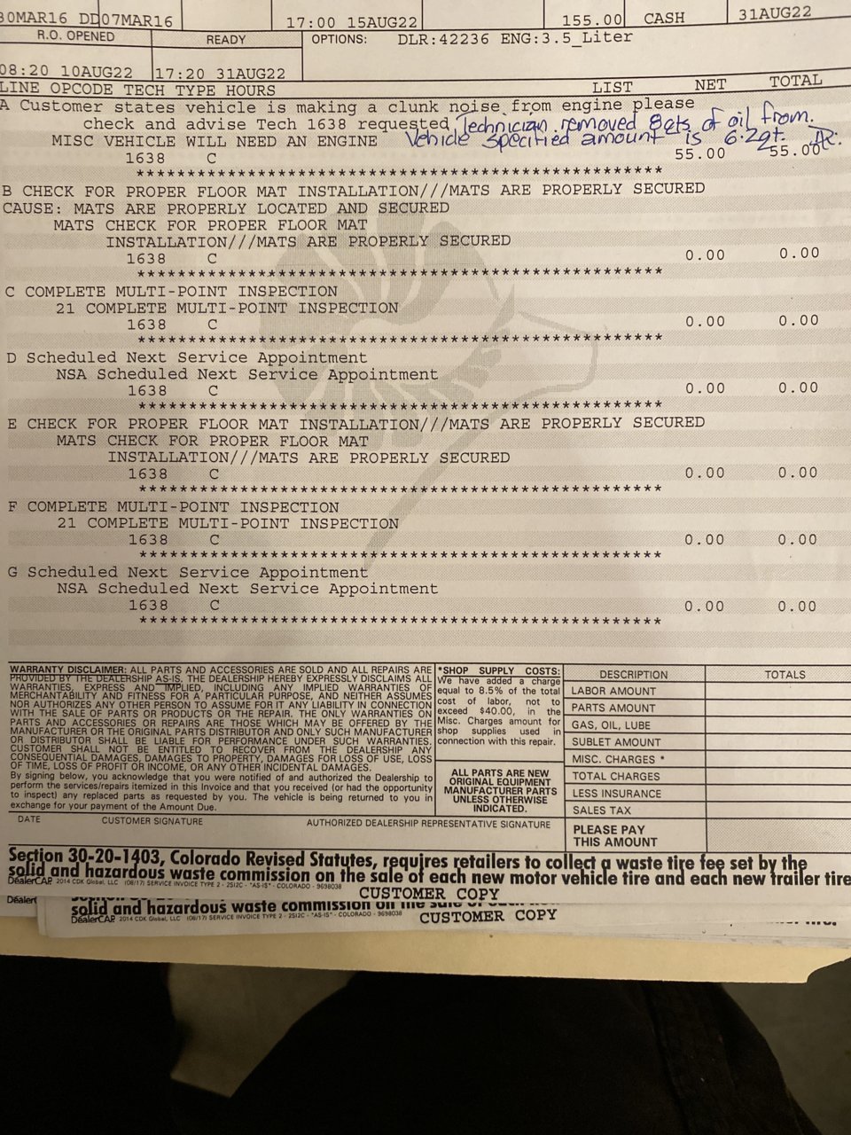

    Rod bearing failure on #6 piston causing oiling problem in head….. lack of oil transfer after bearing failure Causing camshaft damage….. That’s what’s been summarized thus far.
    as far as the build, Short block is being replaced, Magnuson Supercharger being added, Heads going out to be rebuilt and have the internals reworked, ported, & polished with Lexus titanium intake & exhaust valves.

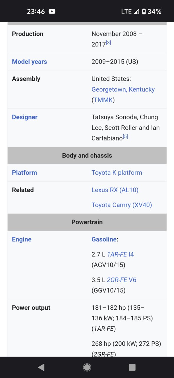

    Any of the bottom end factory forged?
    Also what's the skirts on the 2GR look like, seen some Toyota pistons and the skirts on them are so short it's a wonder they don't cock sideways every combustion cycle.
    Edit:
    Actually come to think of it I believe the reason I was seeing those pistons come through was because they did...
    I believe they were out of a couple different Venza V6's.
    Edit edit:
    Hey look at that they used the 2GR back then in the 1st gen, didn't know that but...
    It explains a lot...
