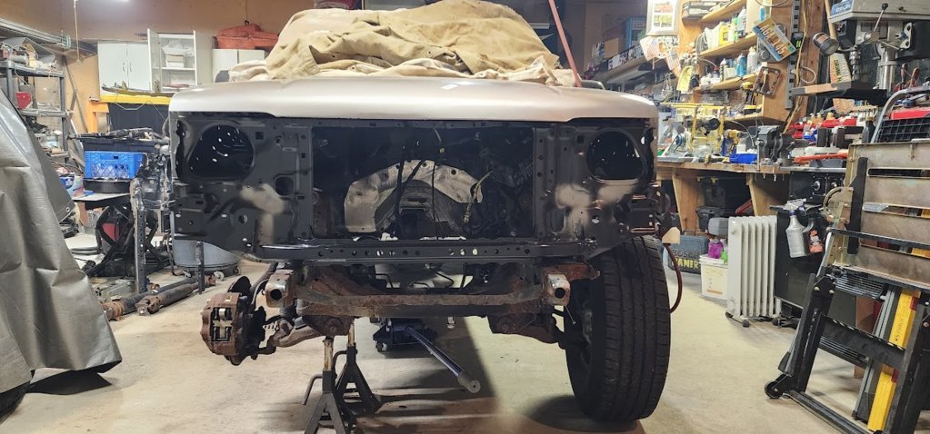

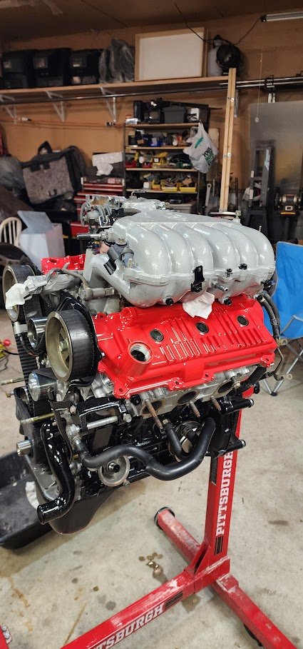

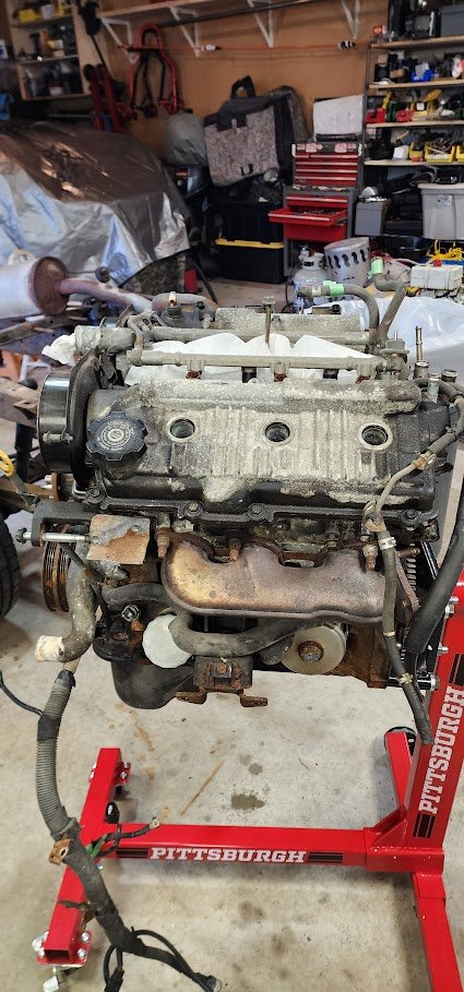

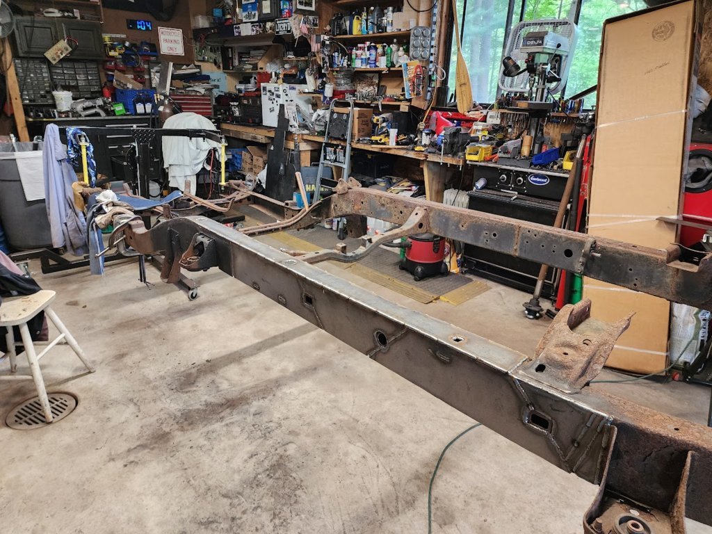

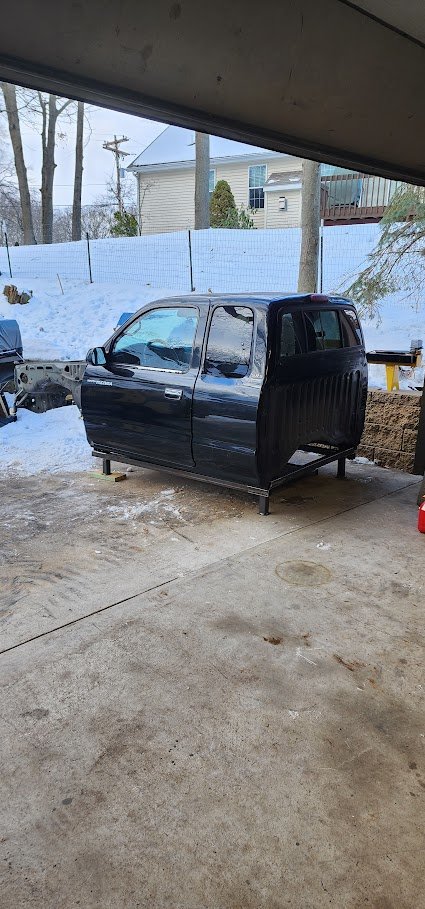

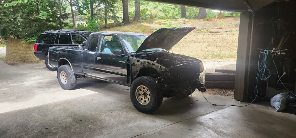

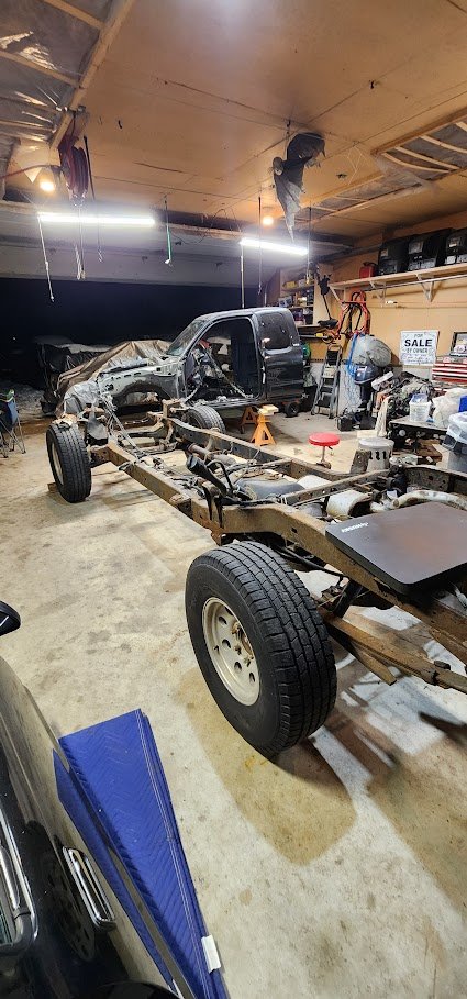

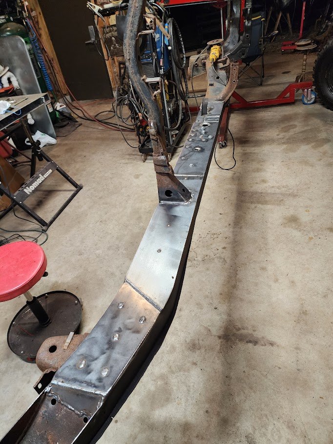

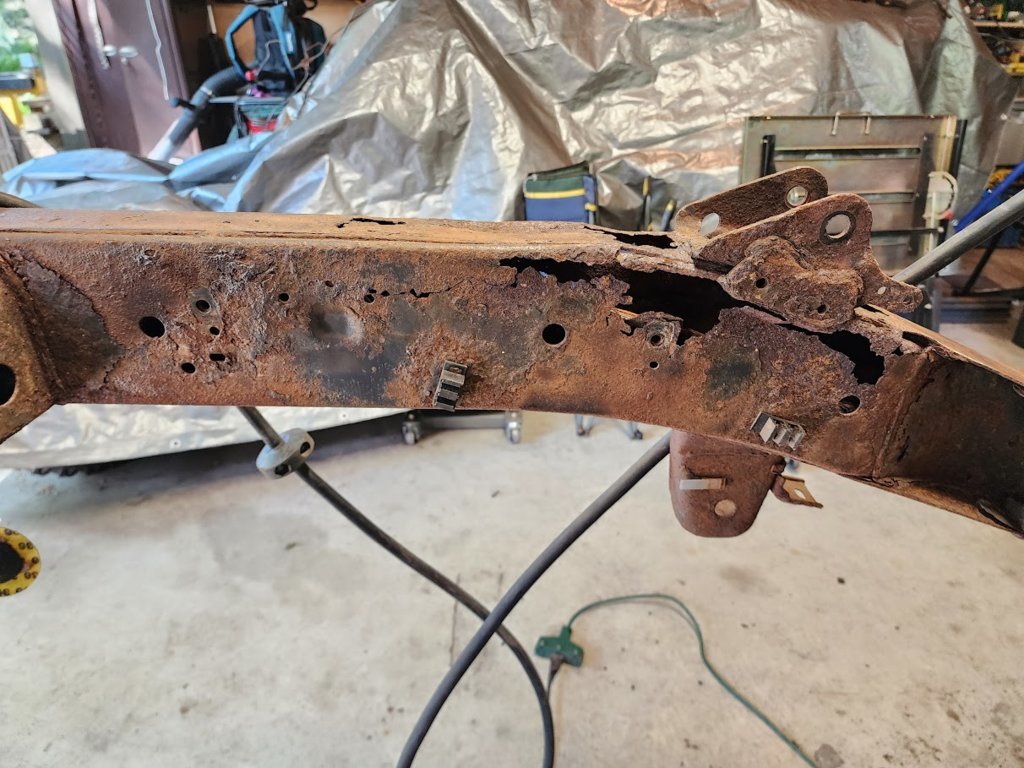

    Well, I didn't get into pics because I had a similar post I put in the last year with those pics and didn't want to be redundant
    but since you asked... I had to repair some bodywork first and then the rusted out frame.
    been working on it when I can for the last year.
    how I got it

    I guess I've done quite a bit, but until it starts going back together it's not very fun. Hopefully, I documented how everything came apart well enough. I have the factory service manual, but it's amazingly simple for a Japanese company. Nothing like my Suzuki and Honda motorcycle manuals.

    The truck rear ended someone on the passenger side. I thought it was all body damage until this week I found a little bend in the frame on the passenger side right where the sway bar mount is. So it won't be perfect unfortunately.

    I made the rotisserie just for this project. Then the baja bug is going on it next!
