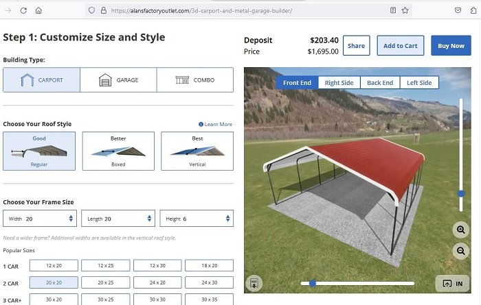

    I've built my share of garages/shops/barns, but for a simple carport, it is hard to beat the (relatively) inexpensive, zero-maintenance, metal carports available all over.
    A quick Google and here's an example of a 20x20 for $1700 (includes delivery and installation):
    Depending on your skill level, building something similar with materials found at the box store would be difficult (20' clear span would require trusses or large/heavy/expensive dimensional lumber (2x12)) and in the end, probably not save you any $$$.
    Nice looking lot. Good luck to you.
    HawkShot99 and atc250r like this.
  17. Apr 11, 2023 at 8:39 AM
    #17
    atc250r
    atc250r Recovering Ram Owner
    Sep 29, 2022
    #406909
    1,368
    John
    Orange County, NY
    2022 Tacoma SR5 - DC/LB
    LED interior, license plate, and fog lights. More to come.
    I'm willing to bet building one out of wood will be more expensive than the 20x20 steel one posted above.
