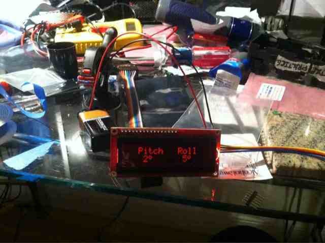

    Received my beta kit today and I assembled it. Assembly was REALLY easy, even for me having to customize the mounting of the sensor chip. Even without instructions, except for a few parts, I was able to put this together in 15-25 minutes from start to power up.
    The quality of this item is top-notch! Everything needed is supplied in anti-static packaging, as it should, and it was wrapped up nice and safe. The unit is very sturdy, very compact, and definitely something that will last a vehicle's lifetime!
    The screen is crisp and bright, and the navigation of the unit is pretty awesome! It's very simple to use and it's all you need in one small, easy to read package!

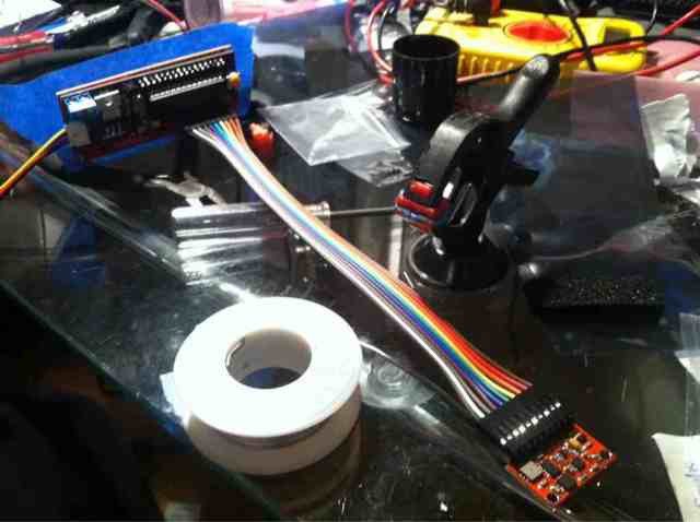

    Rob supplied me with a 10 pin ribbon cable in order to test the distance theory with the compass. That theory sorta worked. What worked better was :tinfoilhat:
    But though the compass reading is BETTER, it still isn't perfect unfortunately.
    And of course, the screen in bright conditions.

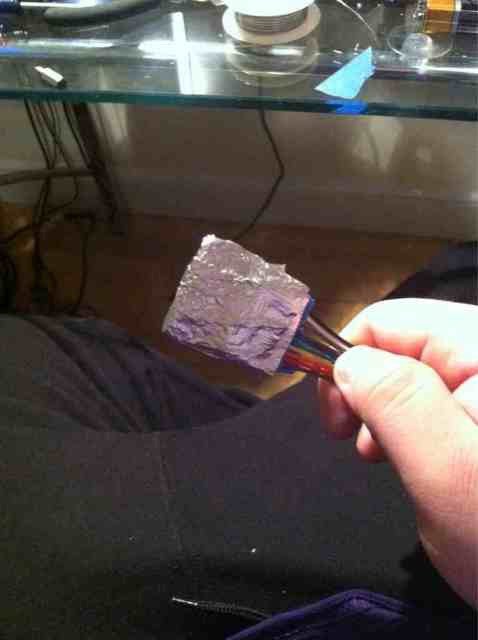

    I looks like you've shielded the sensor?
    I would think that the sensor would need to remain unshielded so it can sense the earth's magnetic field.
    Maybe try shielding the rest of the unit instead? No idea if that will work or not but it's a theory....

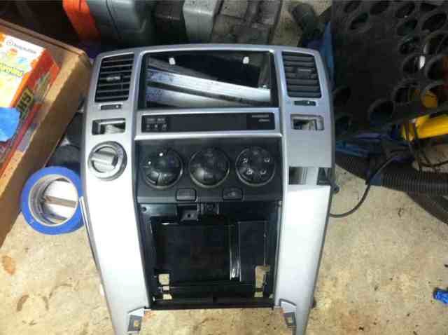

    Yep! Gonna be a lot of trimming but it'll be ok.
    Already started drilling holes. I'm 2 6/32" down from the button on either side, and that puts me just under a clip. I'll have to trim back some of the plastic on the dash opening but who cares about that? Haha

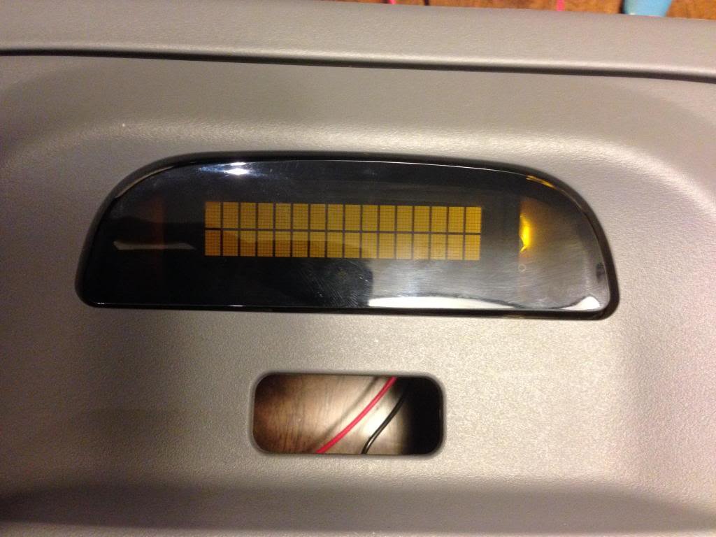

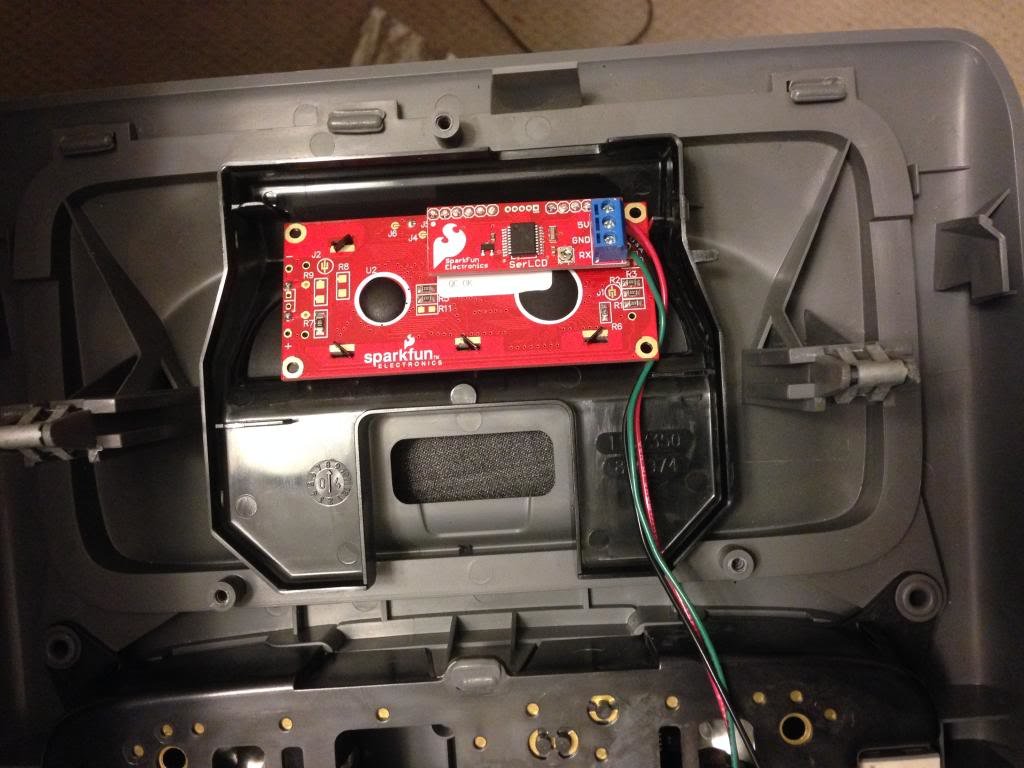

    Here's a little sneak-peak to keep you guys with the beta boards on your toes:
    Don't discard the idea of mounting it in the overhead console. It's worth noting you're all using the 5V screen which is mounted to a much larger LCD backboard, but if you purchased a 3.3V or one of the smaller 5V's (I think the OLED's are smaller to) they fit perfectly into the stock temp/compass sensor location for a flawless install.
    Still working on integrating the 3-way button into the stock button spot.
