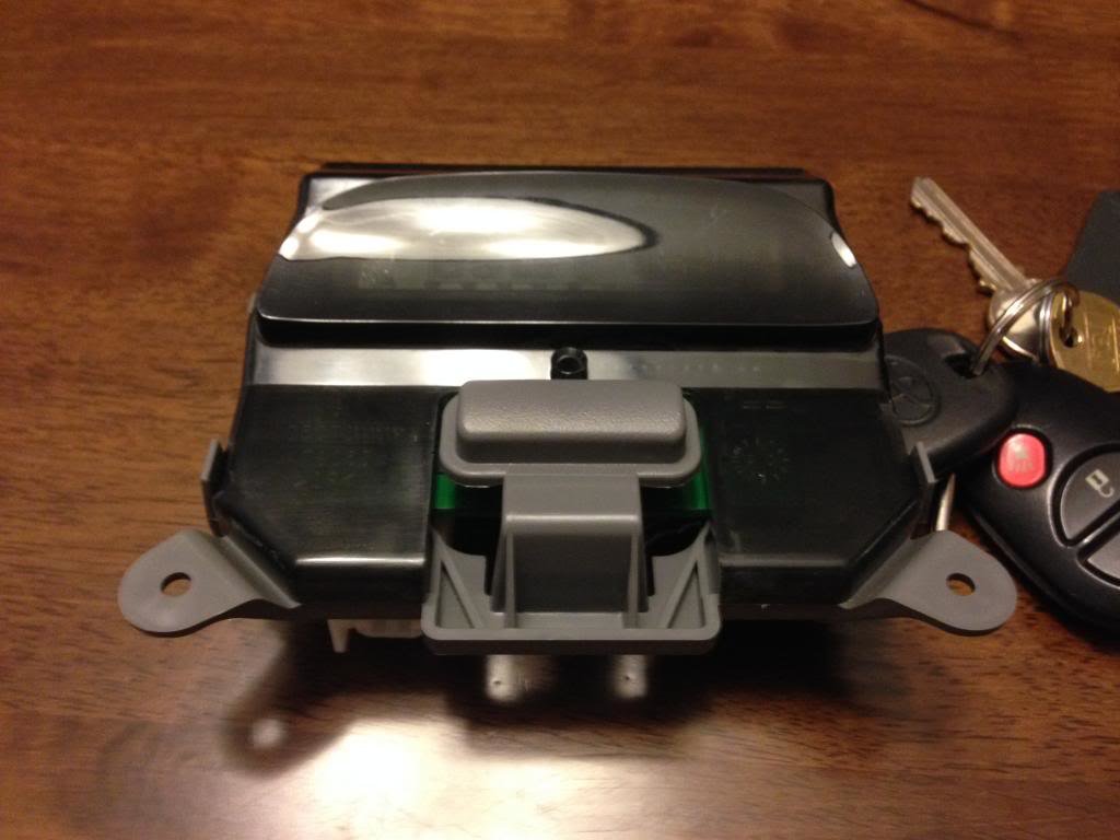

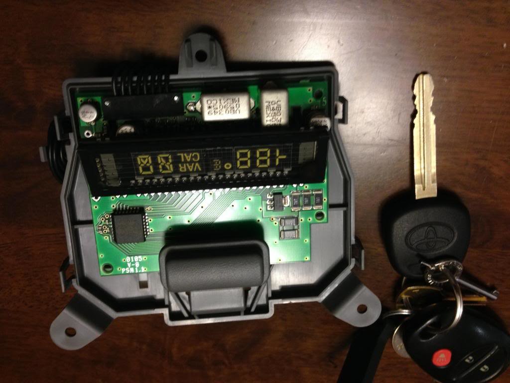

    I've ordered my parts for the build. Even shipping everything way up north my total came to 65$ including 3 sets of all small components (not boards).
    You can find the 9-axis sensor on eBay if you're willing to wait. (11$)
    (http://www.ebay.com/itm/271037780497?ssPageName=STRK:MEWNX:IT&_trksid=p3984.m1497.l2649)
    I'm basing my build on an Arduino Nano for smaller package size. OP's final printed board will probably be smaller than this, but I don't want to wait and my Uno is too large. (7$)
    http://www.ebay.com/itm/181188897618?ssPageName=STRK:MEWNX:IT&_trksid=p3984.m1497.l2649
    I've gone with a different LCD than OP. I want my finished package to fit inside the stock temp/compass display. The 5V LCD OP chose is too long to fit, so i've gone with an amber 3V version with a serial enabled backpack. It should fit - just barely. (25$)
    https://www.sparkfun.com/products/9069
    I'll be trying to use the stock temperature sensor to display outside temperature as well as all the other goodies, but we'll see how that goes. My coding isn't even half decent.
    My components won't arrive until the end of November :( , but i'll build my 3.3 and 5V regulators and fit the LCD in the meantime. I hope to squeeze the entire package in the same space as the stock temp sensor display, but if that's too tight i'll mount the LCD there and run the comm wires through to my sunglasses holder where the board would sit.
    Stock board: (keys for size)
