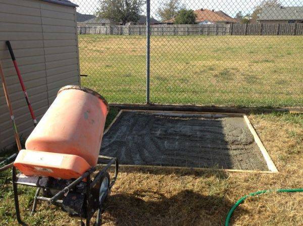

    This is just a slab for my shed to go on. Poured it 1/2 regular quikcrete and 1/2 Pro Finish Crack resistant. The mixer saved my butt... .6cu yds of the stuff woulda been hell to mix any other way.
    I'm a dummy and forgot the before photos. Just think grass and fence. And then think 6 inch 85"x85" hole...Then think 2 inches of drainage rock and the form.
    Thanks for the inspiration!!! I might try an outdoor fireplace in the spring....Seeing how easy this slab was to lay...

    Looks good, looks like you used the same type of remesh that I did?
    I'm not gonna lie though, the slab was the easiest part of the project.

    Yeah..That was the 84x48 cut remesh from Home Depot.
    This slab had me worried...Looking at the pile of 28 bags of concrete-I was like "WTF have I gotten myself into..."
