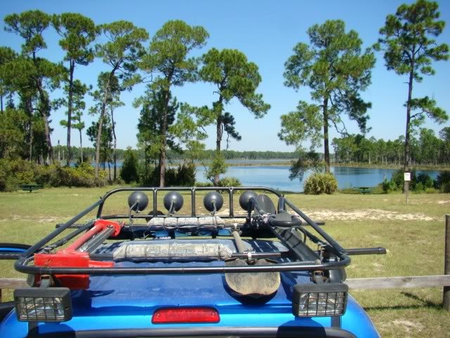

    i'm actually using just the generic $40 lights from the autoparts store....but put a set of 5000k 55w hids in there and those puppies really light up. the four ballasts to the hids are hidden behind the fairing to the thule rack. hi-lifts are pretty heavy, so i don't know if i'd mount it on that speciffic part. you may want to take some larger diameter tubing (1 inch perhaps) and make crossbars that ling the mounts from one side to the other. this would also give the overall rack/mount system a much stronger structure.
    i secured mine to the thule crossbars, but you could essentially jsut make your own. theorey being, if you have it bilted to the diagonal bar, only one piece is supporting it, and it endures a lot of bending forces. turning, stoping/acceleratin, and boucing wll want to bend it since it's the bar itsself is not along any of those planes. if you were to mount it to cross bars, you have two bars supporting any load, and there will be much less torque placed on other pieces do to it's position. sorry, that was kinda confusing.
    her's a picture of how my hi-lift's mounded. essentialy, replace my thule bars with 1 inch tubing.

    dug up a photo from a few years ago, the ones on the bull bar are the ones in the link i posted above. at this point they still had the stock 55w halogen bumbs in them. the ones on the roof in the picture are what are now the rear lights on my light rack
