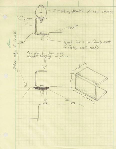

    Any insight on how to mount? i have no roof rack, no preexisting holes, the roof is just straight clean metal, I'd prefer not to drill into the roof but I will if need be, any suggestions?

    Jay, i drew up a little design for another member on here on how to potentially mount something like this withough an existing roof rack. if you have that black weatherstripping running the length of your roof, there should be holes under it that you can use. if not, you can use this same method but drill your own.
    if neither of those options is doable, your only option is do buy some sort of clamp on rack, in which case, i'd go with yakima or thule. the cheap ones just don't hold up as well, and i've seen them tear appart door seals, whereas my thule has been on for 3 years and there is no damage whatsoever.
    here's the drawing

    Thanks Colin, I did see this and planned on using it if there was no other option, but I'd rather drill into the roof and keep it secure. So I guess I will use this method, thanks a bunch man, I will make sure I credit you/post some pics when I'm done.
