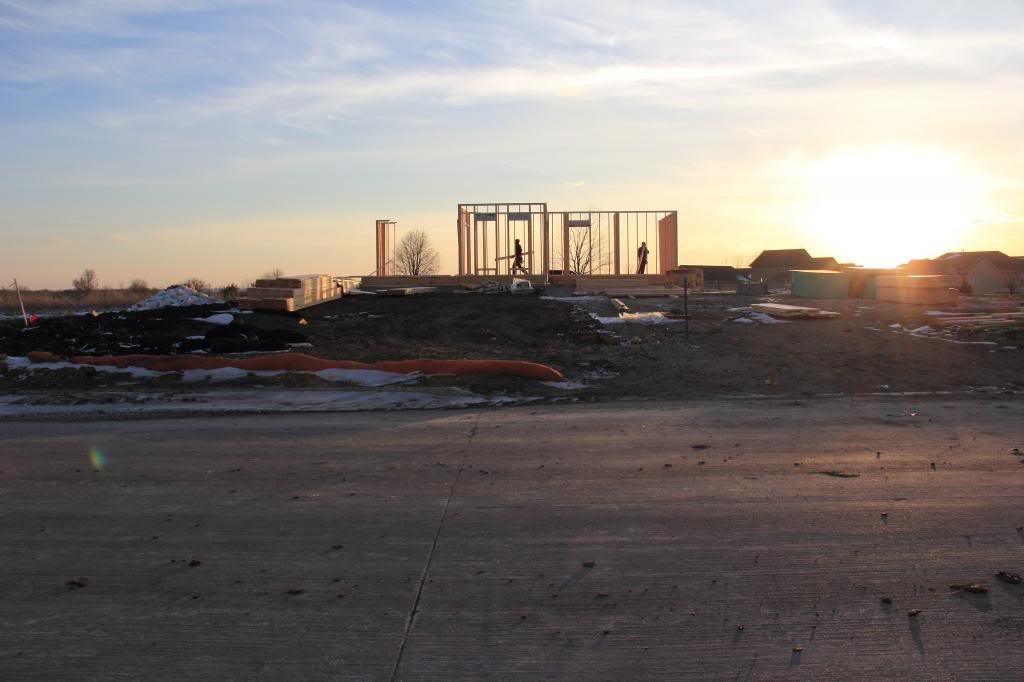

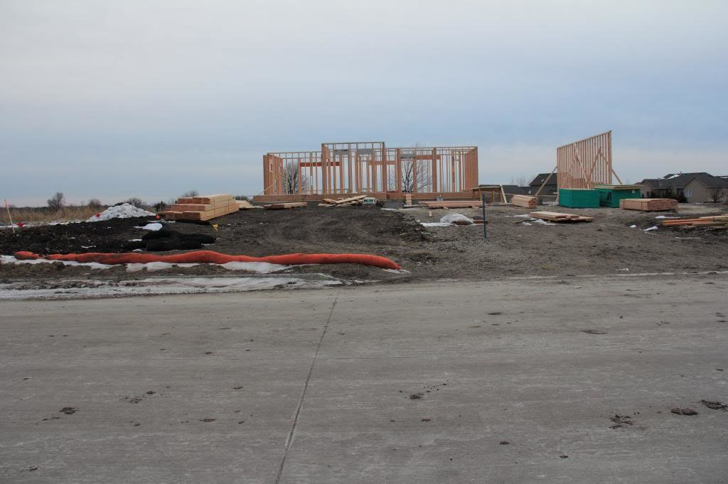

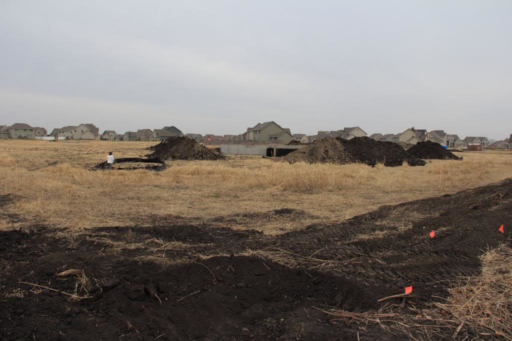

    This will be my build thread for my new house. Pics coming soon.
    Looking from the back corner of our property

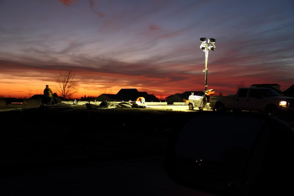

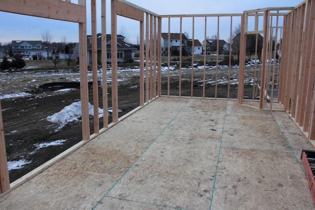

    Working under the lights
    A look into the kitchen from the Living room
    A look into the living room from the kitchen
    Garage going up. Only one problem. the garage doors are only 7', supposed to be 8' tall.

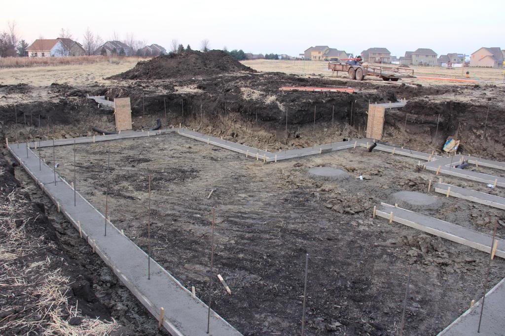

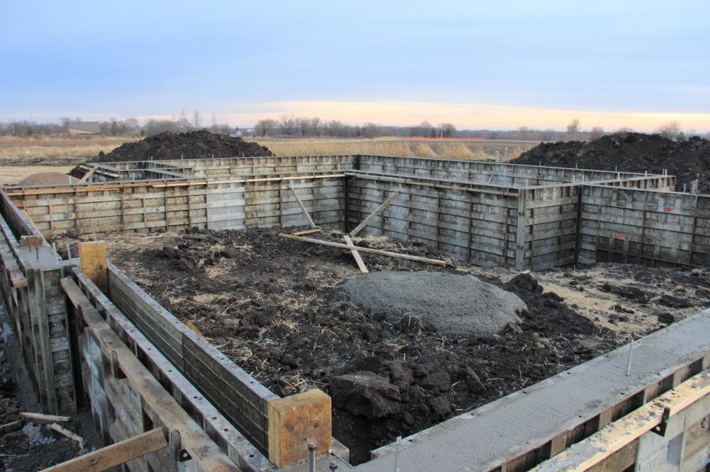

    4' centres on the vertical rebar
    Not a seismic concern in the world , lol

    those are anchor bolts not rebar....48" oc is pretty common

    You're telling me these are anchor bolts into the footings ?

    Maybe she was looking at other pic? Your pic is rebar.

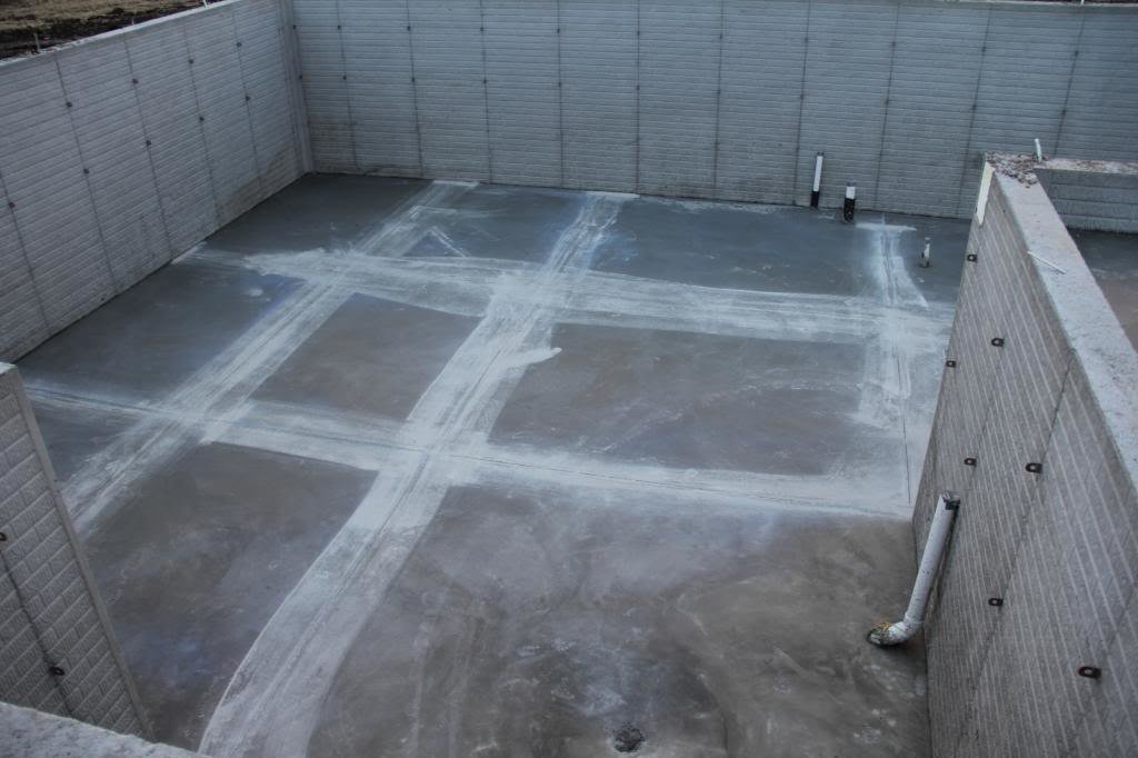

    I was looking at the last pic... :eek:

    I agree , my comment wasn't clear

    Not here in Cali. I would have 16" OC verts, with 12" OC horz #6 min if its a poured wall, if a block wall every other cell with #6 verts and #6 horz every third row and fill the cells with 5k psi. But thats just me, I tend to over build everything if its my own. :cool:

    I'm on my computer now and can actually see the pics better
    are the anchors in the walls ( besides the ones by the garage door ) straps ?
    why are the bolts so far out of the concrete , is there tie down hardware going in these locations or is it a local code requirement ?
