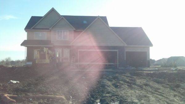

    Almost done with the siding. Only took 3 stinking weeks.

    What is it ? Hard to tell from the pic .
    Horizontal clapboards ?
  10. Mar 21, 2013 at 6:46 PM
    #210
    krap22
    krap22 [OP] Well-Known Member
    Mar 20, 2011
    #53389
    21,287
    Hardy plank cement board with cement board shakes in the peaks.

    3 weeks isn't bad
    What about soffit ?
  13. Mar 21, 2013 at 6:53 PM
    #213
    scocar
    scocar hypotenoper
    Nov 11, 2009
    #25814
    40,037
    What about jump on that Pettibone and take a joyride.
  14. Mar 21, 2013 at 6:58 PM
    #214
    krap22
    Mar 20, 2011
    #53389
    21,287
    They can normally side the house in just over a week.
    Soffit I'm not sure on.

    Guess it depends on how many guys are installing it .
    Do you have a requirement for a rainscreen under the siding there ?
  16. Mar 21, 2013 at 7:13 PM
    #216
    krap22
    Mar 20, 2011
    #53389
    21,287
    Not sure if there is a requirement, but that is what the envirodri spray on membrane is for.
  17. Mar 21, 2013 at 7:17 PM
    #217
    OZ-T
    OZ-T I hate my neighbour
    Dec 15, 2009
    #27584
    50,587
    Peter North
    British Columbia
    That's not a rainscreen , that's a waterproof menbrane / air barrier
    A rainscreen provides a drained cavity ( our code is 10mm or 3/8" ) between the housewrap / building paper and the back of the siding
  18. Mar 21, 2013 at 7:18 PM
    #218
    krap22
    Mar 20, 2011
    #53389
    21,287
    Then no, all seams are caulked with an aluminum flashing behind them.
