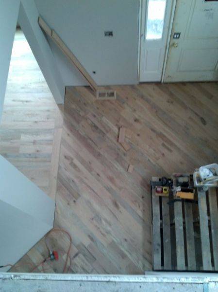

  11. Apr 15, 2013 at 7:15 PM
    #291
    krap22
    krap22 [OP] Well-Known Member
    Mar 20, 2011
    #53389
    21,287
  12. Apr 15, 2013 at 7:51 PM
    #292
    OZ-T
    OZ-T I hate my neighbour
    Dec 15, 2009
    #27584
    50,587
    Peter North
    British Columbia
    Looks good Merde

  14. Apr 19, 2013 at 6:18 PM
    #294
    SOSHeloPilot
    SOSHeloPilot My 1st Muscle Car
    Mar 31, 2009
    #15422
    6,780
    S.E USA & S.E. Asia too
    2024 4Runner SR5
    Missing My Last Tacoma --- Had 11 Toyota trucks in the past and many other Toyota cars too.
    ... ^^^ ... I like that nailed at at angle. Perhaps that would also help to hide "out of square" rooms too. ... :confused: ... :D
  15. Apr 19, 2013 at 7:33 PM
    #295
    krap22
    Mar 20, 2011
    #53389
    21,287
    It might help to hide an out of square room, but we found out that nearly the entire house was square. All 45*angles were actually 45*. It was pretty amazing.

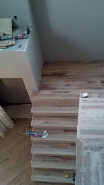

  16. Apr 21, 2013 at 5:40 PM
    #296
    krap22
    Mar 20, 2011
    #53389
    21,287
  17. Apr 21, 2013 at 10:21 PM
    #297
    scocar
    scocar Patron of the Farts
    Nov 11, 2009
    #25814
    40,171
    Adam, I can't wait to see these floors with a finish on them. For the rest of your years, you are going to be walking around your house with your head down, and people won't realize that it's because you're happy.

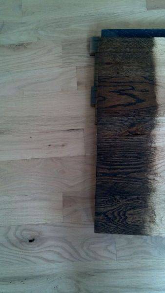

  18. Apr 22, 2013 at 6:37 AM
    #298
    krap22
    Mar 20, 2011
    #53389
    21,287
    I'm always staring at the floor when i walk through the house. Here is the color we are going for. It make it darker, but still lets some of the character show through. Its a crappy cell phone pic, but still shows what i'm talking about.

  20. Apr 22, 2013 at 7:36 AM
    #300
    oldtacomaguy
    oldtacomaguy four forty four
    Dec 11, 2006
    #444
    10,032
    Dave
    SE Conn.
    08 SR-5 4WD Impulse Red Pearl
    Alpine deck and amp, Polk speakers front and rear, Kenwood subwoofer, windows tinted to 20%, Sockmonkey decals, TSB, Eibach springs and Bilstein 5100's
    Park-O, floors look outstanding!
