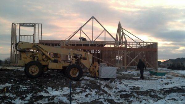

  13. Feb 4, 2013 at 3:58 PM

    Single top plates ?

    . . . ^^^ . . . B R R R . . . Man . . that photo just looks cold . . . :eek:

    No, they're double
    Yeah it has been chilly. They didn't work 3 days last week because we got 6" of snow the it was a high of 5* the next two days.

    What is the reasoning behind not sheeting the front wall ? Is there a stacked gable above ?

    They haven't gotten to it yet, there is also a roof line that goes across the front below the big window.
