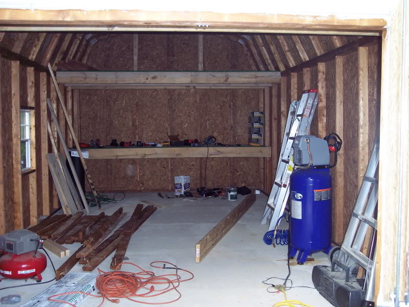

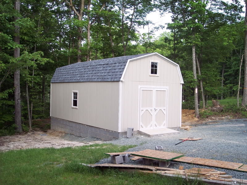

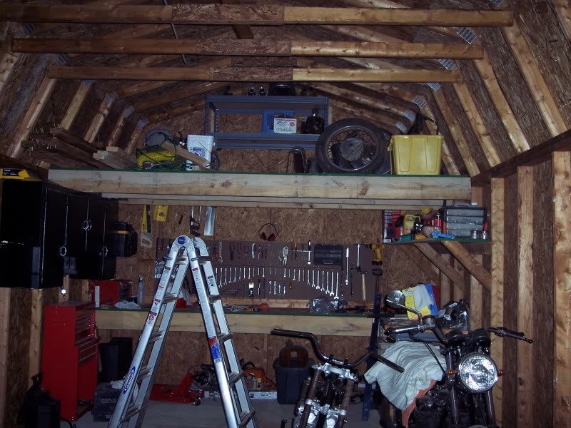

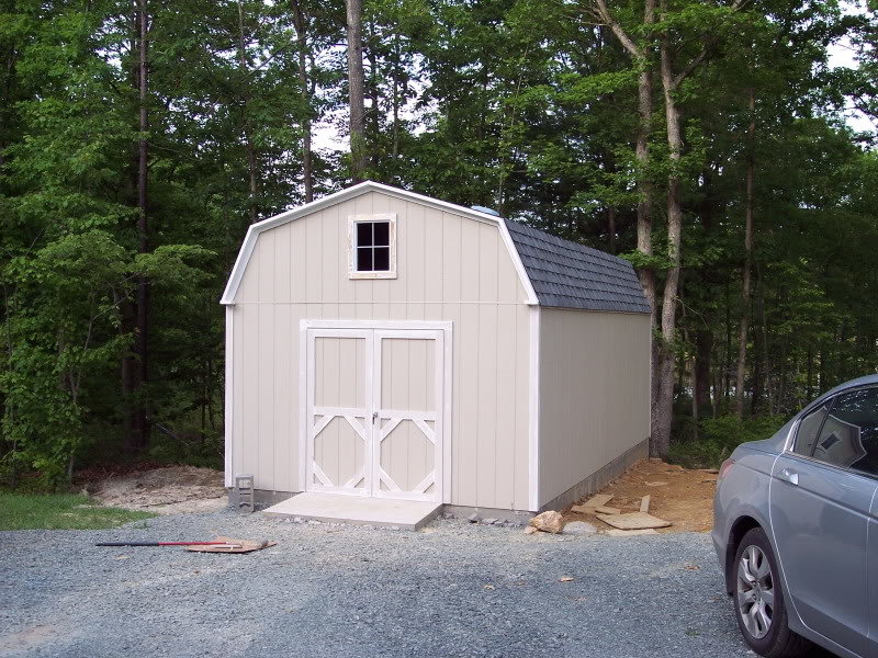

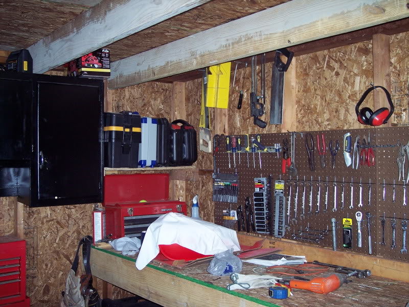

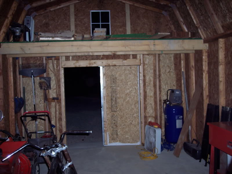

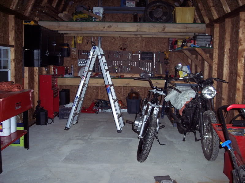

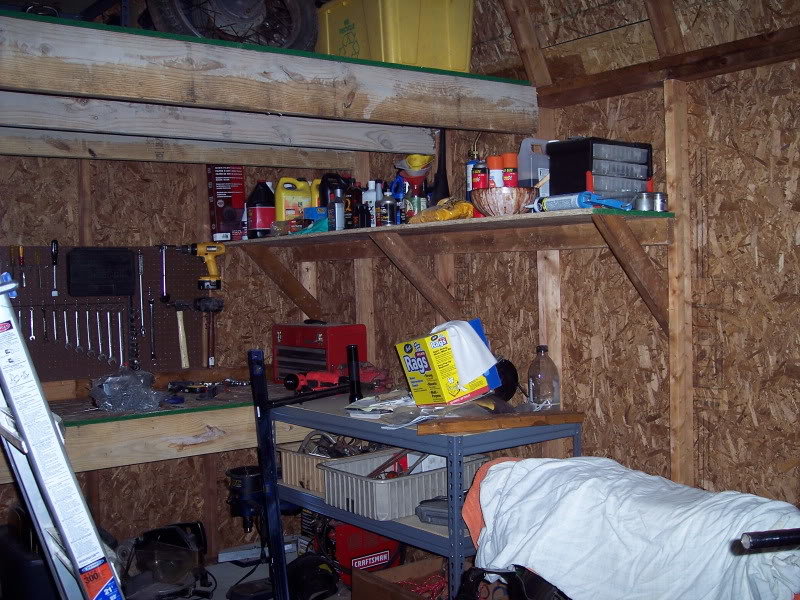

    It's official... I now have a new shop. The trim still needs to be painted and I've got plenty of organization to get done but it's functional and I'm damn happy. Here's the updated pics.
    Here's what the inside looked like before I got started today with moving stuff in.
    And here's after about 85% of the stuff was moved in.
    Complete with shelves on the rear loft for parts.
    Bench (right and left)
    Front loft
