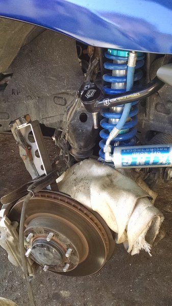

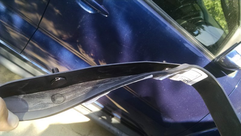

    A money saving tip. So if you have a Sport and want to install a Pelfrey gas skid you're going to have to pick up the straps made for the Off Road which have the 2 studs required for the skid. Each one is $75 (price @ my local dealer). Orrrrr.... Learn from my mistake of purchasing the OR straps, save $150 bucks and drill out holes on your sport straps and install carriage bolts and a washer. They're going to work just the same.

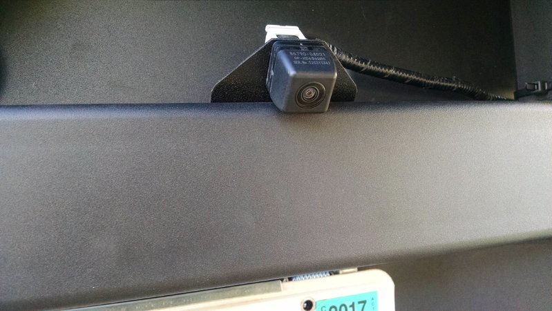

    Nothing too fancy but a mod nonetheless. Camera relocation went in today. Wires snipped, extensions connected, heat shrunk. Lights, camera, action!!
    I'll be welding the exposed harness you see cleanly with electrical tape. Haha

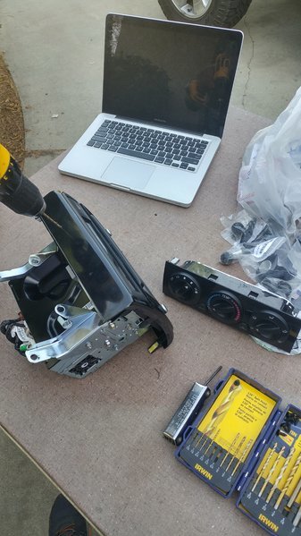

    A little navigation mount mod. Installed the tech deck extreme. Shake down test coming this weekend on the Mojave Road
