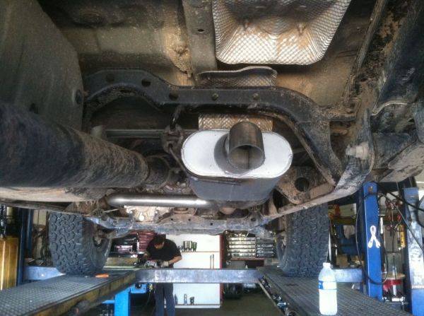

    How's the exhaust fumes with it exiting under the truck, do you smell or notice it more while wheeling or stuck in traffic?
    Been thnking of chopping mine but I'm a little worried about having it under the cab.

    It actually dumps right at the rear of the cab, between the bed and cab. I haven't experienced fumes or exhaust smells in the cab at all. The beauty is you can always have the exhaust shop extend the dump pipe if you have any problems.

    ^^ That's true. Thanks.
