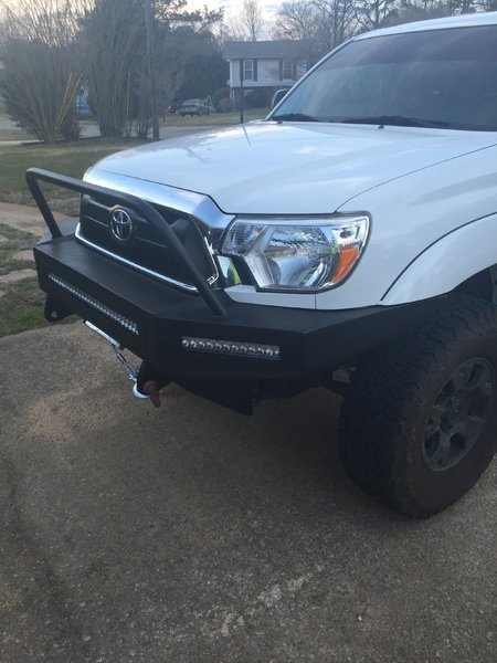

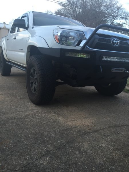

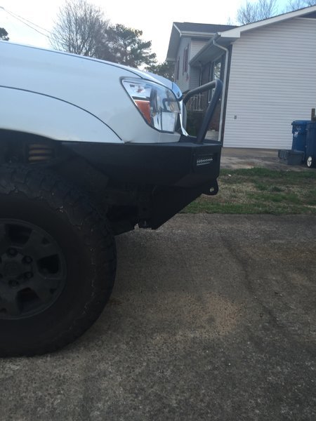

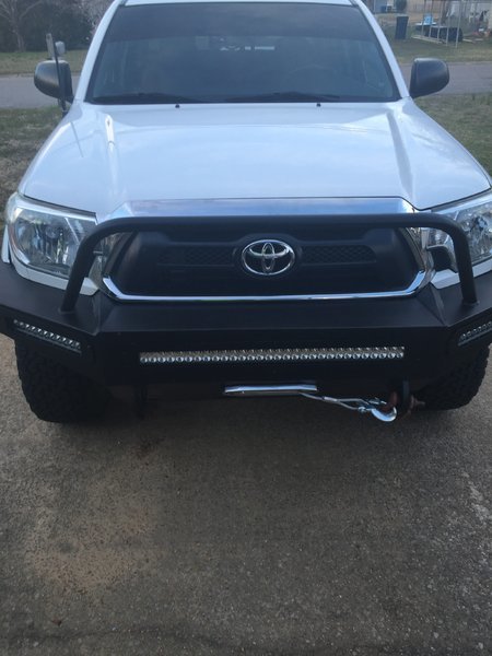

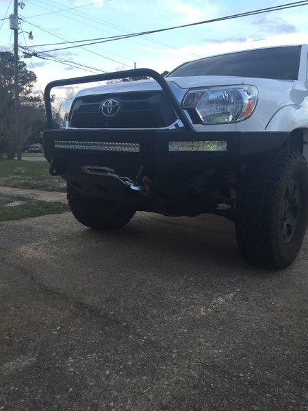

    Sir I'm not sure that manufacturing bumpers is something I have time for honestly. And considering that the bumper is made completely out of 3/16" steel instead of 1/8" the winch access is on the driver side for controlling the free spool lever there is a door with pins on it that you pull to access it. And the light bars are mounted using my design where they are flush mount but are installed after the bumper is already on with security pan head machine screws and the plate is drilled and tapped for them. I could give you a price but this is not my full time job.

    Looks good. Any pictures of the light output? I'm curious to see the spread with the side-angles lights.
