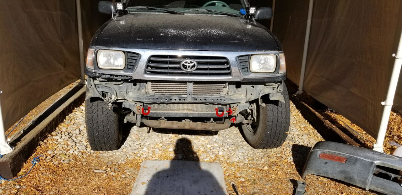

    Hi guys, I'm planning to build a bumper for my tacoma
    Photoshop mockup
    and was wondering how I should mount it. I was planning on running a piece of 3/16 angle in between the frame rails bolted on the front and bottom of the frame. Then I realized that I wouldn't be able to unbolt it unless I had a hole in the bumper. I want the base of the bumper as strong as possible and have very few welds in between the frame and recovery shackles just for peace of mind.
    How are bumpers normally mounted?

    Do I just use the stock mounting points on the side? They don't seem strong enough, or am I just overthinking it?

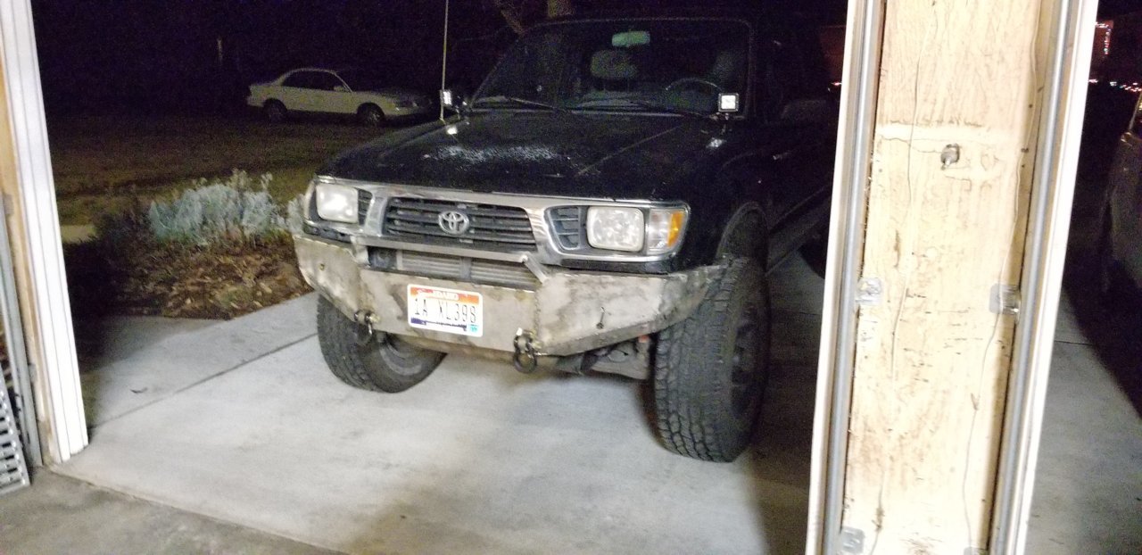

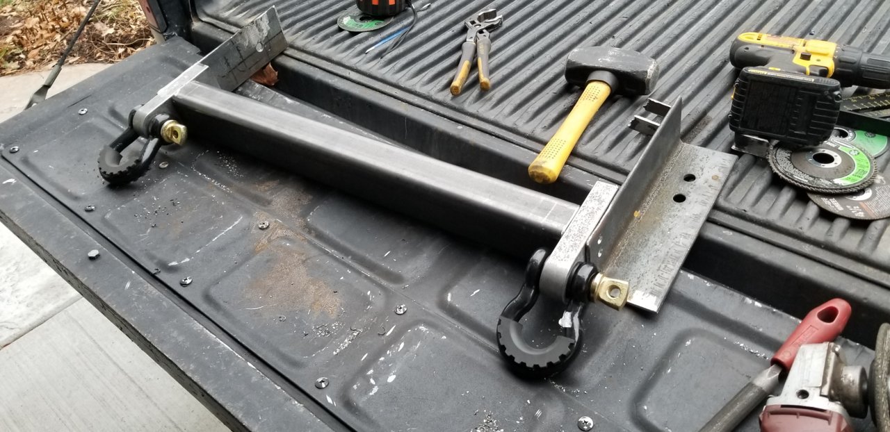

    That's a cool idea
    I went with a similar method. Using the bottom frame bolts for the main strength
    With some tabs to tie in the stock bumper mounts to strengthen the wings
