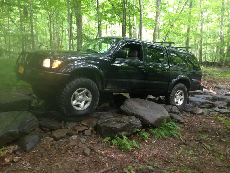

    from OEX earlier this year. Dry creek crossing.

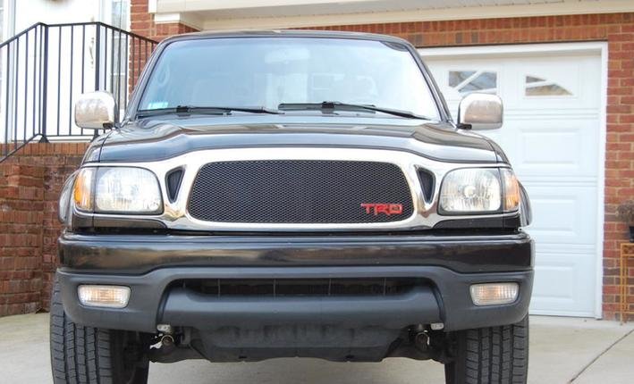

    need some opinions or ideas. I got this 20" rigid light bar for a good deal. For my front set up I am considering:
    1.) relocate winch box inside the engine compartment. Mount my D2s upside down on the top of my arb and the 20" light bar in place of the winch box
    2.) get an MX style grill insert, put the light bar behind the grill and leave the rest as is.
    don't really have time for the satoshi thing….
    here is pic of the mx grill insert i found on the web and my current setup
    thoughts? ideas?

    decided on mounting the light bar to the bumper not inside the grill. ordered everything from rigid and should see it monday.

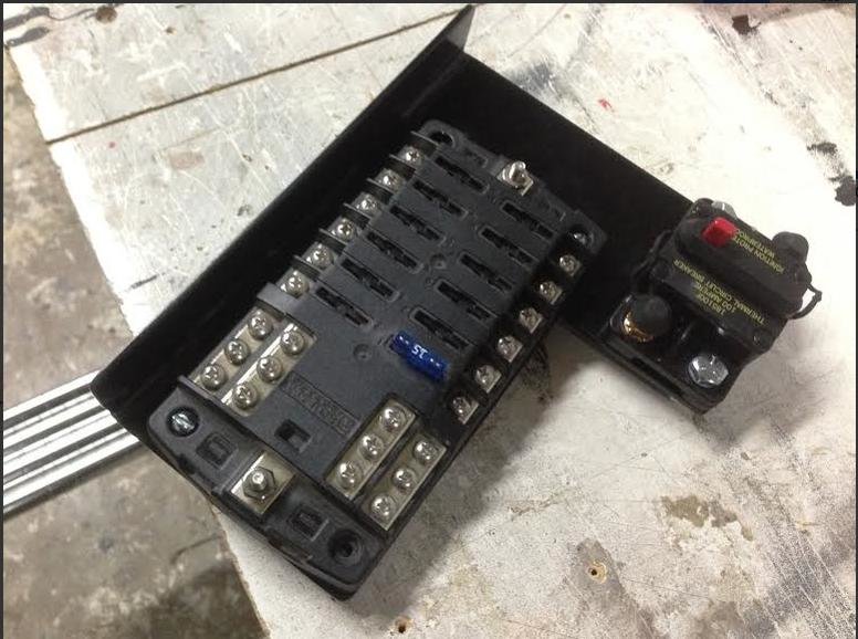

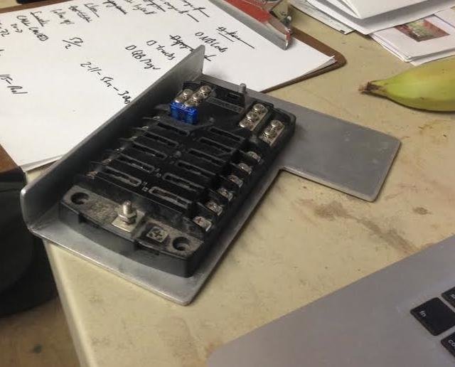

    had this little plate made up. just waiting on a bunch of custom cables for rerouting my winch solenoid and a 100 amp fuse.

    should have it in and all wired up tomorrow.
    still waiting on new winch power cables to show up.
