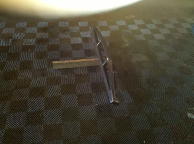

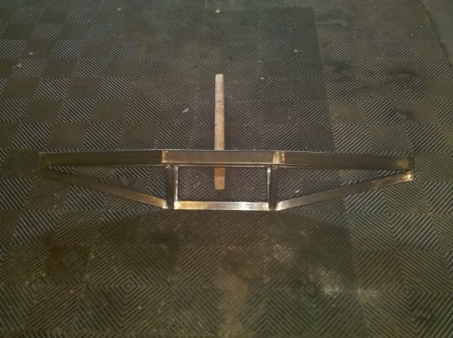

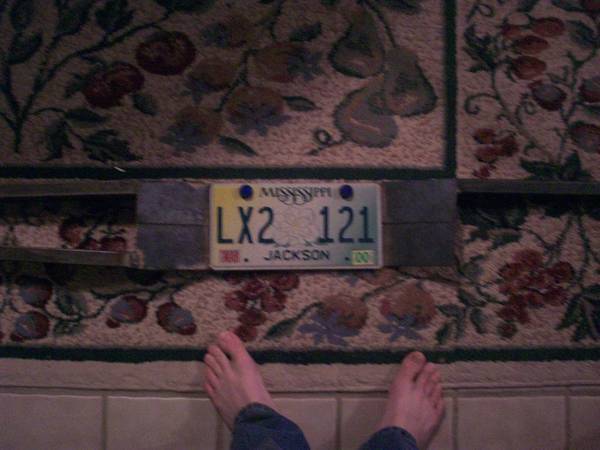

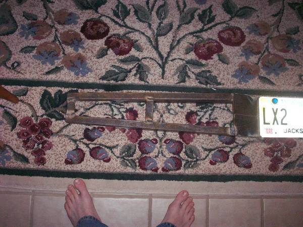

    Let me know what you guys think. Its still a work in progress, but i figured id see what i could come up with. Im about halfway finished with the body of the bumper, then im planning on making mounts out of 3/8 and attaching d-rings straight onto the mounts, so that my welds wont have to take the stress of winching. Is 3/8 enough. Like i said its just a work in progress but tell me what you think!
    sorry about my feet!

    Dude. Really hard to tell. Is it gonna be an open tube design? Might be cool

    yes it will be open tube and eventually have wrap arounds. What is really hard to tell?

    looks something like what I am working on.
    Was going for something alittle different so went with rectangular tube also. Changed mine since pics but havent finished mounts and hitch either.

    oh yea I was only plannin on using 1/4 plate for my brackets but also have it go under the frame like my hitch did.

    im planning on just using the factory mounts and maybe beefing them up a bit. Would 1/4 be strong enough?
