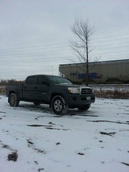

    got some updated pictures and some news. Recently sold the Avid light bar, as well as the hella lights. Ordered a Reletless front and rear bumper (steel). Got a while till i get them, but i am pretty excited.
    Went out to get the truck a little dirty, and get some pictures that arent in the driveway:rolleyes:.
    Also found these and picked them up. Figured they may come in handy on those weekend trips ;)
    Think i may just build a carrier out of square tube and mount it to the bed rail. Should be solid i hope lol.

    Trucks looking good dude! Where did you find those Nato cans at? I want! :D
    Good idea going with a steel front bumper as well. I'm sooo looking forward to seeing those Relentless bumpers on your truck in person. Got a year wait for that? :p
