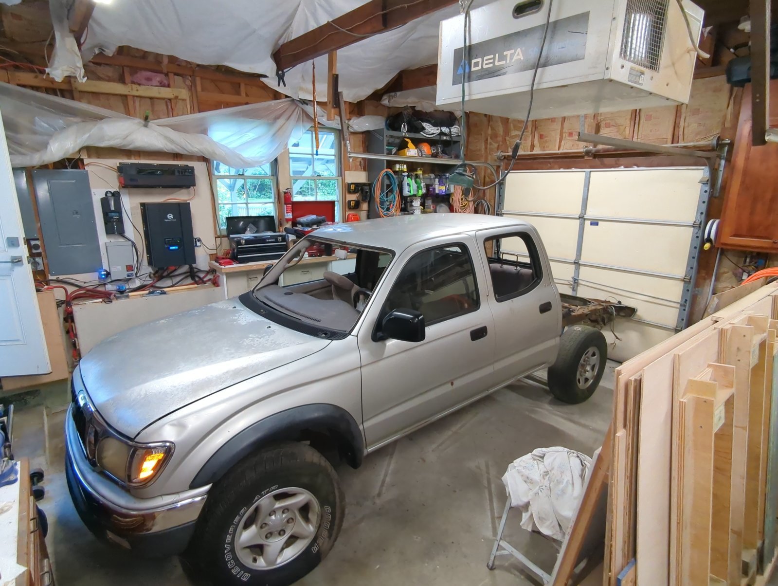

    Here is the truck. Mileage on the dash show 149k

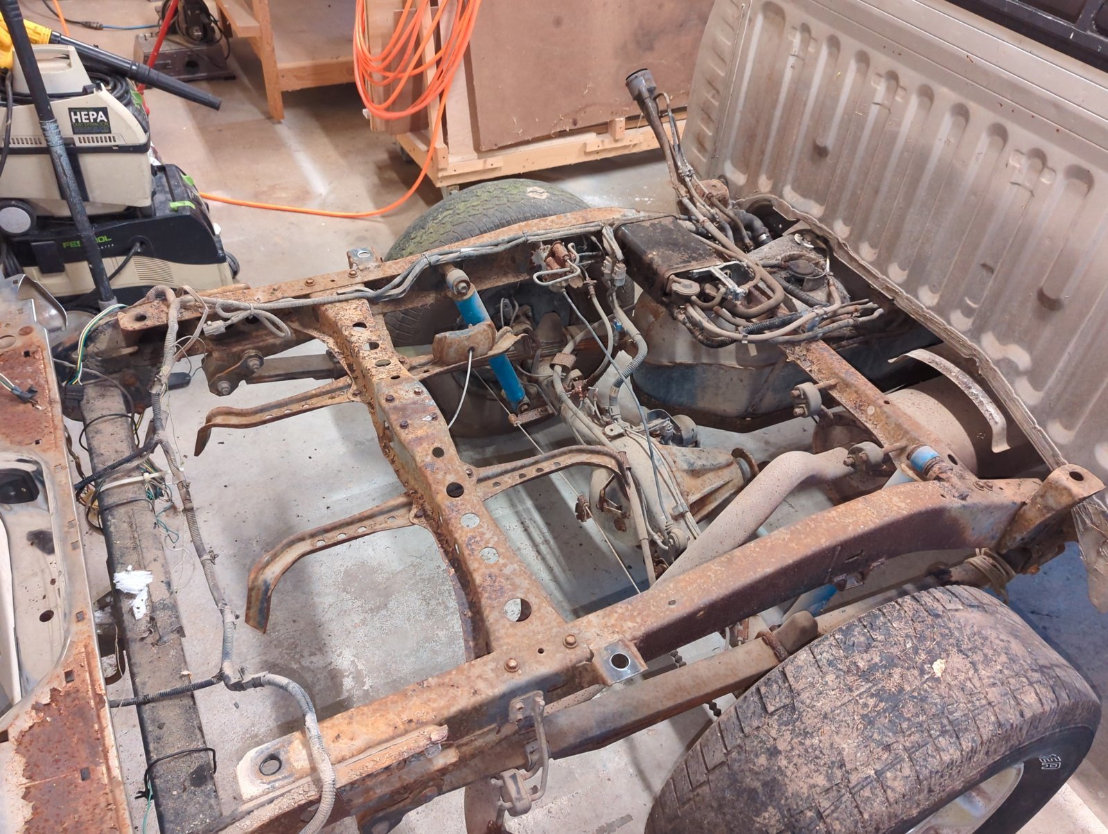

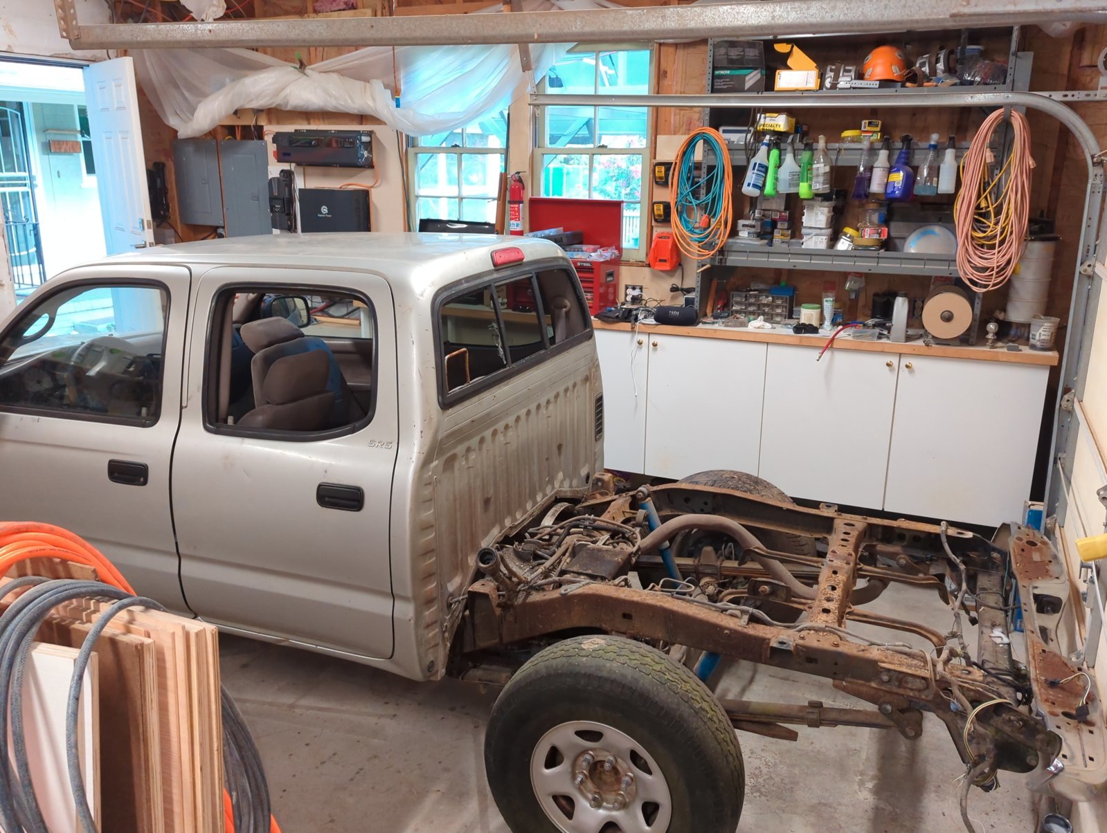

    I finally got the truck home. I aired up the two flat tires and then took the bed off. I figured it would make flushing the tank easier and I can also get a real look at the frame and its condition. It was late but I did notice that the shift linkages are all disco'd so maybe that's why the starter won't engage. It doesn't know its in park. I'm hopeful anyways. I'll pick up a battery today.

    there does not appear to be much or any of the Black frame coating left on that rear section
    where does it disappear to on these?, does it just blow off in the wind? maybe its just dirt :notsure:

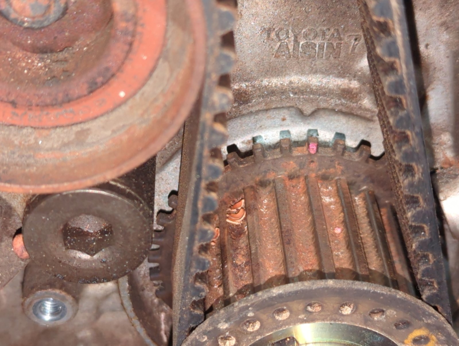

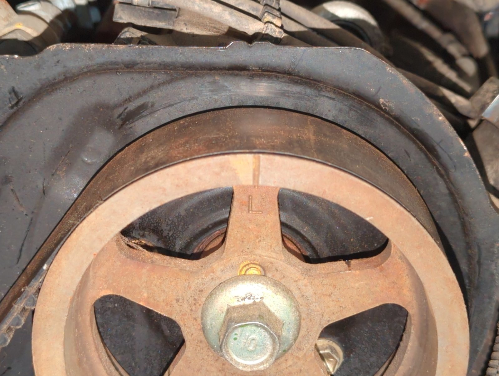

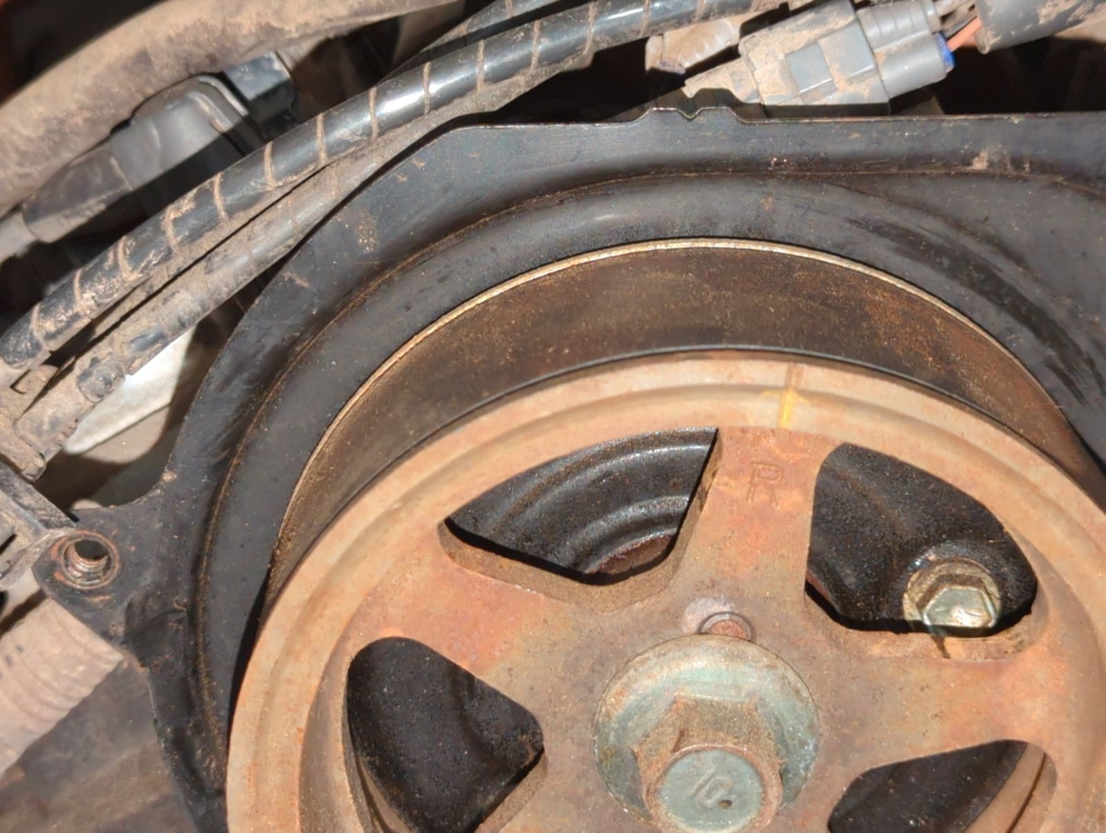

    My timing belt kit showed up so I started on that this evening. I noticed when the crank gear mark is lined up the drivers side head lines up but the passenger cam pulley looks to be one full tooth advanced. Is this belt stretch? Once I get the belt off should I line the marks up according to the notches for the new belt or put it back as it is?
