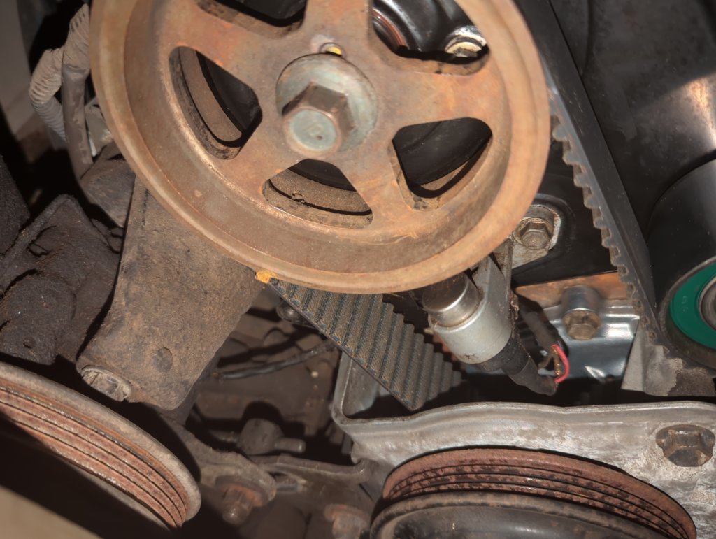

    So I was cranking it to start and it would not fire. Then it acted like the motor froze. Could not turn by hand and the ground wire to the battery got super hot. Turns out it was the starter that froze. I pulled a starter out of another 5vz and it spins fine but the sprog doesn't shoot forward. So I will be picking up a starter tomorrow. In the meantime I've been reading up on crank/no starts. They seem to be the most challenging repair to diagnose. One thing I notice when doing the timing belt was that the cam timing sensor has three wires at the sensor and the black wire disappears into frazzle at the connector.
    Is this a ground that it needs to read a signal or will cause any issues being broken?
    In the picture you can see three wires coming out of the sensor and at the end of the wire protector there is a frayed wire hiding the other two...I checked my donor truck in the yard and its the same way. Is this common?

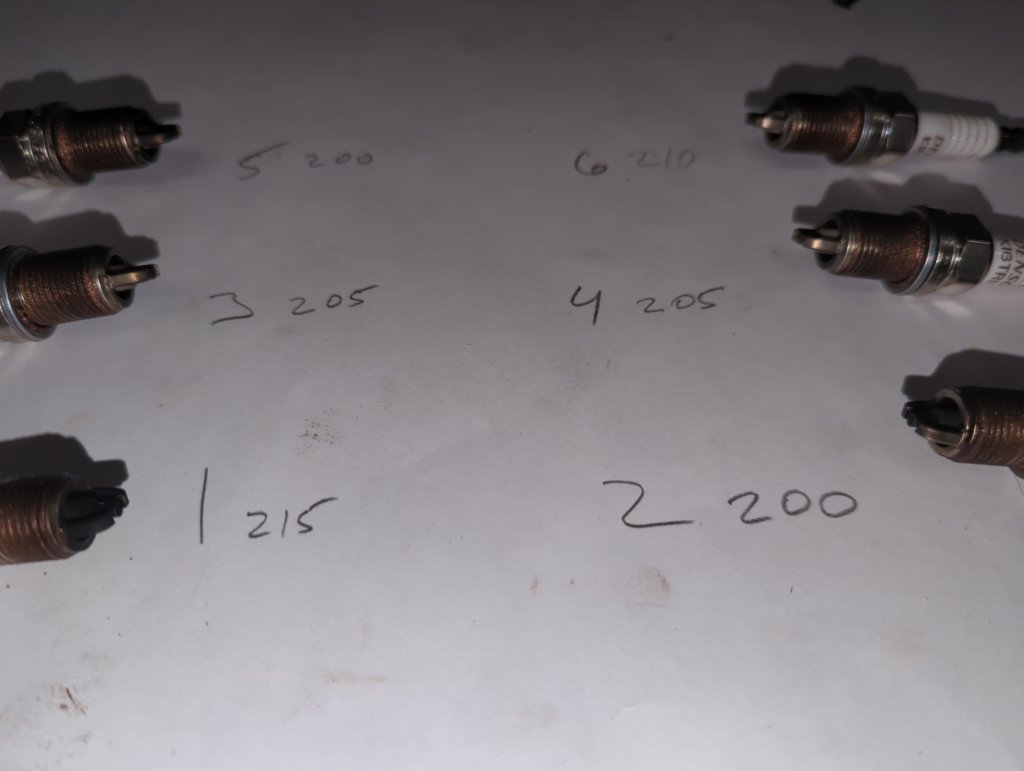

    I ran a compression test this evening. A few plugs are spotless like they aren't firing and one was absolutely filthy with only 5-10 minutes run time. Very happy with the numbers considering the shape of the rest of the truck. Now to figure out why I have a couple dead holes.
