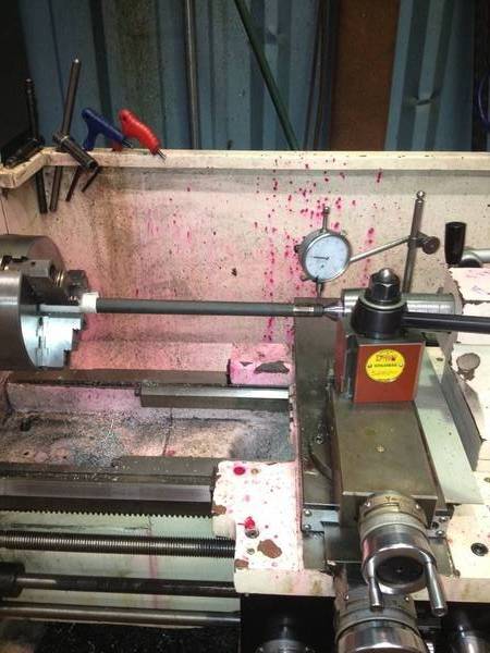

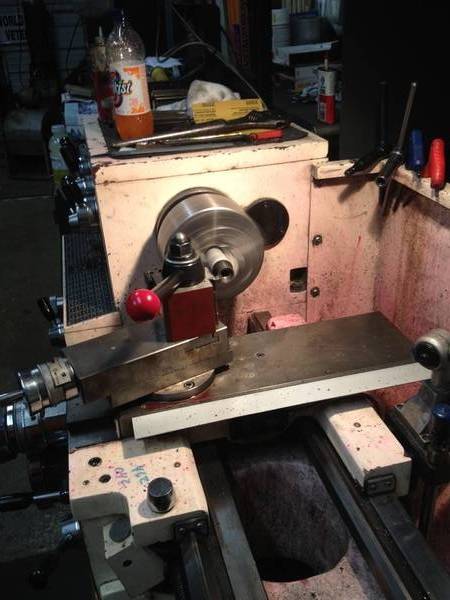

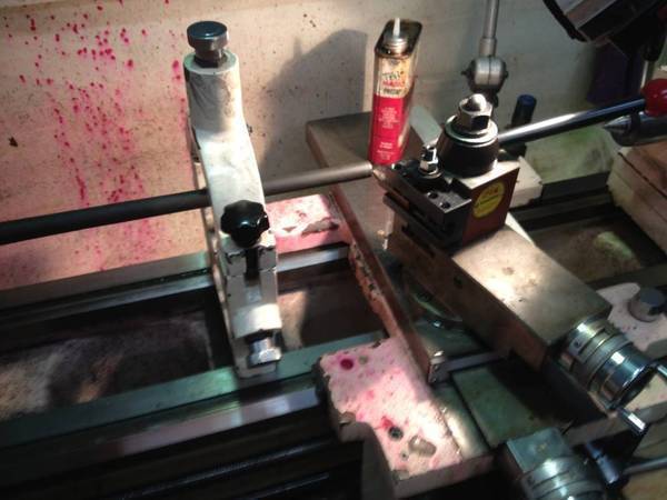

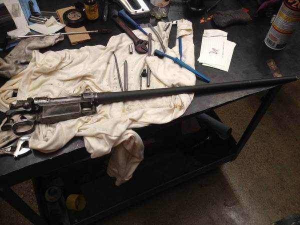

    today my dad and i started the process. we cut the barrel down to 22 inches and put a crown on the barrell. we also had to trim the ramp the helps the bullet into barrell so it would seat into the action.
    here we are getting ready to cut the barrell down
    putting the crown on the barrell
    trimming the ramp
    how it sits now (getting it sent off to get blued)
