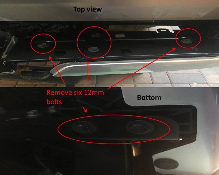

    Rear Bumper Removal Guide
    Tools:
    -12mm socket
    -Philip head screwdriver
    -Flat head screwdriver
    Time commitment: Between 15-25mins for removal and 10-20mins for install = 25-40mins total
    Step 1: Remove license plate

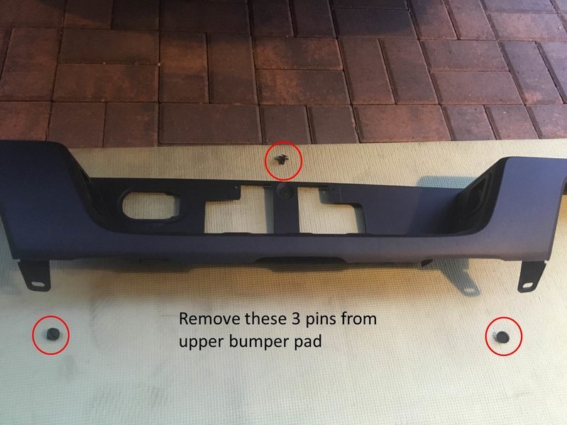

    Step 2: (2a) Depress the tabs for the trailer plug and license plate lights and pop them out of their sockets. (2b) Disconnect wiring harnesses for the trailer socket and license plate lights located behind the bumper. (2c) Remove the three push pins pushpins shown below
    Step 3: Two snap clips are visibe and can be easily seen from beneath. Hint-it's located towards the end of the bumper. Pick a side and gently start prying the snap clips using a long flat head screwdriver (or other prying device) to free them from their sockets. Patience is key here. Start slow and take your time. You do not want to rush or apply too much pressure (just enough to free the snap clips). Too much pressure will break the snap clips
    Step 4: Remove the six 12mm bolts shown below. Start with the upper bolts. Then remove the two bottom bolts
    Step 5: If you do not have sonar sensors, the rear bumper end caps should now be free. If you have the senors, carefully remove them
    Step 6: Remove the push pins and gator clamps shown below
    Step 7: The outer end caps should now be removed easily
    Reverse the steps above when reassembling. Remember to take your time. Do not rush doing this. Replacement endcaps are expensive. So take your time while doing this.

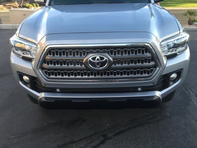

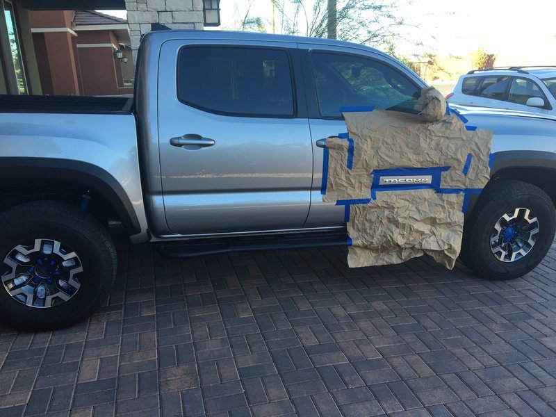

    dipped my wheels, grille, and emblems this weekend. Six base coats + four clear coats. Front grille was extremely easy to remove. Two 10mm (or philip screws) and two pop clips. To remove the chrome trim piece, you'll have to remove a few screws and push the tabs out. Removing the grille was easier and took less time when compared to taping. I love how my grille and emblems came out. You could still see two tones on the wheels. It'll do for now. Overall, I'm pleased with the results.
    Materials and PPE for this project:
    • 2" painters tape
    • Brown packaging paper (free from shipped items purchased online)
    • Six cans of Plastidip base coat, Dark Grey (used all 6 cans)
    • Four cans of Plastidip clear coat, Graphite Metalizer (1.5 cans leftover)
    • 3M Respirator and Eye protection
    DustStorm4x4 likes this.

    Wheels look great, FtApache. I have this exact same one. Noob question; did you dip the wheels with tires on or removed the tires?
  16. Apr 13, 2016 at 8:50 PM
    #36
    FtApache
    FtApache [OP] Well-Known Member
    Aug 10, 2015
    #161475
    826
    2019 Raptor
    @sparkyv, thanks for the compliment. What you see below is how I did it. I taped the lugnuts, valve stem, and covered the brakes with plastic trash bag. If I was to do it again, I would either insert index cards around the wheel separating it from the tire or cover the tire with tape. You can see the paint on the tires in the pic above, but that plastidip stuff should come off relative easy at the next car wash with a brush or powerwasher.

    I was going to do the grill on my silver TRD in black (what was Toyota thinking with all that chrome??!!), but the dark gray looks really nice. If I only did my grill ... not wheels or badges ... do you think it would still look good, or would that stand out too much as the only gray trim, since I'd still have with the black front bumper cap, flares etc? Though I'm also thinking of pulling the black B pillar tape. I already removed the TRD stickers, a huge improvement in my eyes.
