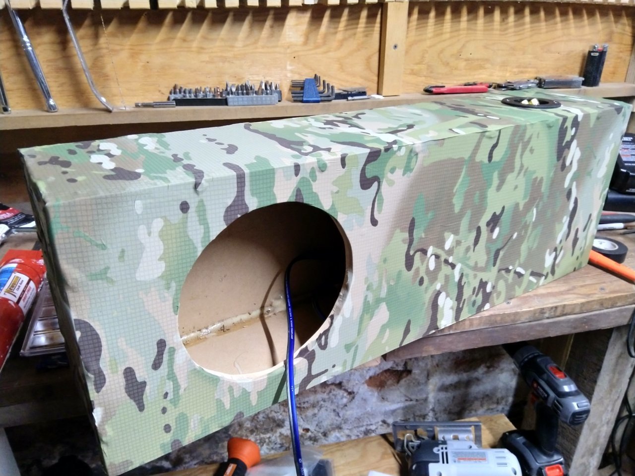

    **slight update**
    For those interested, my box is a simple rectangle measuring 29"x6"x10" (L/W/H) that fits behind the rear passenger-side seat (plastic storage bins removed). It tucks below the child safety restraint and runs to the metal 60/40 seat separator. My main objective was to maintain use of the restraints... seems like most boxes cover them up or require their removal.

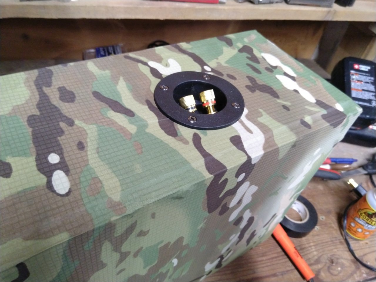

    Almost done. Just waiting for the subwoofer. Terminal cups installed today and wrapped in some OCP. Wanted to do something a little different than the usual gray carpet...not like anyone's going to see it though.
  5. Feb 23, 2019 at 11:54 AM
    stec06
    stec06 [OP] Well-Known Member
    Apr 15, 2018
    #250540
    198
    Terminal cups:
