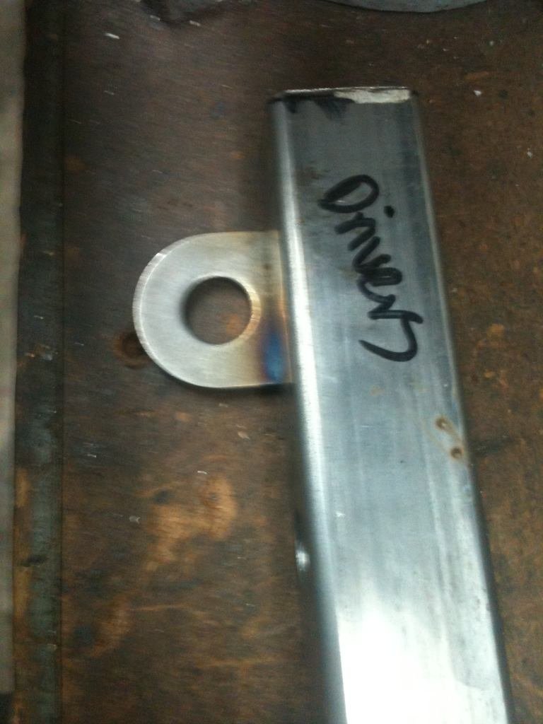

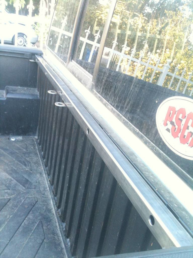

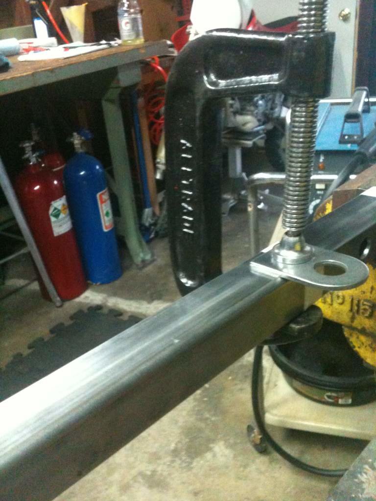

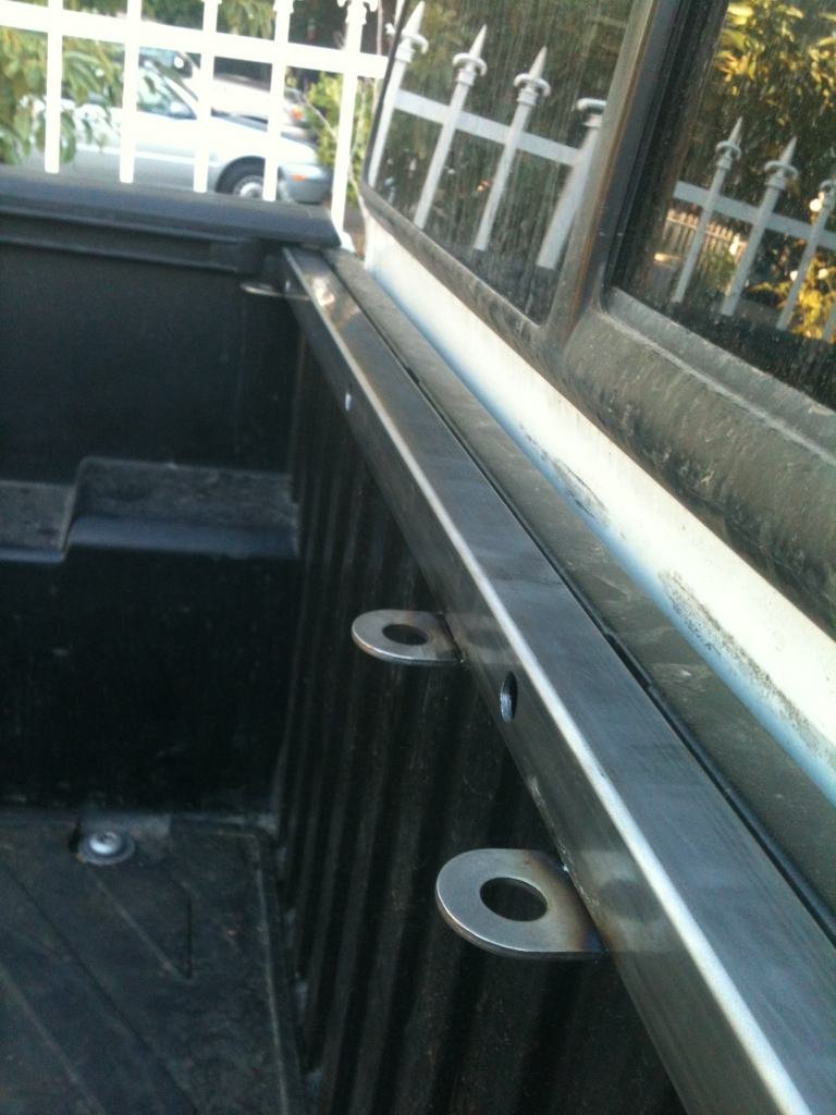

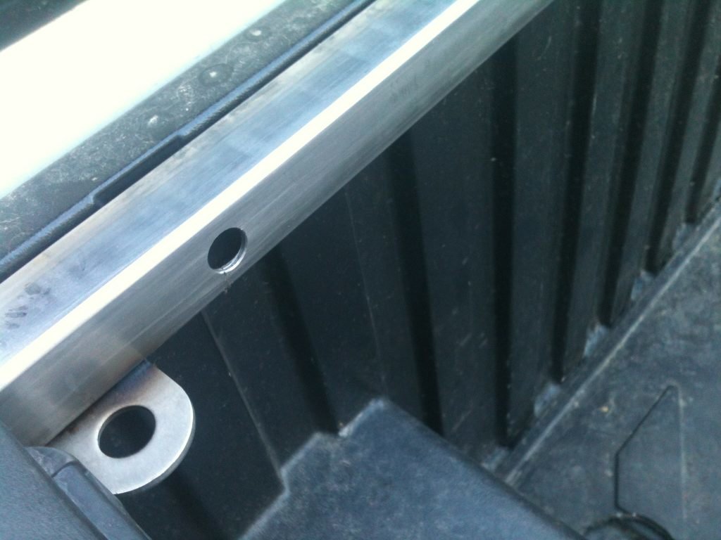

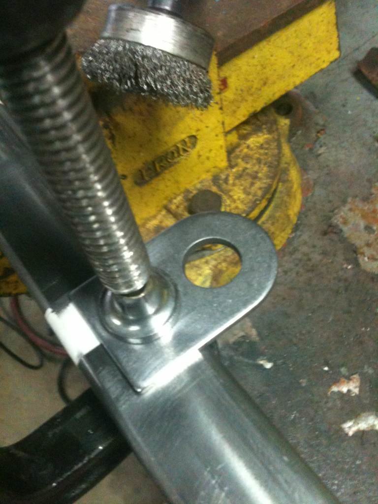

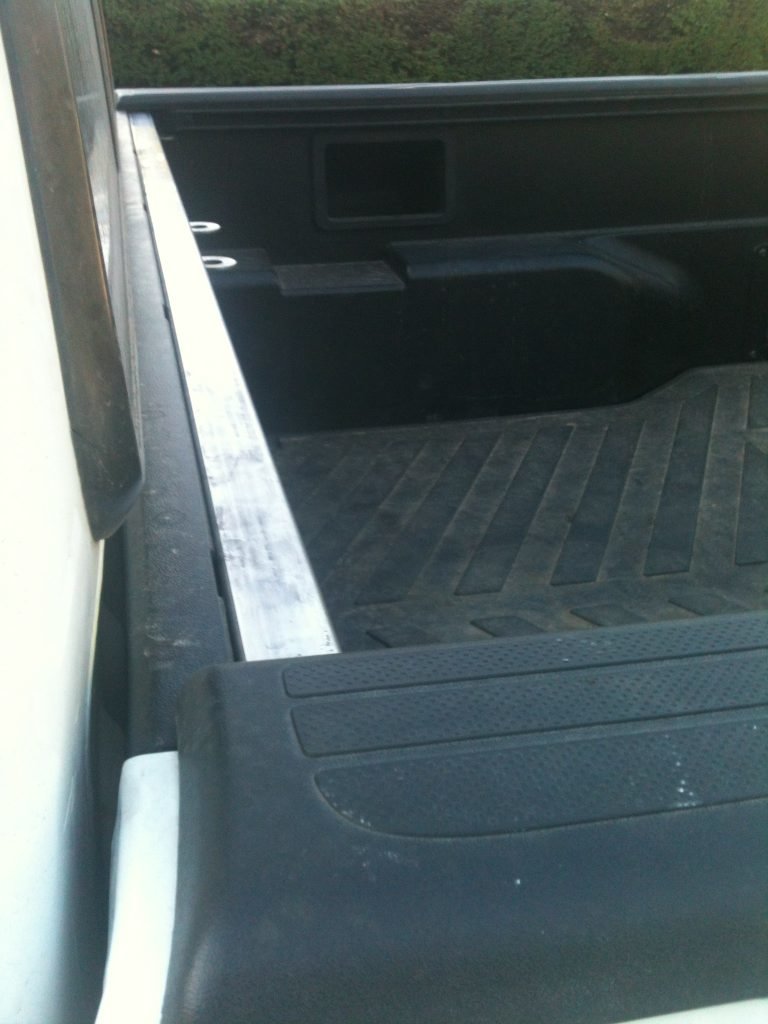

    Taking more than one dirt bike out was tricky even with the D rings moved to the front of the bed. I needed more attachment points for my tie downs so.
    1.25" square tubing and a few tabs later

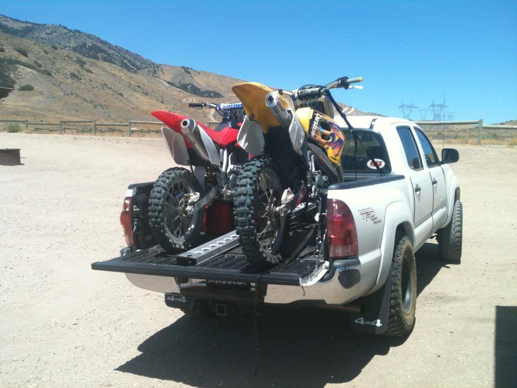

    Worked great at Gorman Today

    Thanks. I'm thinking of biulding a mount for my hi lift Jack onto it next

    Nice job, it looks solid. Where did you get the D rings? I put additional connections to the bed mount bolts and it is great for one bike but I don't trust the factory bed rail attachments for a second bike.

    I just swapped the original D rings from the back holes to the front holes. I bought the weld tabs from a chassis shop online to weld to the main bar. It holds 2 bikes perfectly now

    Just got a few chassis tabs in the mail today from A & A Manufacturing. Now I need to find the time to do it.

    I am guessing the tail gate holds up ok?
  14. Dec 11, 2012 at 4:57 PM
    Aw9d
    Aw9d That one guy
    Nov 7, 2011
    #66635
    19,326
    Yup. My 400+lb sport bike doesn't flex the tailgate at all.
  15. Dec 31, 2012 at 7:02 PM
    DAVE94LIGHTNING
    DAVE94LIGHTNING [OP] Well-Known Member
    Mar 30, 2011
    #54052
    184
    Tailgate holds up perfectly fine. I now have had my new CRF250r, my GF's YZ85 and my buddy's RM 125 tied down with no issues. All just using 2 tiedowns each and this bed bar uses the existing holes and Toyota hardware so no drilling is needed. I'm going to take the bar off, finish weld the tabs, brush it with my grinder and clear coat it :)
