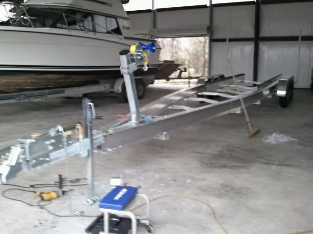

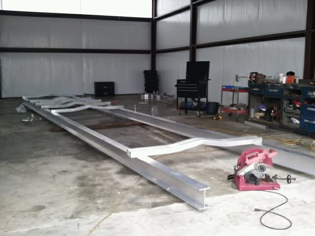

    Building a trailer for a 35' center console boat. Took about 6hrs and have about 3 more to go. We build custom aluminum trailers so if you're in need of one let me know...
    Start:
    35590_186190038060622_100000088813746_68_31112cf8d046b94bcbe9b429aac165497c03e164.jpg
    Almost done:
    166683_186280141384945_100000088813746_6_d2838a77b2e3e463970ef79b31cac046e8178f0c.jpg

    Its all bolt together with stainless steel hardware

    Sold this one for $6K :D Its a triple torsion axle, 20k pound tounge, huge hubs with built on rotors (not slip on). Kind of pricey but he wanted it built special... normally are no where near that.

    And forgot to mention 35' long 10" I beams. HEAVY Mothers!!!!

    did you have to cut reliefs in the i beams to bend them?

    Ran $1100.00 for the pair.

    No we started by bolting the front axle, and the rear crossmember on. Then ratchet strapped the front and worked our way forward while tightening the straps... First one I built that way, but was a pretty cool way to do it. Just couldn't go to the front unless you were standing in the middle
