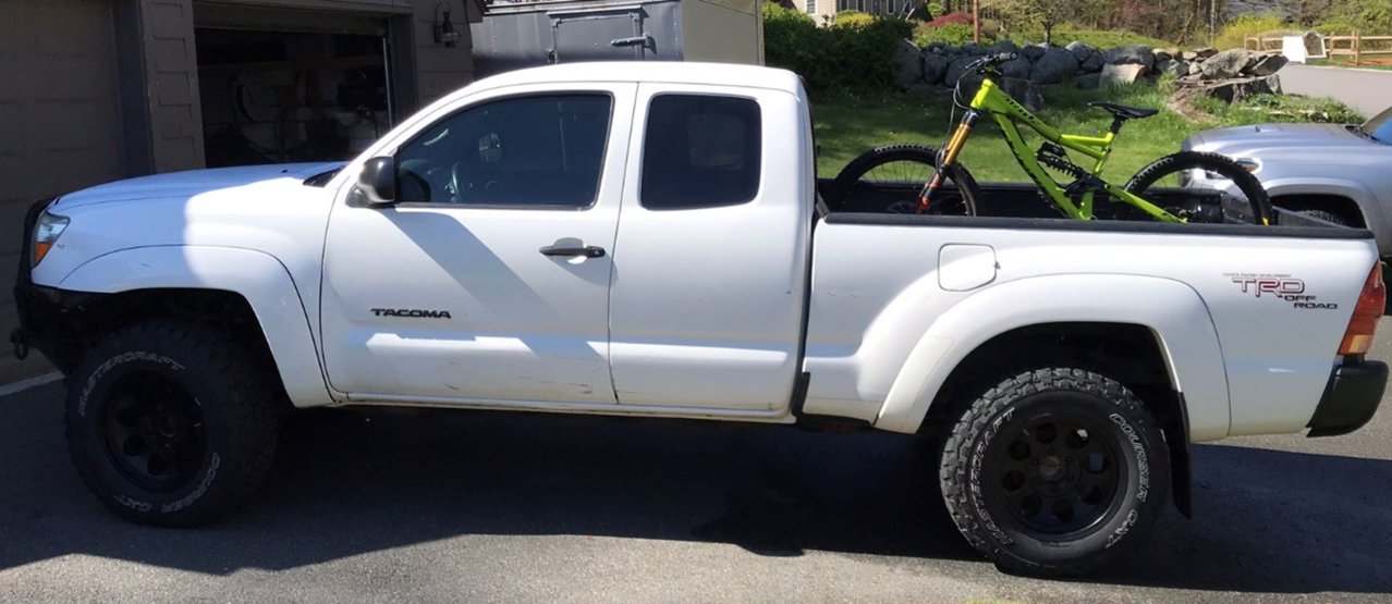

    Yes, I am 14 years old and I convinced my dad to let me buy a Tacoma to work on that will be my DD once I get my license. I have been saving for a long time for a truck and my dad offered to match anything that I made or saved.
    After a long search, we bought this 2008 Access Cab 4WD TRD Off Road.
    We got it pretty cheap because the owner had missed the frame recall and it had a few areas that were rotten though. Mileage was not bad at 130,000 and it had a manual transmission, which I wanted. It also included alot of extras that I figured I could sell to bring down the cost even more (wheels and tires, soft topper, BAMF sliders, BAMF Front Bumper).

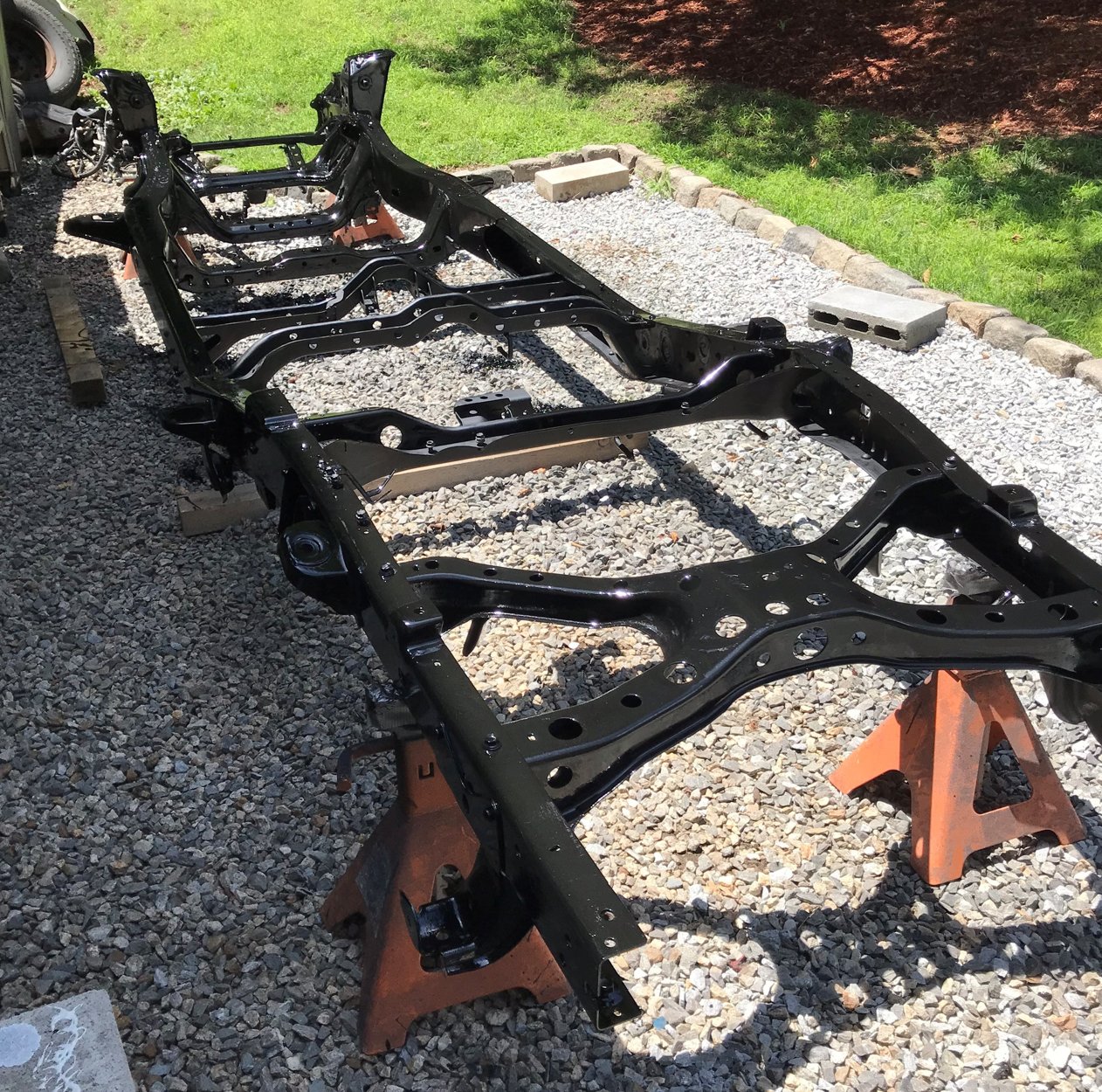

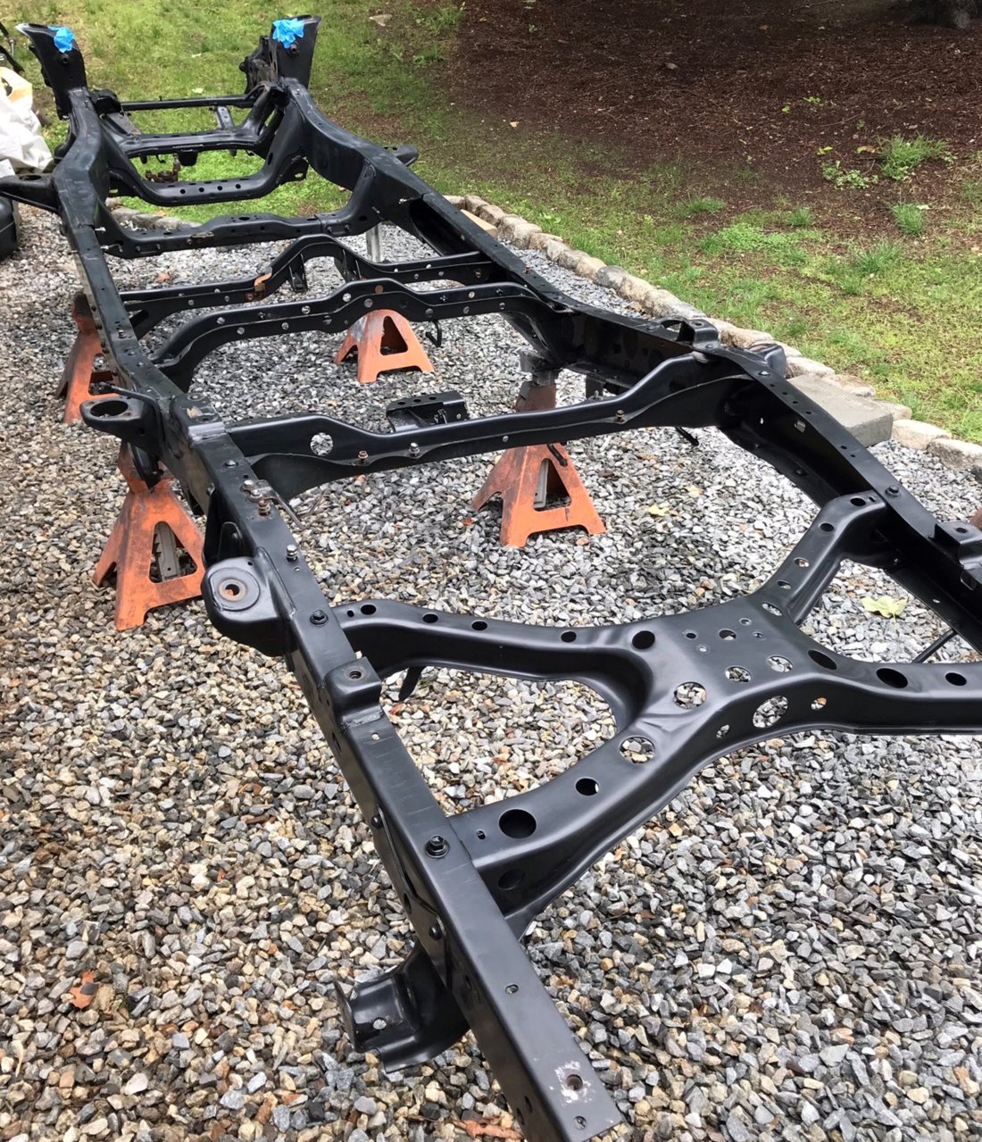

    Thanks. I am looking forward to turning it into a great truck. We have already sold the wheels and tires, the softopper and the factory front bumper. The frame isn't that bad and we were going to repair it, but then this brand new frame popped up local.
    It was a still a roller, with front and rear diffs and suspension when we got it. The story is that this truck just got its frame replaced, then had an interior fire. This guy bought it and parted out everything else, then just wanted this out of his yard, so the price was pretty good. We already sold the rear axle from it and still have almost new leaf springs, front diff, and front suspension to sell.
    Here it is with a fresh coat of POR-15:
    Only issue is that this is from a double cab. We took very careful measurements of our frame with a plumb bob before buying this and we think the only differences are the rear cab mounts and the front bed mounts. The plan is to cut them off of our frame and move them over. They are discontinued from toyota.

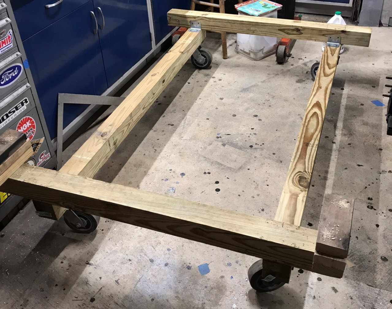

    We made this dolly for the cab to ride on while it is off.

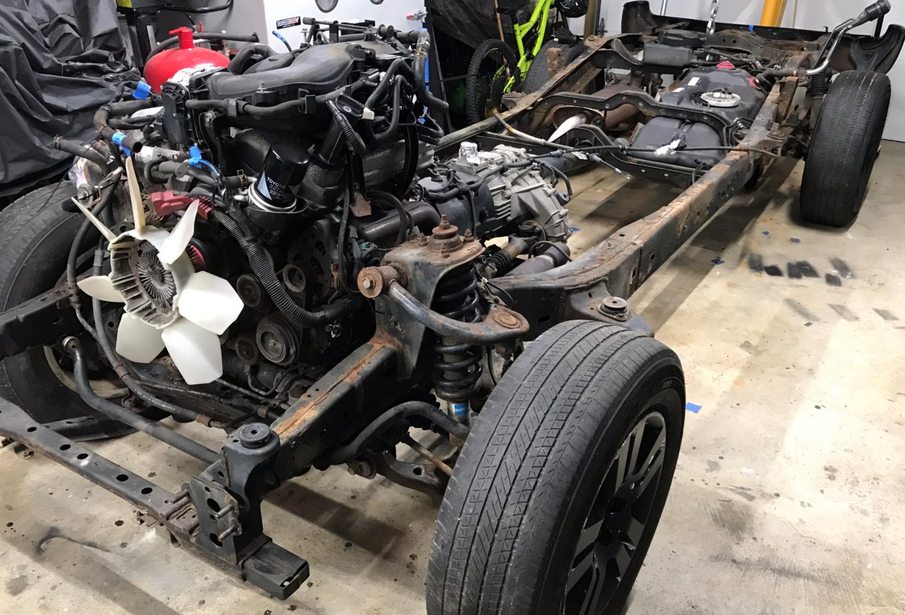

    And here is the rolling chassis:

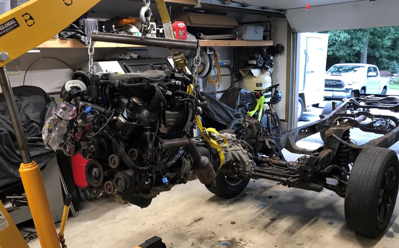

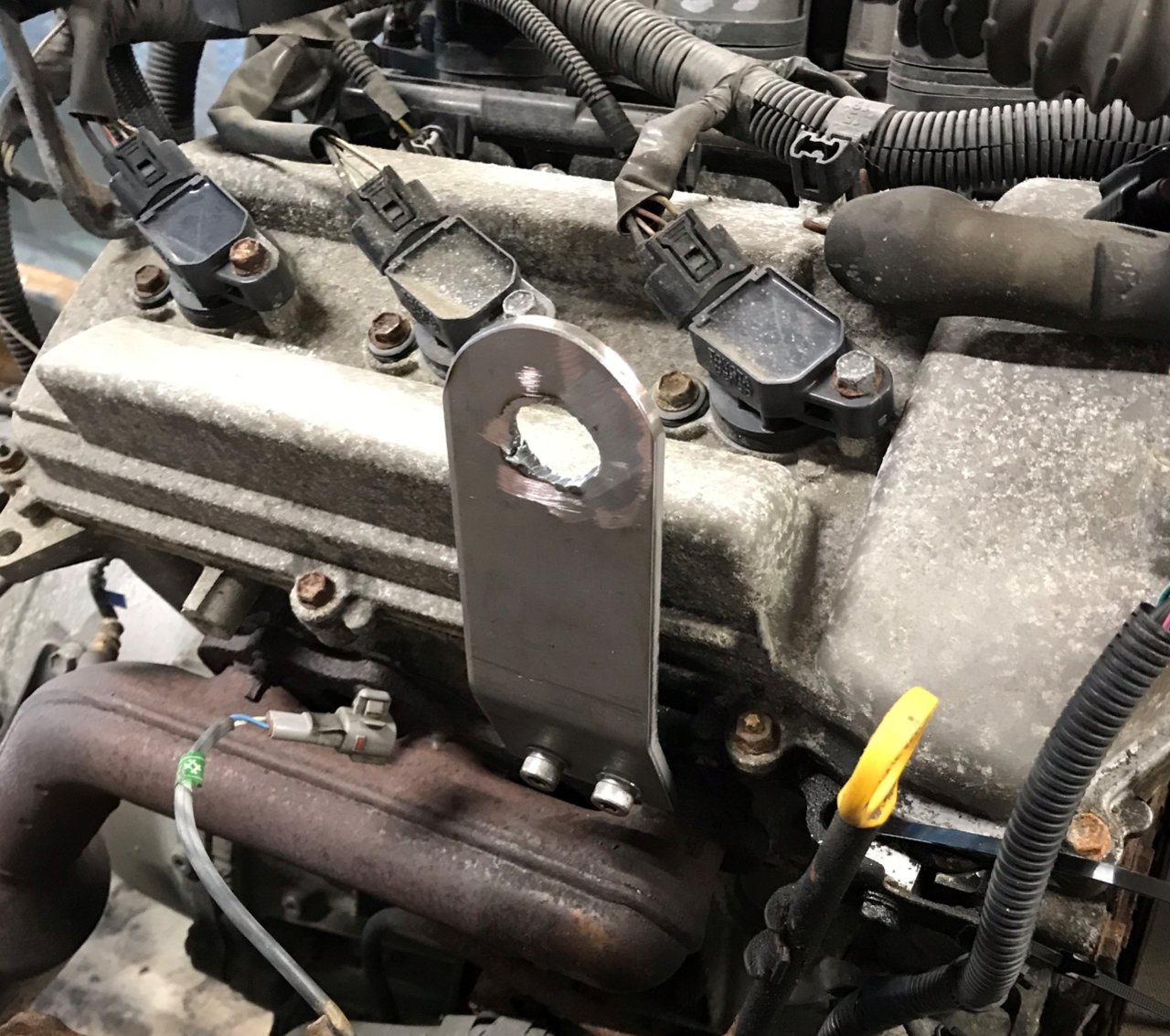

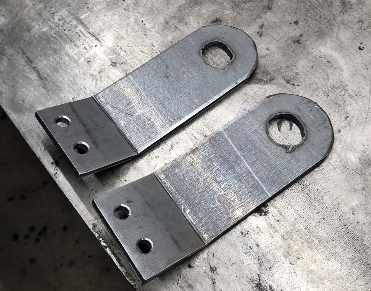

    We made these engine lift plates instead of buying the toyota ones to save money:
    The bolt onto each side of the engine for lifting:
    We lifted out the engine and transmission together with a home made spreader bar so that we were not putting side load into the lift plates:

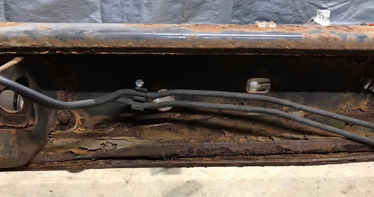

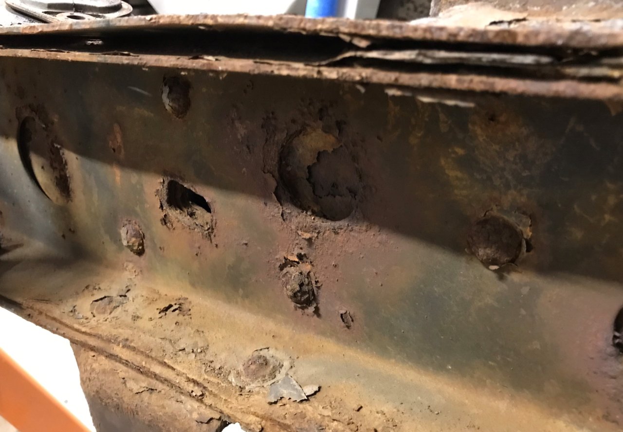

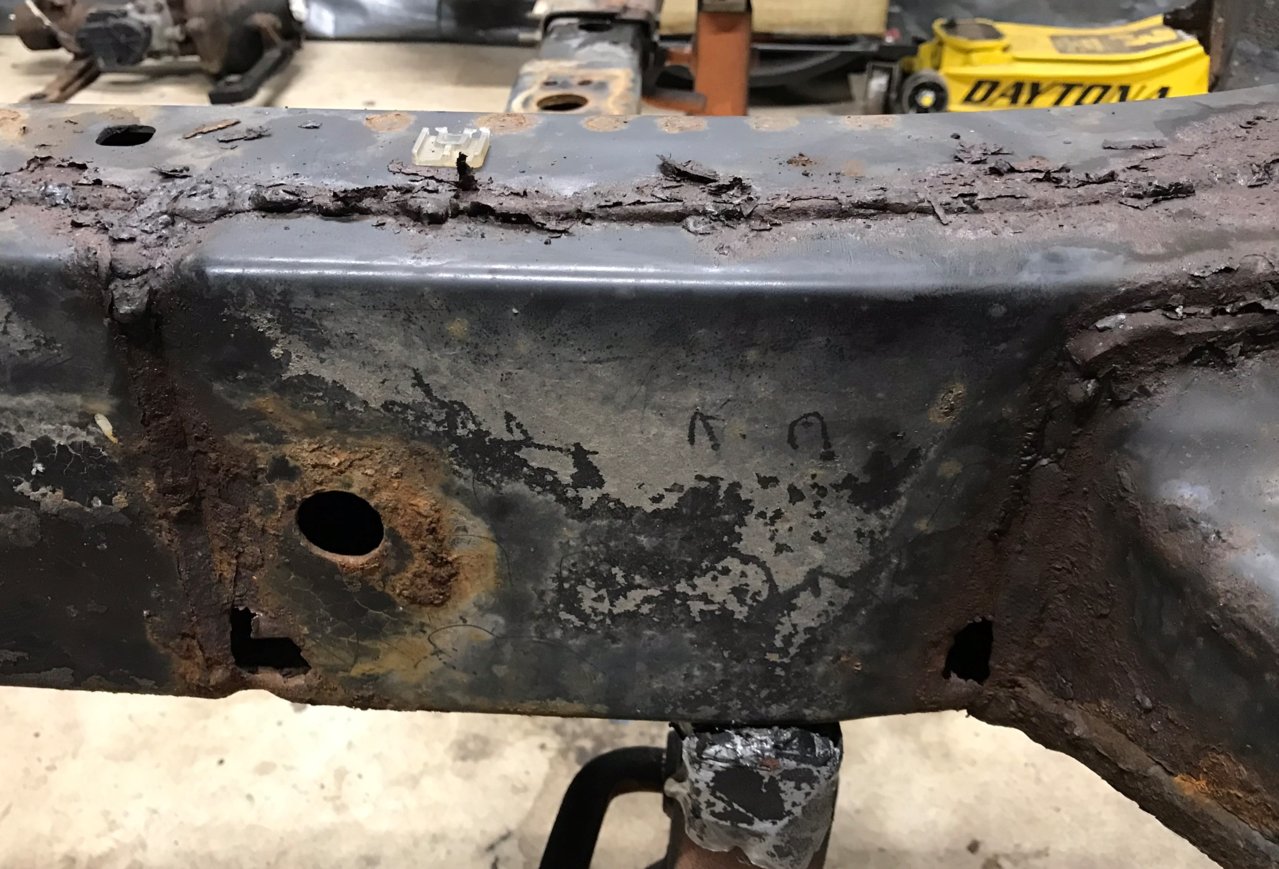

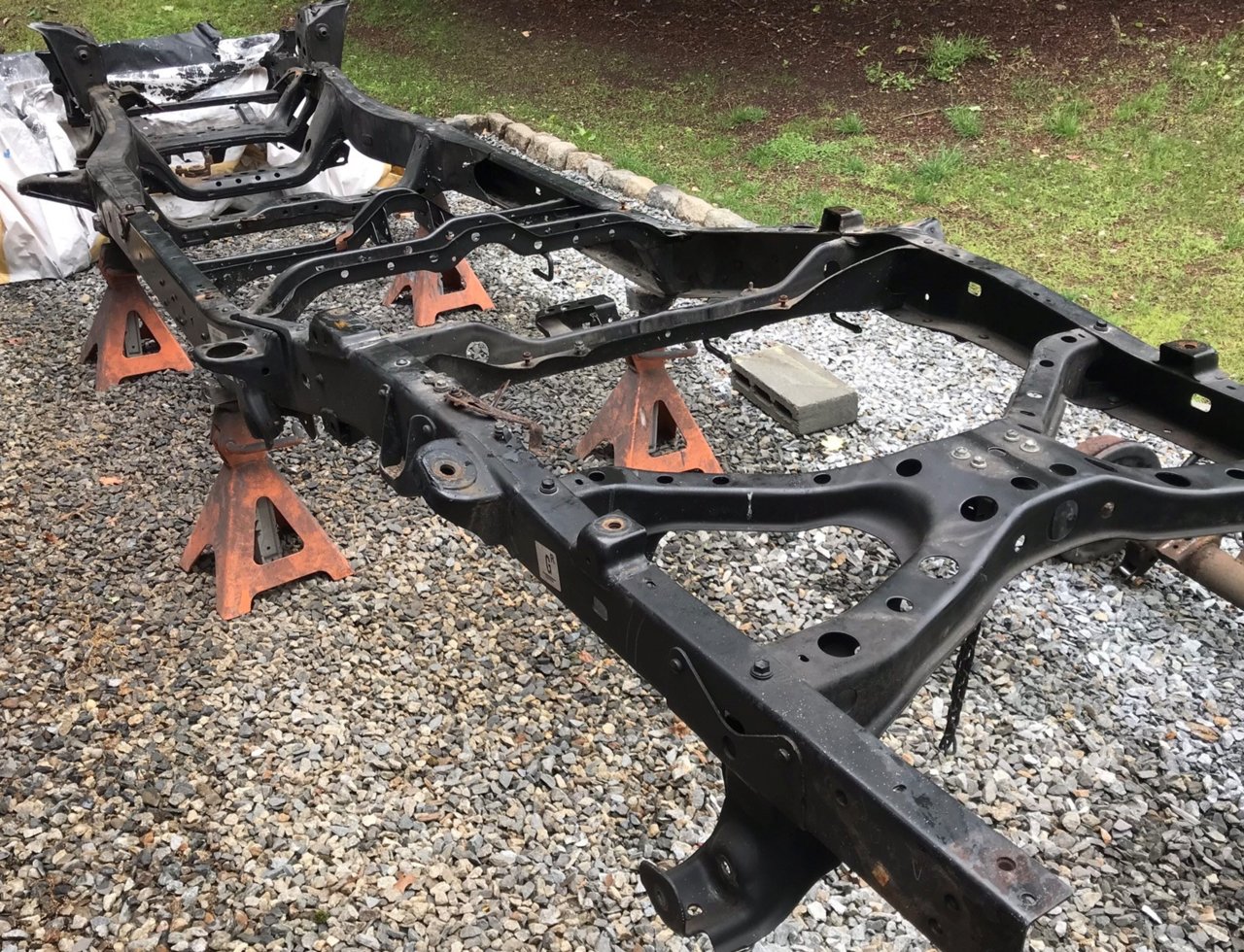

    Here is some of the rust, not too bad, but since the new frame was available, we are replacing this one:
